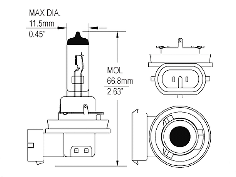

Replacement headlight bulbs - I see the Sylvania H11 LEDs that say "for fog light or powersports only" Is that true, have people run them as low beams? Otherwise i was thinking of ZXE's. Same question for the 9005 high beams.

Using these traditional IncandescentHalogen headlamps here in a 2008 Edge with acceptable results:
* For Both LoBeams+Fogs using Type H11.White.55w \ Philips#12362LL or Equal
* For HiBeams using Type HB3.9005.Blue.100w\ ICBE or Equal
WIth very few exceptions personal preference is to stick with Incandescent instead LED Bulbs for critical items like HeadLamps,
considering amount of bad\overcomplicated\unreliable\expensive LED product that's being made\overhyped\sold.
