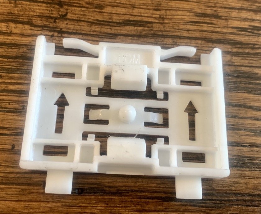

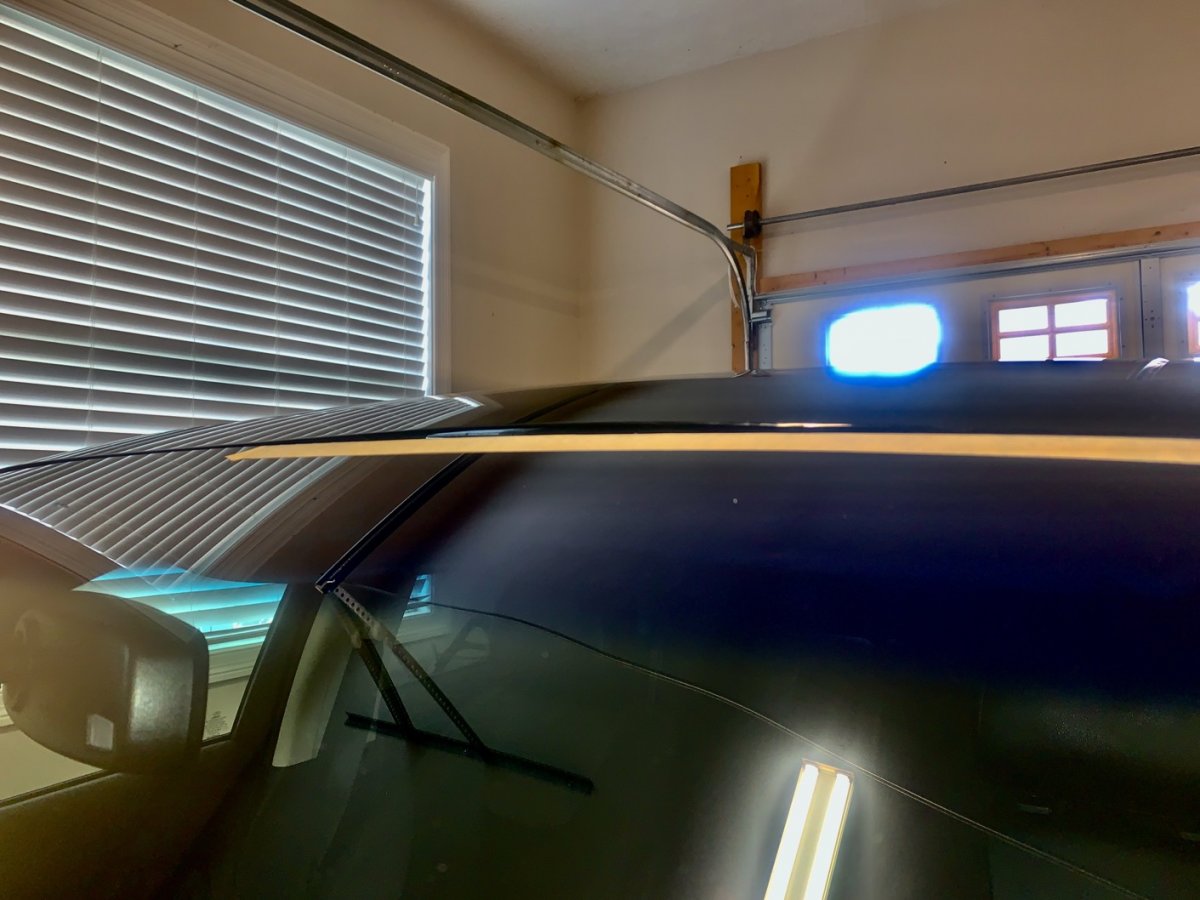

1004ron Posted June 21, 2023 Author Report Share Posted June 21, 2023 (edited) The wipers are removed to lift the plastic trim that runs across the top edge of the bulkhead. I don't see any body damage. For today's install I cannot find any fault with the glass, but notice that the plastic trim between the top edge of the windshield and the moon roof was raised in one spot - I lifted it slightly and could see one of the white nylon clips is loose and obviously not letting the trim go down all the way. I'm going to do a search to see how to lift that trim piece and correct the one clip - will go through the files @Haz posted. Edit: I can't see why they would need to lift this trim piece. Tomorrow's a bike day, so will take it through the car wash on Friday and if its leak free I'm done with Safelite - if there's an issue I'll be in touch with my insurance to see how I can get this job done by another supplier. I do not recommend Safelite. Edited June 21, 2023 by 1004ron Quote Link to comment Share on other sites More sharing options...
1004ron Posted June 21, 2023 Author Report Share Posted June 21, 2023 @Haz please help with a guide to removed the plastic trim mentioned above. Quote Link to comment Share on other sites More sharing options...
1004ron Posted June 21, 2023 Author Report Share Posted June 21, 2023 I was able to fish the loose clip out from under the trim and now the trim's curvature matches the windshield. 1 Quote Link to comment Share on other sites More sharing options...
