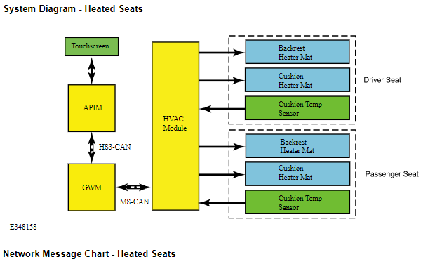

System Operation and Component Description
  HVAC Module Network Input Messages
Broadcast Message Originating Module Message Purpose
Heated seat request  APIM The heated seat request message allows the HVAC module to activate the heated seat(s) selected.
  APIM Network Input Messages
Heated seat request HVAC Module The HVAC module provides this message to the APIM for the purpose of updating the displayed status of the heated seat buttons on the touchscreen.
System Diagram - Climate Controlled Seats
imagen2.dll?id=E352021_EN&w=580&t=JPG
Network Message Chart - Climate Controlled Seats
  SCME Network Input Messages
Climate control requests  APIM The climate control requests message contains the climate controlled seat request information.
Heated Seat Operation
The driver and passenger heated seat buttons are selected from the touchscreen. The heated seat system functions independently of the vehicle's climate control system. Each time the heated seat button is pressed, the system decreases one setting (the sequence is high, med, low, off, high, etc.).
When activated, the HVAC module supplies voltage to the selected seat heater circuit. Each seat cushion heater mat and backrest heater mat is connected in a series circuit to the HVAC module and powered by the output circuit for that seat. The HVAC module monitors inputs from a temperature sensor located in each seat cushion heater mat, and maintains seat temperature by cycling the heater circuits on/off. The heated seat remains ON until the heated seat switch button is pressed to cycle the system OFF or the ignition is set to OFF.
If a fault is detected by the HVAC module, the module stops supplying voltage to that individual left or right seat that the fault was detected on until the ignition is turned OFF and then ON.
