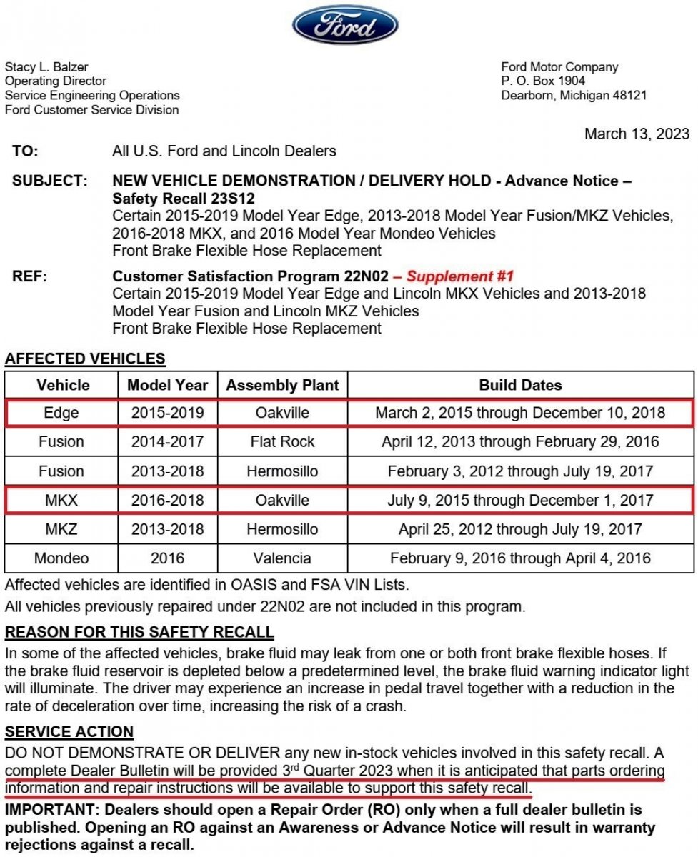

Haz Posted March 17, 2023 Report Share Posted March 17, 2023 (edited) Ford has issued this Advance Notice to Dealers about the upcoming Safety Recall 23S12 affecting certain Edge & MKX vehicles, and other models, shown below. While the supplier base scales up production of uniquely identified replacement parts in sufficient number to equitably address the large population of vehicles involved, this Safety Recall is not actionable, that is, dealers have been directed to wait until the complete Dealer Bulletin with parts-ordering information is provided to them in the third quarter of 2023. Until this full replacement of front brake hoses -- regardless of their condition -- on the described vehicles begins, owners whose vehicles suffer front brake hose leakage or failure continue to have available to them Customer Satisfaction Program 22N02 (link to prior post) to provide a one-time no cost repair of any faulty original front brake hose. You may notice that vehicles repaired under CSP 22N02 are not included in this Safety Recall 23S12 field service action. I will update this post when the complete Notice To Dealers letter is released, likely in third quarter 2023. Good luck! Edited March 17, 2023 by Haz 3 Quote Link to comment Share on other sites More sharing options...
