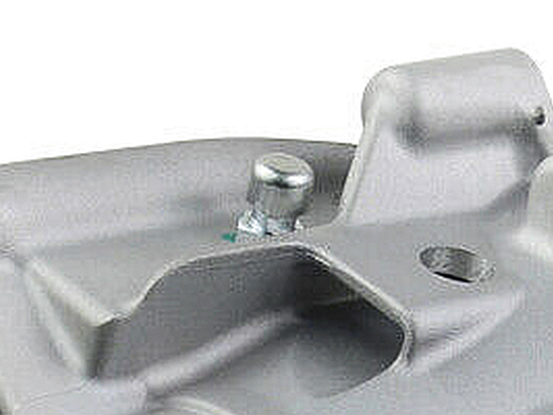

* Black\Blue GearOil boiling out of TopVent; goo mess all around PTU, drips down onto hot exhaust wye, makes a sort of sour propane stench.

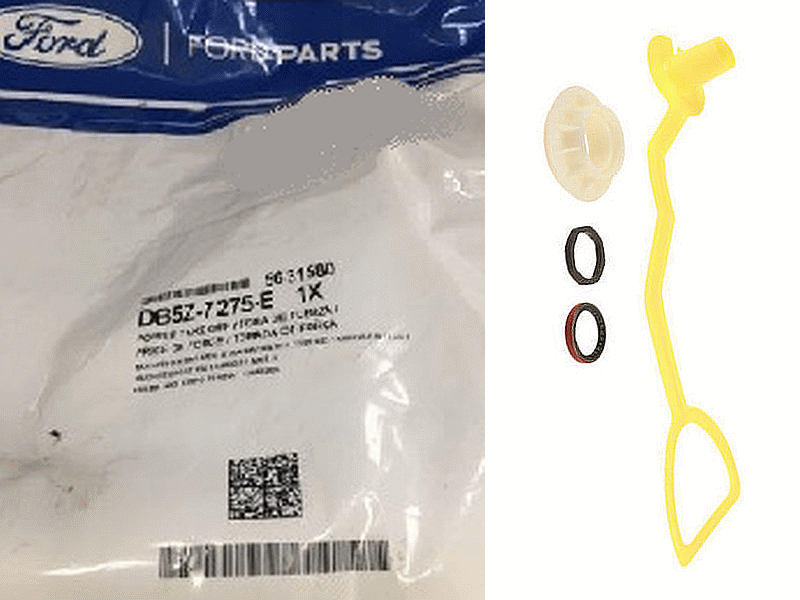

the fix is relatively easy with SealKit FordMotorCraft# db5z-7275-e

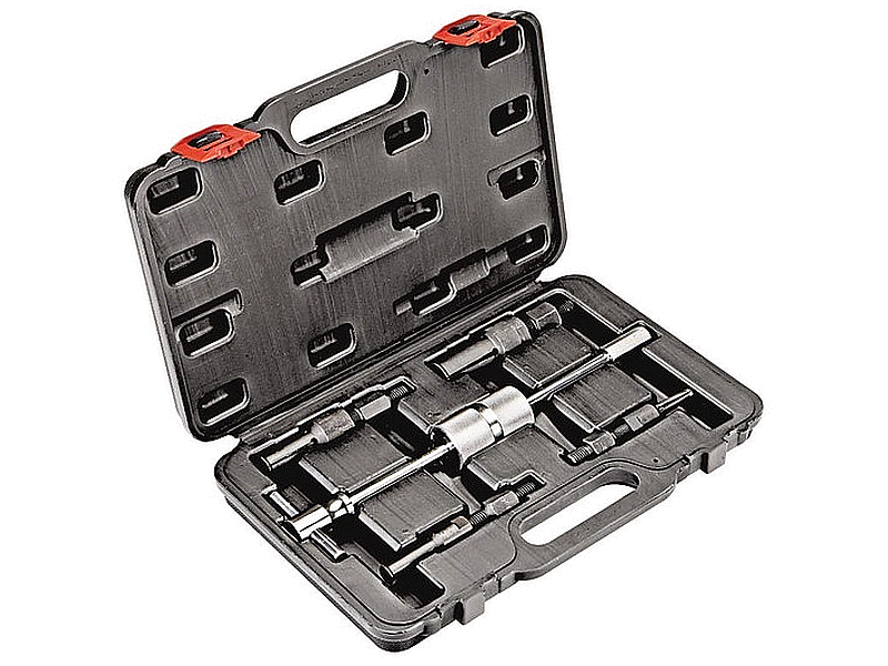

& a SealRemove+InstallTool like HarborFreight\Pittsburgh# 62601.

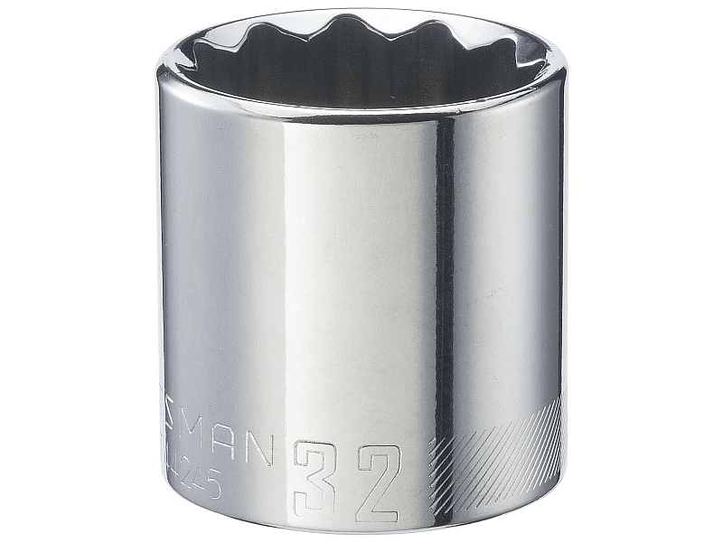

use 32mmSocket+Extension to seat Seal+OuterCover, expensive\awkward special tool not needed;

If you have the PTU TopVent GearOil leak,
your PTU likely already has bearing damage due to lack of lube+overheating, will fail sooner than later & need replacing.

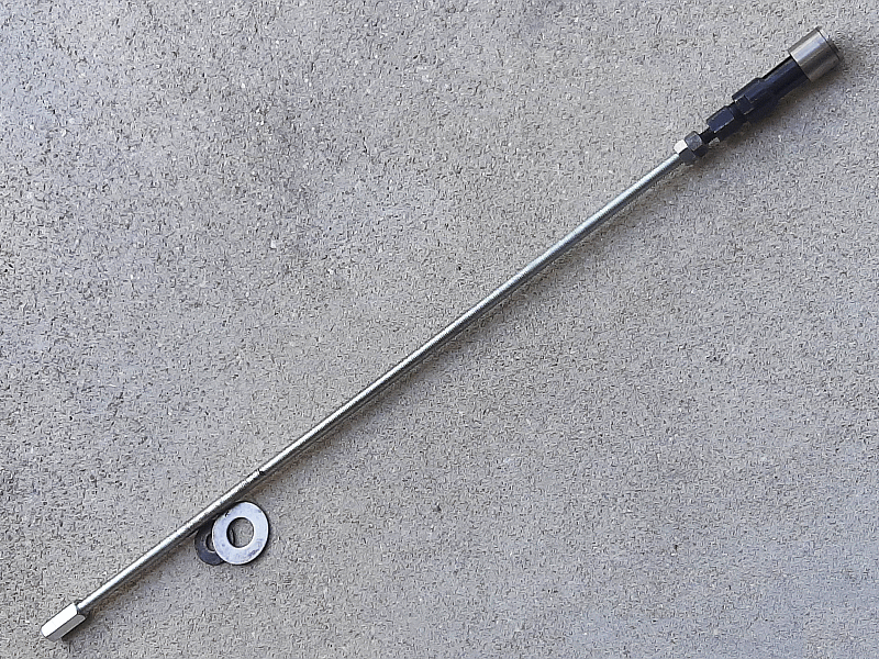

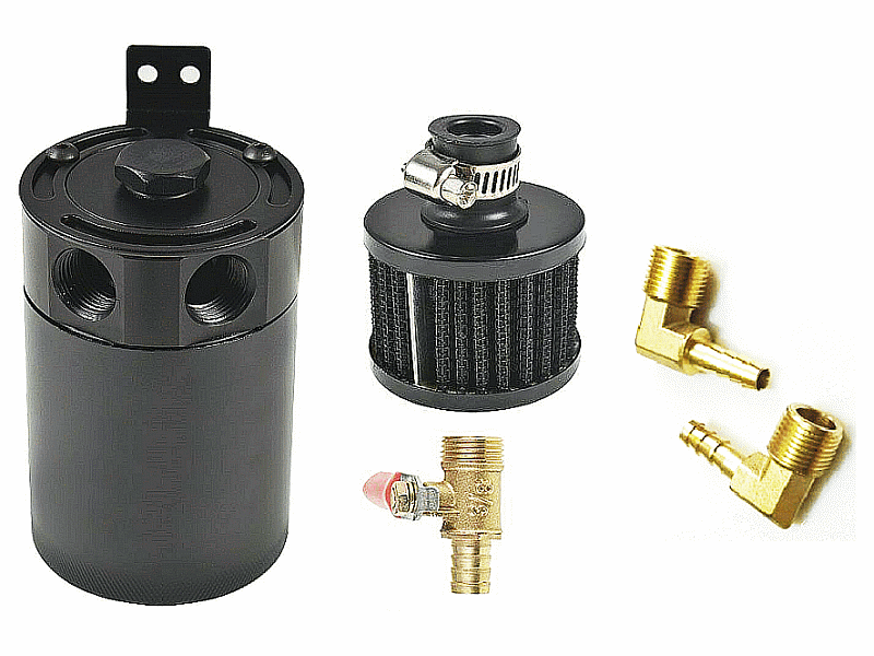

Also recommend Drilling+Tapping the PTU for a BottomDrain & adding a FumotoDrainValve,
removing the TopVentCap+1WayPlug & adding a VentHose upto under the Hood,
removing the SideFillPlug & replacing with a 90DegreeElbow & adding a FillHose upto under the Hood,
installing a combo VentFIlter+FillCan under the Hood with the above 2 Hoses attached;
this allows much easier PTU GearOil changes.
