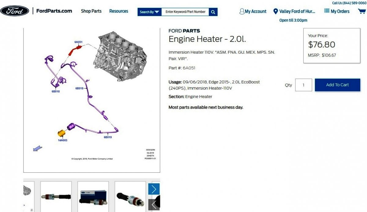

Link to 2.0L EcoBoost Engine Block Heater on Ford's online parts website...
591030644_EngineHeater-20192.0LEcoBoost-FordParts.thumb.jpg.07df9ed9b653b4af012612dbe62fec1d.jpg
