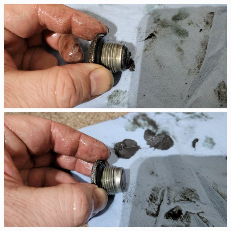

lildisco Posted February 20, 2023 Author Report Share Posted February 20, 2023 Seeing how the fluid goes in light brown & comes out black or gray is enough for me to swap it out. Not to mention the shavings caught on each plug. 1 Quote Link to comment Share on other sites More sharing options...

lildisco Posted February 25, 2023 Author Report Share Posted February 25, 2023 RDU done. Fluid wasn't terrible, but there was a lot of junk on the drain plug 2 Quote Link to comment Share on other sites More sharing options...

lildisco Posted July 13, 2024 Author Report Share Posted July 13, 2024 (edited) Nearly 13,000 (12,726) mile update. Fluid came out a nice light brown color. Magnet had some dark material on it (which still could have been leftovers from the first drain & fill), but the fluid wasn't nearly has nasty as the 1st time. I did by a cheap Amazon special nearly flat 3/8 wrench that made the job much easier. It was $10 so wasn't too bad. Cleaned off both plugs & refilled. Still had some left from the 1st time I did it as well as a full fresh quart. Nearly took all of the fresh quart, but she's clean & ready to go. I saw on the Maverick forums that they were changing theirs every 5,000 miles, which seems to be extreme, but maybe they haul more than me? Dunno. 'Cheap' insurance at ~$40 quart & 30 minutes of your time. Edited July 13, 2024 by lildisco 2 Quote Link to comment Share on other sites More sharing options...
