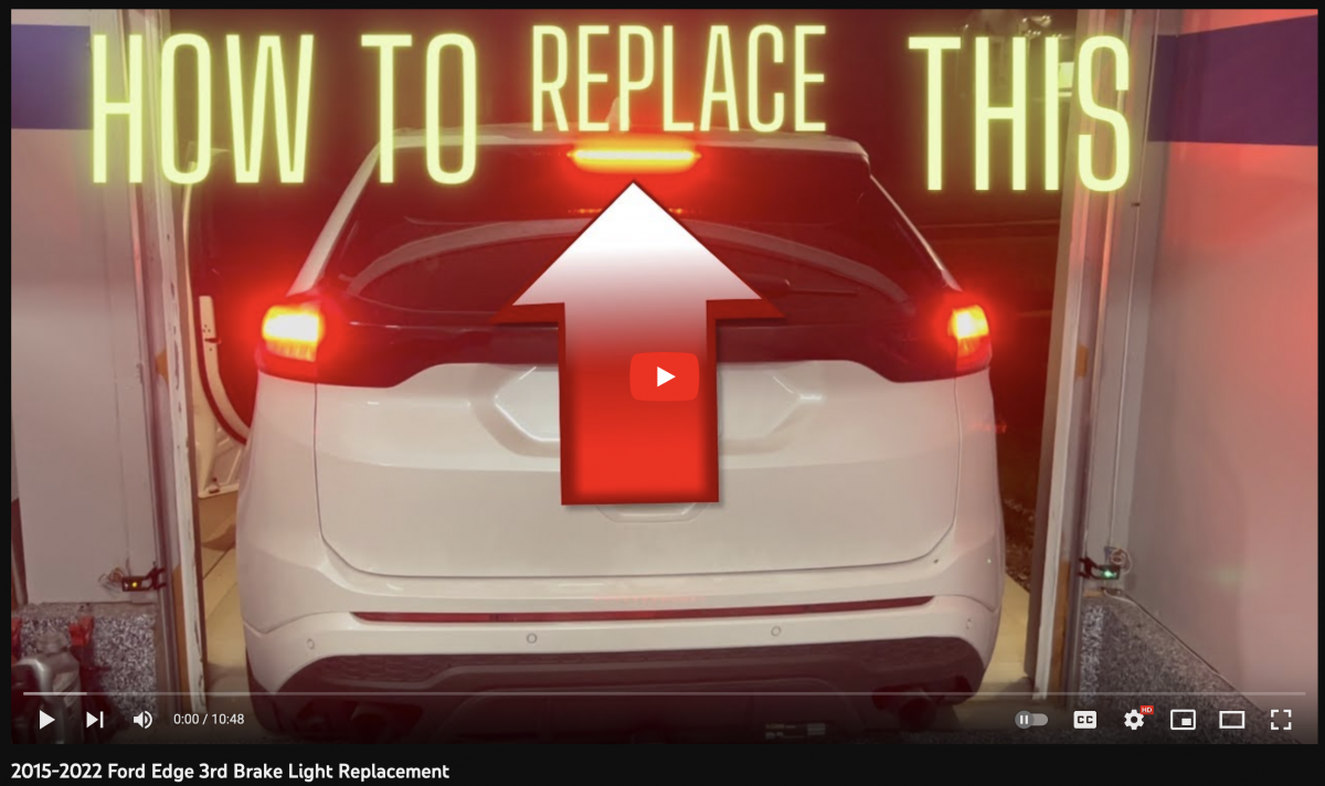

1004ron Posted February 9, 2023 Report Share Posted February 9, 2023 (edited) https://www.youtube.com/watch?v=kUtyYU15Fk4 Edited February 9, 2023 by 1004ron 1 Quote Link to comment Share on other sites More sharing options...

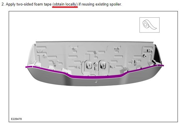

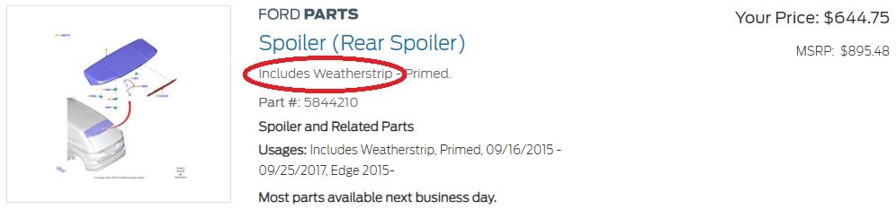

Haz Posted June 6, 2023 Report Share Posted June 6, 2023 Ford gives you a free Spoiler if you buy this 2017 double-sided tape/weatherstrip... The 2017 Edge Workshop Manual provides this advice on reinstalling a Spoiler... I expect the less elaborate contour of the GEN 1 spoiler causes its separately sold OEM tape/weatherstrip to be shorter than the GEN 2 Spoiler requires, but at slightly over $4 each, I'd be tempted to order-in two GEN 1 tapes and hope for a perfect overlapping splice cut, just to see if it worked out... Good luck! 1 Quote Link to comment Share on other sites More sharing options...
1004ron Posted June 13, 2023 Report Share Posted June 13, 2023 Received the Gen 1 seal today and its not suitable - its real narrow and adhesive on one side only. I got two seals - $16 incl postage. I might try this stuff on eBay. 2mm thick Size: 1” width x 50 feet long x 0.08” thickness https://www.ebay.com/itm/385653375215?hash=item59cabb80ef:g:cUMAAOSwy19keOMS&amdata=enc%3AAQAIAAAA4DEhuQlDKAbxIrwh7JZQdqagIdDb3leujxBFXVKr2ZF%2BUar2%2BzLKnAwMWidF9Zb4T55JqPqWbfyAXWOU9vAzCWLA0P0FOppJpmfxliPwS2lqAj4CUGb6UmGYUKQeYAGx6GlFI9dHrc8eaDDASHIiSZLrNYoOK66PlTk67thNusDWoZFUm0%2BFK7OOt5mRAd4Q7j9SgmuiYwkhG04JBcCnYSgvez4HFvGLnskRsawNPdlNm08RItgouR70iBe7YUe0LQFKEGm3QuBK58%2BNhxm3rvwUgw0u7NAcOnTuUuIe2nfw|tkp%3ABk9SR8bJx-uWYg I've stopped the rattle by prying it up a little and sliding in four pieces two inch long of the 3M mounting tape, but will redo the job when I find tape that I'm happy with. Quote Link to comment Share on other sites More sharing options...
1004ron Posted June 28, 2023 Report Share Posted June 28, 2023 This is the tape to buy. LLPT Double Sided Foam Tape 1 Inches x 50 Ft Durable Adhesive Weatherproof for Fill Gaps Attach Bond and Mount Uneven Or Textured Surfaces (T004A) 2 Quote Link to comment Share on other sites More sharing options...
