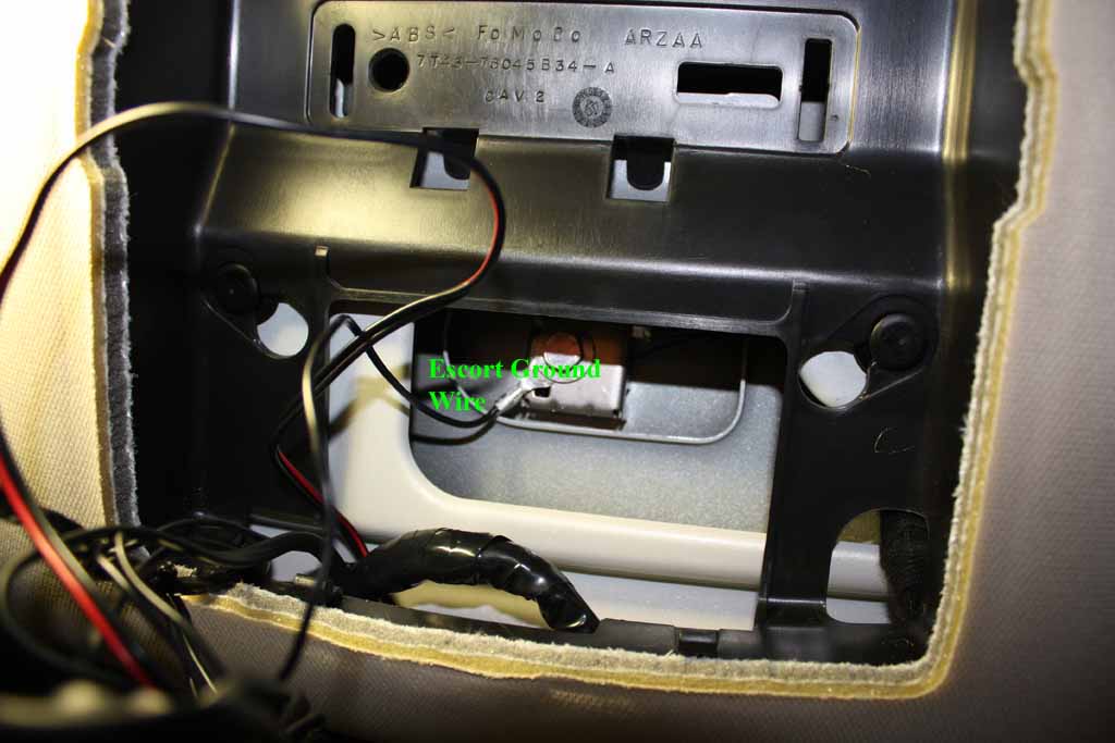

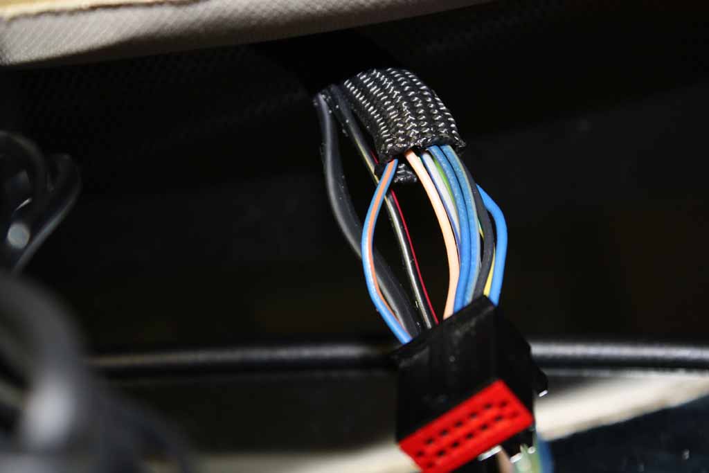

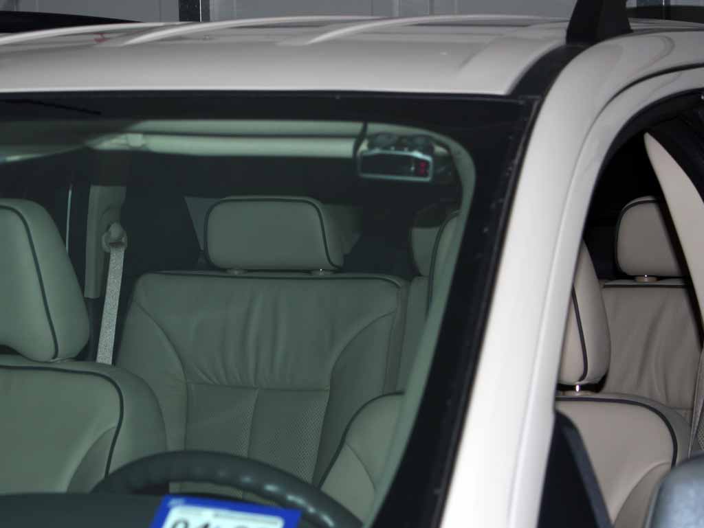

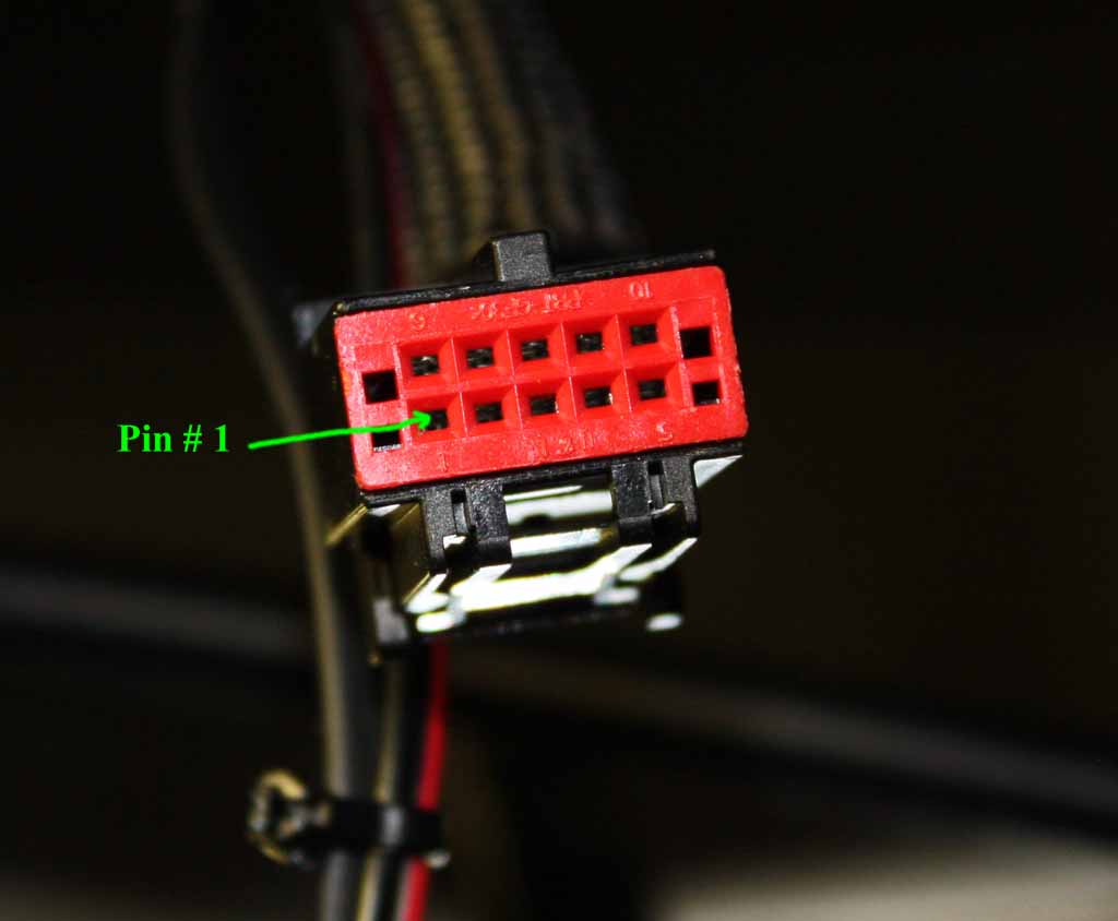

ablb Posted January 6, 2009 Report Share Posted January 6, 2009 (edited) Thanks for the advice, but I had actually done the search before I posted the question (not out of the question that I missed a post, but I did try searching beforehand). I came across one post where a guy had said he did this, and he advised using a multimeter to find which wires to use. I knew the multimeter was a sure way to find the wires, I was just wondering if someone would be able to say "the black/green wire is switched 12v" for example, so I wouldn't have to run to Radioshack for the multimeter. I was also thinking that if someone did respond, it would be here for the next guy looking to do this. When I do the wiring I'll be sure to return and post the details on which wires. Did you get it installed? I used the BLUE red wire on pin #1 on the plug for the mirror for switched power on our 08 MKX. Here are some pictures, we don't have the hole in the roof, so your may be a little differant. All the work was done in the over head console. ab Edited January 6, 2009 by ablb Quote Link to comment Share on other sites More sharing options...
steve f Posted January 9, 2009 Author Report Share Posted January 9, 2009 Did you get it installed? I used the BLUE red wire on pin #1 on the plug for the mirror for switched power on our 08 MKX. Here are some pictures, we don't have the hole in the roof, so your may be a little differant. All the work was done in the over head console. ab Thanks. I have not done the wiring yet. I had ordered a multi-meter which I needed to bias an amp, and I was going to use it to check the mirror wiring also, but your info is just what I was looking for. Quote Link to comment Share on other sites More sharing options...
