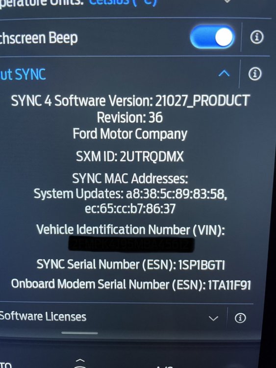

Jdw Posted January 22, 2023 Author Report Share Posted January 22, 2023 (edited) I hoping that it’s just a software issue and not some random electrical wiring issue…….. couldn’t agree more with the activex leather look material, my brother in law was convinced it was actual leather!!!……. Time will determine its wear performance …… coming from Chrysler products I’m really impressed with my Ford choice so far Updated status: at service Feb 01/22, for 6hrs, service rep stated that had to dump and reload sync system, I am now able to connect vehicle thru Ford app!! Hopefully everything is resolved. Could member confirm their sync 4 software info as per pic so I know I am up to date Thanks Edited February 4, 2023 by Jdw Updated info Quote Link to comment Share on other sites More sharing options...
