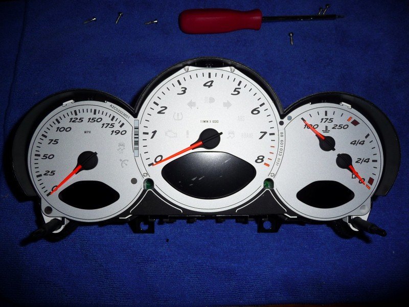

bofus Posted December 21, 2022 Report Share Posted December 21, 2022 I had "factory splatter" on one of my cars back in the day. I had to remove the entire cluster and separate the front plastic from the rest to get at it. I think the person putting the cluster together at the factory must have sneezed on it as it was sideways. No way could have it been done when in place. Yep...super annoying to look at. You can see the diagonal "drops" of something on the tach in the dark area. Cleaned up easily, just a pain to get to it. 1 Quote Link to comment Share on other sites More sharing options...
