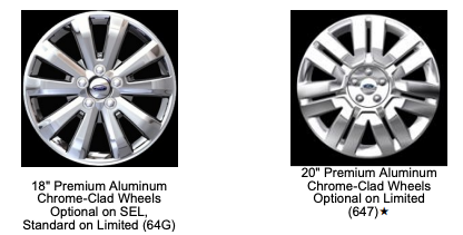

dabangsta Posted December 20, 2022 Report Share Posted December 20, 2022 Lets see if I can attach a small image from the order guide, your image is not showing up (first post thing like most boards?) These are the 2 offered wheels for the 2008 Limited (the standard 18 inch and optional 20 inch): 3 Quote Link to comment Share on other sites More sharing options...
enigma-2 Posted January 5, 2023 Report Share Posted January 5, 2023 I have the 20" premium wheels on my 2009 mkx and they fit perfectly. If your wheels don't match either of the ones @dabangsta posted, attach a photo and maybe we can help. Quote Link to comment Share on other sites More sharing options...

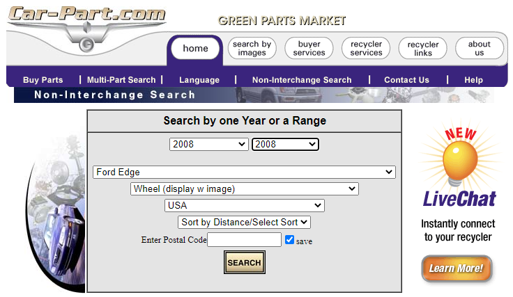

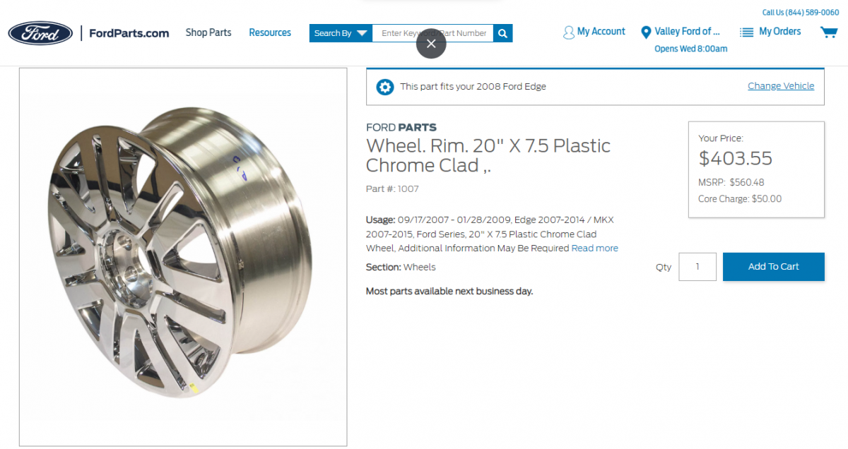

Haz Posted January 10, 2023 Report Share Posted January 10, 2023 The plastic chrome wheel applique is not sold separately from the aluminum rim assembly... From: https://parts.ford.com/shop/en/us/wheels-and-tires/wheel-parts/wheel-12970771-1 If you'd consider a used wheel, Car-Part.com's search feature allows designating a region, state, or major city and a zip code to provide distance-to-seller sorting of salvage vehicles with the desired Edge/MKX wheels... Good luck! 2 Quote Link to comment Share on other sites More sharing options...
