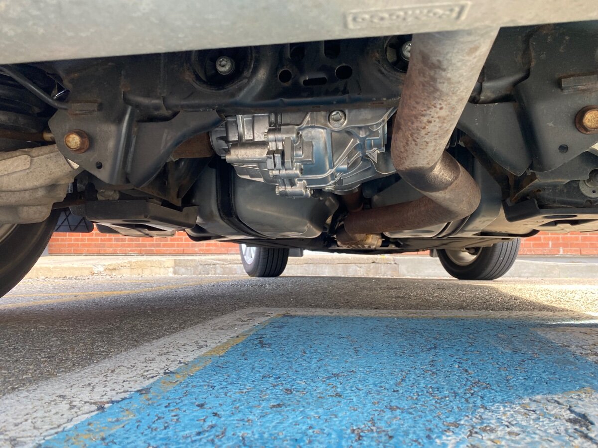

kodey116 Posted December 14, 2022 Report Share Posted December 14, 2022 Hey guys looking at my car on the rack today looking for a clunk that happens from every stop pretty much here is what I came across https://photos.app.goo.gl/vCk4nTdR3KnH47uW6 I believe it’s the differential needing replaced , just wanted to talk to our edge nation before taking it in 1 Quote Link to comment Share on other sites More sharing options...
Fingernip Posted December 14, 2022 Report Share Posted December 14, 2022 I had a full RDU replacement after it starting groaning during turns. It never developed a clunk but I could feel driveline resistance when it was groaning. It took about 2 weeks to get the replacement RDU and 6 hours to install. 1 Quote Link to comment Share on other sites More sharing options...

FrankT Posted April 3, 2024 Report Share Posted April 3, 2024 My 2020 Ford edge was making a roaring noise when I made a right hand turn at slow speeds. Ford programmed the differential but it still made the noise. They are now replacing it. Hopefully this will stop the noise. It is covered under five year 100,000 km warranty. 1 Quote Link to comment Share on other sites More sharing options...

FrankT Posted April 10, 2024 Report Share Posted April 10, 2024 On 4/3/2024 at 10:44 AM, FrankT said: My 2020 Ford edge was making a roaring noise when I made a right hand turn at slow speeds. Ford programmed the differential but it still made the noise. They are now replacing it. Hopefully this will stop the noise. It is covered under five year 100,000 km warranty. Ford fully replaced it under warranty. Issue went away. 2 Quote Link to comment Share on other sites More sharing options...
