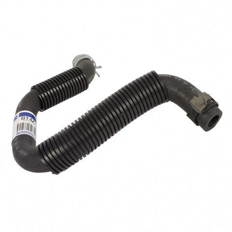

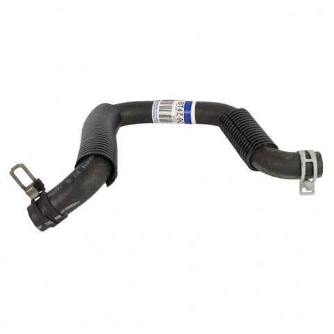

Haz Posted December 12, 2022 Report Share Posted December 12, 2022 Molded hose is Ford part number: BT4Z-9C482-A Link to Ford's online parts site showing 9C482 Performing a web search of BT4Z-9C482-A may yield improved pricing via online sellers. Good luck! 2 Quote Link to comment Share on other sites More sharing options...
Babytsunami Posted December 12, 2022 Author Report Share Posted December 12, 2022 This is it . Thank you. ? ? Thanks ? Quote Link to comment Share on other sites More sharing options...
DILLARD000 Posted December 19, 2022 Report Share Posted December 19, 2022 Vacuum from IntakeManifold for the Brakes, not a complicated part, just simple hose for air vacuum. Can use above FactoryOE FordMotorcraft part at a premium price, or a couple of feet of much less expensive stock 5/8"ID Vacuum\Heater\Fuel\Hydraulic Hose by the foot from any parts store. Personally don't have a problem telling stealerships to stuff their outrageous prices, when I get the chance. Quote Link to comment Share on other sites More sharing options...
