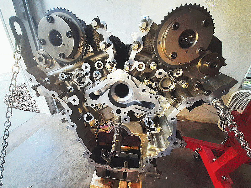

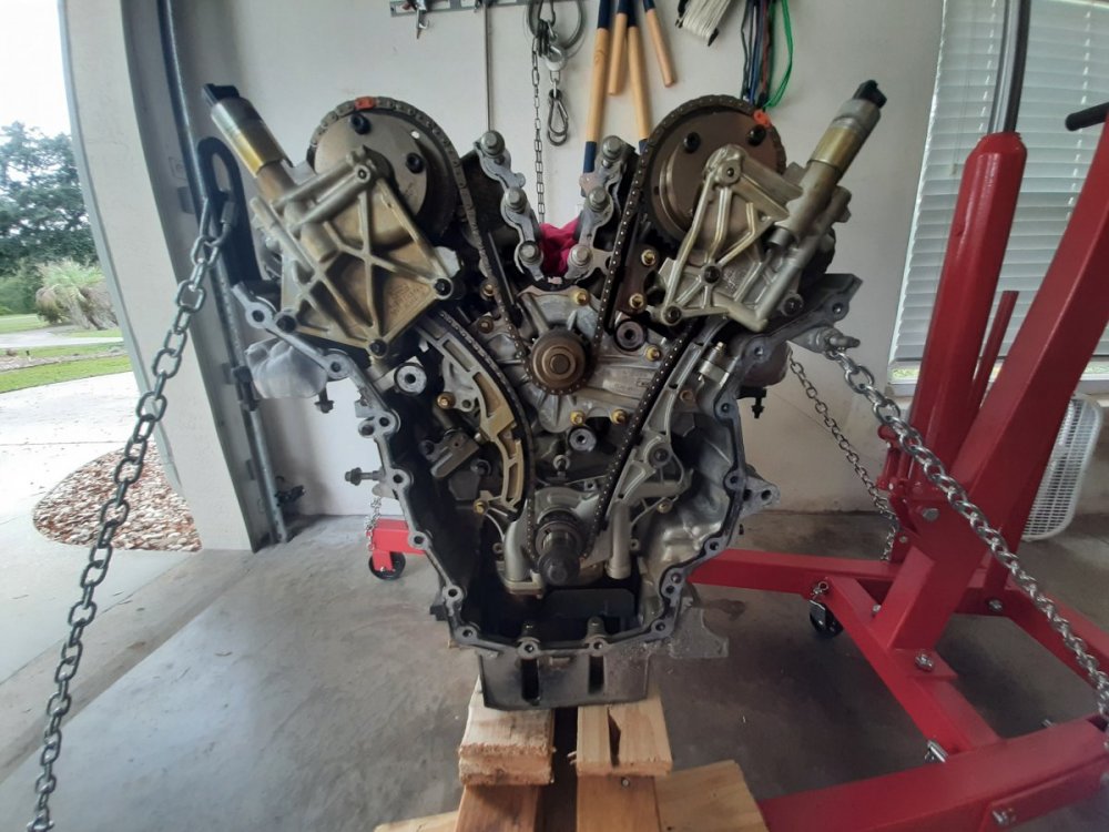

DILLARD000 Posted November 14, 2022 Report Share Posted November 14, 2022 (edited) 11 hours ago, Sjej said: ...engine interference or not?... Various discussions & bits of info out there on this, but seems to be no definitive answer. Assuming Ford V6~3.5L~DOHC is an interference engine, I used these parts for the Timing+Pump job: ~ Coolant\Water Pump, USMW# us6023 ~ Oil Pump, Melling# 10390hv ~ VariableValveTimingSolenoids\VVTS 2ea, Dorman# 917-201 ~ Timing Kit, Cloyes# 9-4226s ~ Crank TTY Bolt, Ford# f5rz-6a340-b ~ Cam TTY Bolt 2ea, Cloyes# vcb114 ~ Cam Holding Jigs, ATP# ap-04-2619 Cloyes instructional videos note Holding Jigs, pic below, are NOT required, but I felt need for them to insure CamShafts did NOT move during this work over several days. I replaced all Timing components excepting the 2 larger CamGears+Bolts; those were left in place. List above is NOT all inclusive of the various other items+supplies replaced or used. Edited November 14, 2022 by DILLARD000 Quote Link to comment Share on other sites More sharing options...
Sjej Posted November 15, 2022 Author Report Share Posted November 15, 2022 (edited) On 11/14/2022 at 6:02 AM, DILLARD000 said: Cloyes instructional videos note Holding Jigs, pic below, are NOT required, but I felt need for them to insure CamShafts did NOT move during this work over several days. I replaced all Timing components excepting the 2 larger CamGears+Bolts; those were left in place. List above is NOT all inclusive of the various other items+supplies replaced or used. Thank you!!! I'm assuming I need 2 of those tools. Makes me feel a lot better about doing the job, thank you. Edited November 15, 2022 by 1004ron No need to quote everything 1 Quote Link to comment Share on other sites More sharing options...
DILLARD000 Posted November 15, 2022 Report Share Posted November 15, 2022 (edited) 15 hours ago, Sjej said: Thank you!!! I'm assuming I need 2 of those tools. Makes me feel a lot better about doing the job, thank you. No, the CamHoldingJig kit comes with 2 jigs, one for each of the DualOverHeadCams, left & right, so only one jig kit needed. Good luck & keep us updated on your progress & any questions as you go. Edited November 15, 2022 by DILLARD000 1 Quote Link to comment Share on other sites More sharing options...
