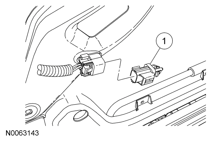

1004ron Posted October 26, 2022 Report Share Posted October 26, 2022 (edited) On mine the temp sensor is in the air filter box - I disconnected it when I removed the air-box for better access when I recently replaced my battery. Did you remove the air-box? Also, do a search for how to reset the Battery Monitory System (BMS) Edited October 26, 2022 by 1004ron 1 Quote Link to comment Share on other sites More sharing options...
Gustafa Posted October 26, 2022 Author Report Share Posted October 26, 2022 1 hour ago, 1004ron said: On mine the temp sensor is in the air filter box - I disconnected it when I removed the air-box for better access when I recently replaced my battery. Did you remove the air-box? Also, do a search for how to reset the Battery Monitory System (BMS) You know, I did pop the cover off to move it slightly to get the battery out. I thought the ambient temp sensor was over on the passenger side behind the grill? I wonder if by moving that air box lid it did something? Quote Link to comment Share on other sites More sharing options...

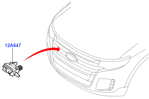

Haz Posted October 26, 2022 Report Share Posted October 26, 2022 (edited) For future reference, from the 2011 Edge/MKX Workshop Manual... Carry out the Battery Monitoring System (BMS) Reset using the scan tool after the battery is connected. If the BMS Reset is not carried out, it takes approximately 8 hours for the Body Control Module (BCM) to learn the new battery state of charge. During this 8 hour period, the vehicle must be undisturbed, with no doors opened or keyless entry button presses. If the vehicle is used before the BCM is allowed to learn the new battery state of charge, engine off load shedding can still occur and a message may be displayed. Additionally, the 2011 Edge/MKX's Ambient Air Temperature Sensor is located behind the grille, and removal of the Bumper Cover is required for access to the sensor... Ambient air temperature sensor Good luck! Edited October 26, 2022 by Haz 3 Quote Link to comment Share on other sites More sharing options...
