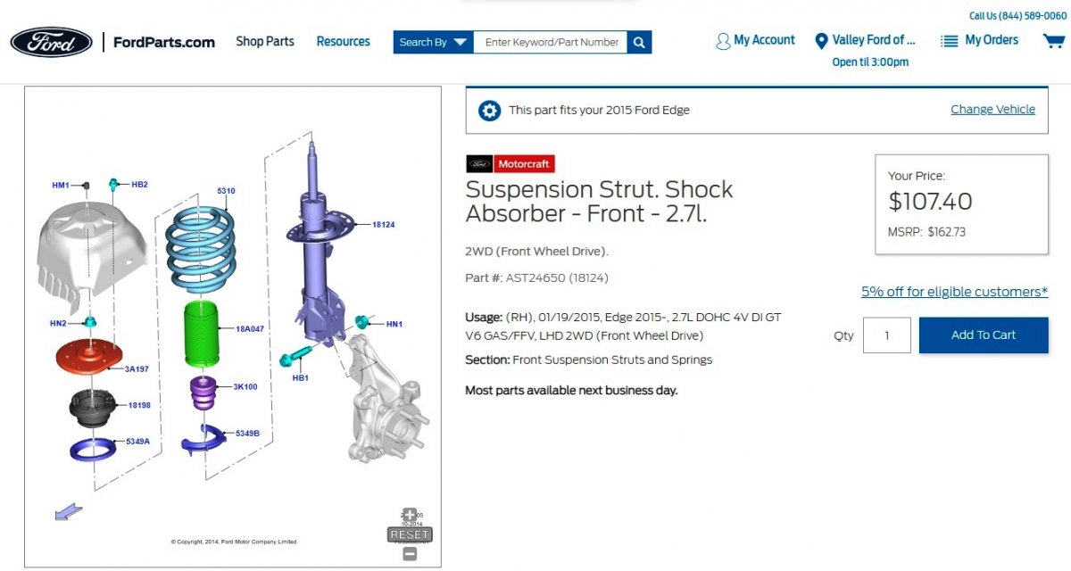

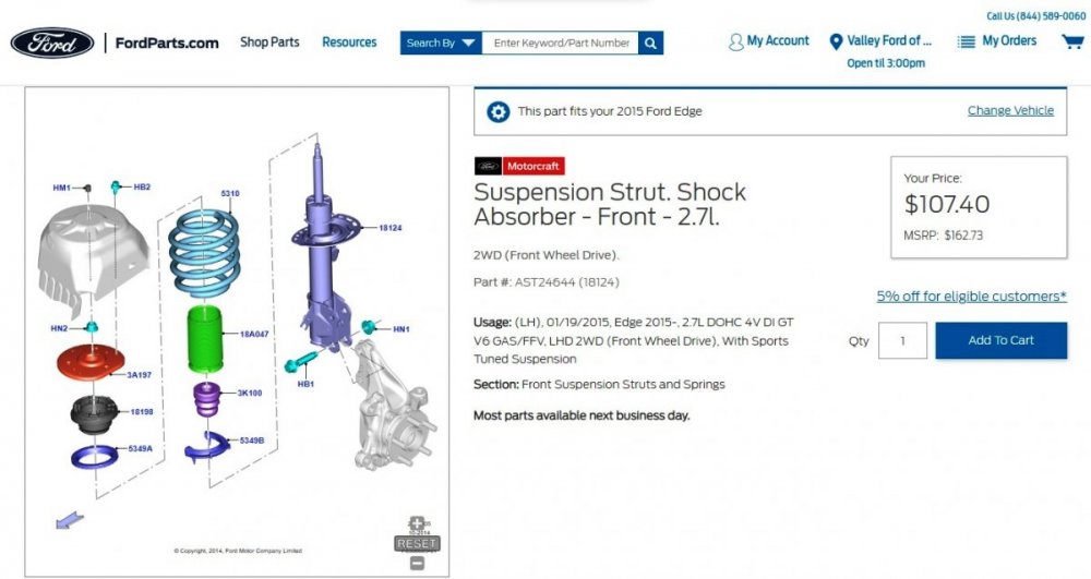

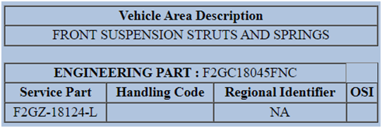

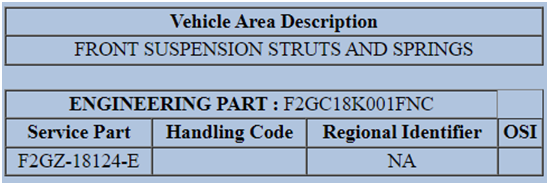

New to the forum and hoping to get some help before ordering parts. I have a new to me 2015 Ford Edge Sport w/21” wheels and FWD and I’m looking for the updated oem part numbers for the front struts. Called local dealer and they have me the part numbers as F2GZ-18124-E and F2GZ-18124-L which states fits the vehicle but doesn’t show that there for the 21” wheel option. F2GZ-18124-X and F2GZ-18124-Y seem to be the part numbers that state the 21” wheel option but also state AWD and not the FWD that I have. So question is are there a difference in struts for the 21” wheels? Will the ones that state AWD be the correct ones? Not looking to waste money on incorrect parts so any information would be extremely helpful.

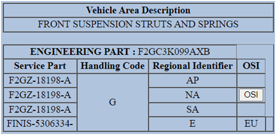

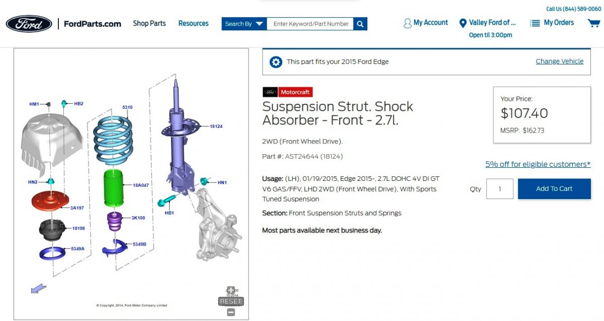

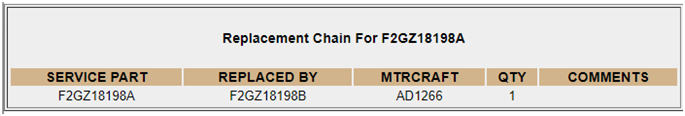

The following part numbers are from your Edge's VIN-specific Historic Vehicle Bill of Material (HVBoM) Report, with the originally installed Ford component being the Engineering Part, the contemporary replacement Ford component being the Service Part, along with the Motorcraft part number, cross-checked on Ford's parts website using your Edge's VIN ...
Left Hand Strut Shock Absorber
Motorcraft Part Number: AST24644
FordParts.com page link
1335322362_MotorcraftAST24644LHStrutShockAbsorber-FordParts.thumb.jpg.93e70fbcfa3ef0157fc398018544adb3.jpg
Right Hand Strut Shock Absorber
Motorcraft Part Number: AST24650
1003728231_MotorcraftAST24650RHStrutShockAbsorber-FordParts.thumb.jpg.c65977af63578b23f25eca2507c043be.jpg

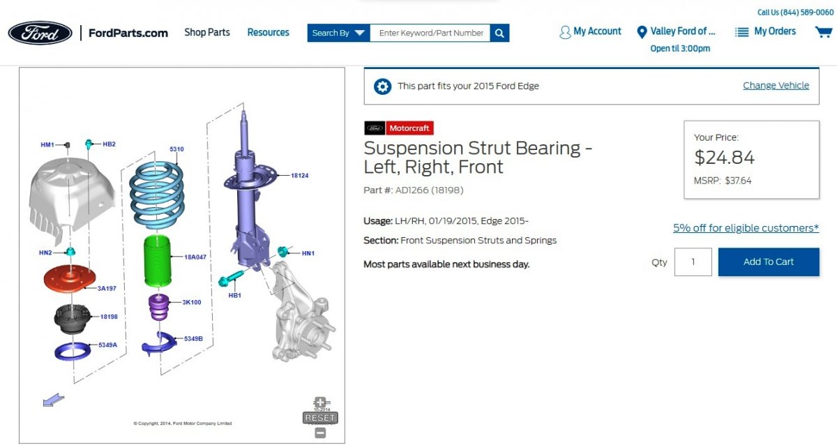

Left Hand & Right Hand Strut Bearings
1070323384_MotorcraftAD1266-LHRHStrutBearing-FordParts.thumb.jpg.8ce6c032e5f7a07b8f4b7c48b1570d62.jpg
