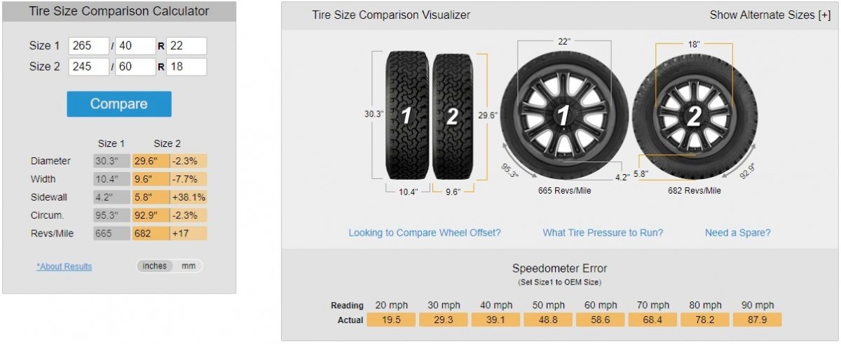

Haz Posted October 21, 2022 Report Share Posted October 21, 2022 (edited) Wheel-Size.com provides original equipment wheel & tire dimensional information on Ford Edge by model year. Some Mustang rims are also said to be dimensionally Edge-compatible. TireSize.com allows comparison of two tire/wheel size combinations to determine if speedometer error is created by the proposed change. Car-Part.com allows easy searching of auto salvage yards for used wheels, providing price, grading of condition/appearance, and usually photos of wheels available for purchase. My personal experience of swapping 265/40R22 tires on factory rims with 245/60R18 tires on factory rims between 2012 & 2015 MKXs did induce speedometer error in each vehicle that was easily corrected using Forscan. Good luck! Edited October 21, 2022 by Haz Quote Link to comment Share on other sites More sharing options...
