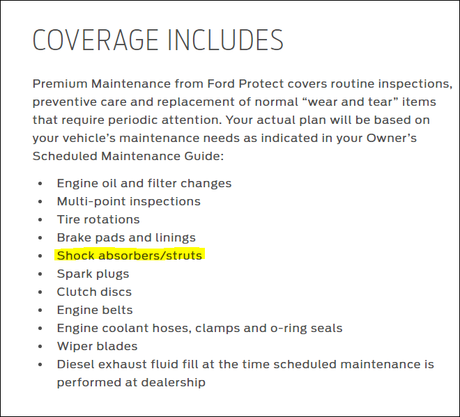

omar302 Posted October 19, 2022 Report Share Posted October 19, 2022 On 10/19/2022 at 7:56 AM, enigma-2 said: I was told that the rears are not covered under PremiumCARE. (Fronts are however). Rear shocks are designed to wear out and that isn't covered. Think I spent somewhere around $150-$200 at dealer. Expand Apparently I was mistaken. The website states "MacPherson Struts", no mention of "Shock Absorbers" and the brochure does mention "Shock Absorbers" as examples of repairs related to Maintenance that is NOT covered. Seems my mistake is due to the mixup between PremiumCARE and the Premium Maintenance Plan where it is covered: 1 Quote Link to comment Share on other sites More sharing options...
