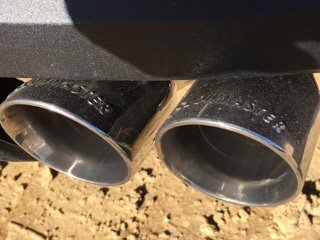

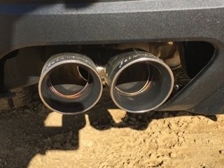

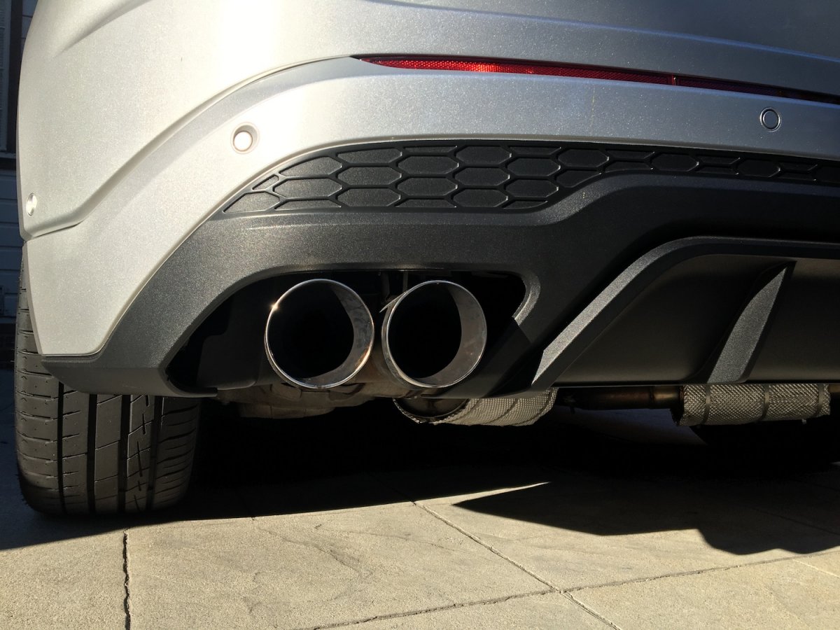

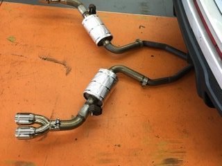

Xtra Posted October 2, 2022 Report Share Posted October 2, 2022 (edited) When running dual exhaust tips using a Y pipe the exhaust bezels must be removed to make room for the tips . I am running 2 1/2 inch in and dual 3 inch out tips on my 2016 Sport. Unfortunately you must also remove the tabs that the bezels attach to for the dual tips to fit . This is a permanent mod and once the tabs are removed they are gone forever and the bezel cannot be reattached. My tips are staggered with the inside tip shorter and they are also cut at an angle . . The 2.5 inch in and dual 3.5 inch tips out you are looking at will work great, 3.5 is the max size (imo) and will look and sound awesome ?. Theses are dual 2.5 inch tips I later swapped them out for dual 3 inch. Staggered, double wall, cut at an angle. Here you can see how the bezel is gone for the tips to fit. 2.5 inch tips. These are the 2.5 inch in and 3 inch out tips that I ended up with hooked up to my MRT Axle Back Exhaust system. Edited October 3, 2022 by Xtra 3 Quote Link to comment Share on other sites More sharing options...
TheWall0211 Posted October 2, 2022 Author Report Share Posted October 2, 2022 2 hours ago, Xtra said: When running dual exhaust tips using a Y pipe the exhaust bezels must be removed to make room for the tips . I am running 2 1/2 inch in and dual 3 inch out tips on my 2016 Sport. Unfortunately you must also remove the tabs that the bezels attach to for the dual tips to fit . This is a permanent mod and once the tabs are removed they are gone forever and the bezel cannot be reattached. My tips are staggered with the inside tip shorter and they are also cut at an angle . . The 2.5 inch in and dual 3.5 inch tips out you are looking at will work great, 3.5 is the max size (imo) and will look and sound awesome ?. Theses are dual 2.5 inch tips I later swapped them out for dual 3 inch. Staggered, double wall, cut at an angle. Here you can see how the bezel is gone for the tips to fit. 2.5 inch tips. These are the 2.5 inch in and 3 inch out tips that I ended up with hooked up to my MRT Axle Back Exhaust system. Great info. Thx. So did you modify beyond just the tips? How did you get the Y-tip to fit right? I prefer not to modify the entire exhaust system. I’m just doing it for cosmetics. Quote Link to comment Share on other sites More sharing options...
Xtra Posted October 2, 2022 Report Share Posted October 2, 2022 (edited) You can get clamp on tips and that’s all you need. You will have to permanently remove the chrome exhaust bezels and the tabs that the bezel screws to for the tips to fit. Once the tabs are removed the bezels cannot ever be put back on. So be sure about if you want dual tips for there’s no going back. If somehow you can get the tips on without removing the tabs then you will be able to see them and they look (imo) funky. I suggest for you to go with clamp on Y tips With 2 1/2 inch in and three or 3 1/2 inch out . You can unscrew and takeoff the bezel and then take a look see . Test fit the tips before cutting off the tabs. Edited October 2, 2022 by Xtra Quote Link to comment Share on other sites More sharing options...

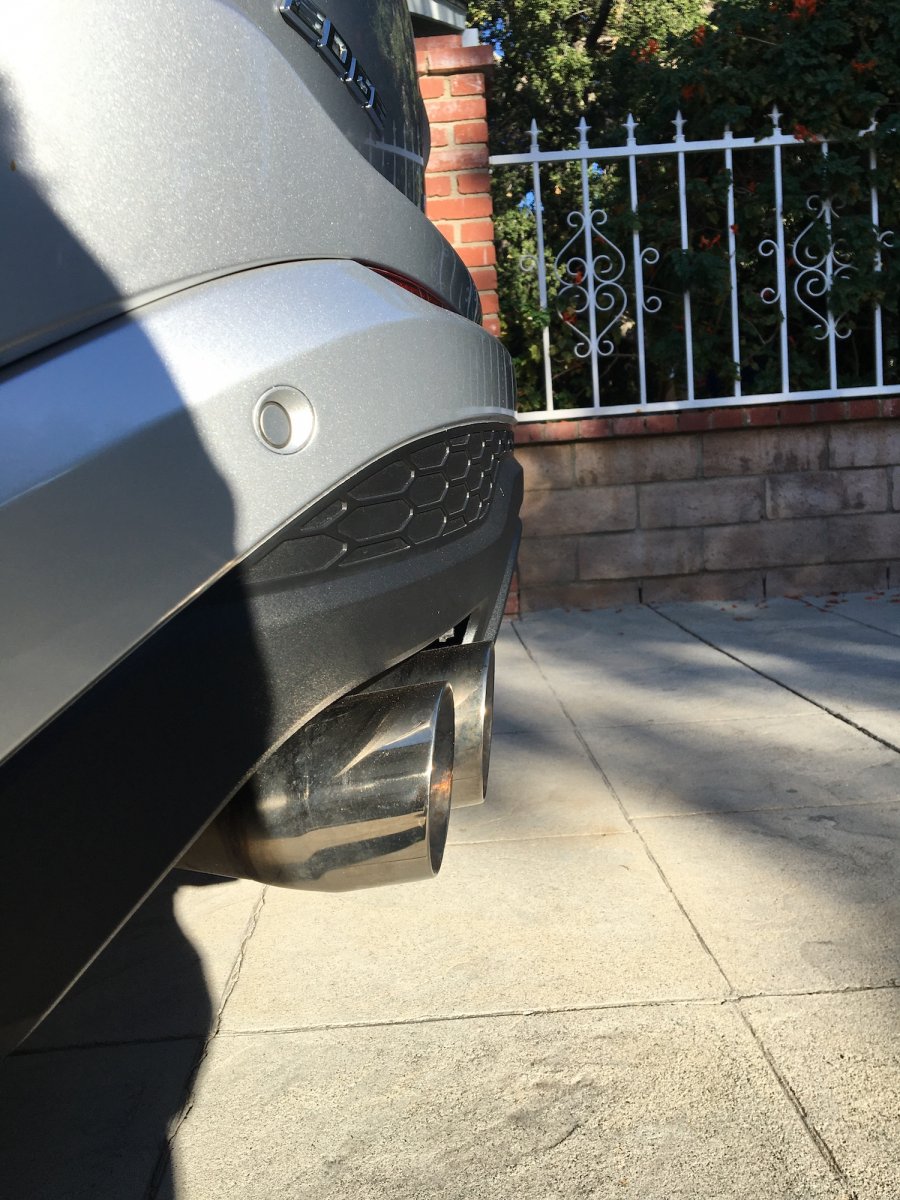

Xtra Posted October 2, 2022 Report Share Posted October 2, 2022 (edited) These are the 3 inch dual tips as installed on a 2016 Edge Sport. This gives an idea of how much room there is and how the 3.5 inch would fit. A small correction it is the inside tip that is is longer. Edited October 3, 2022 by Xtra 1 Quote Link to comment Share on other sites More sharing options...
