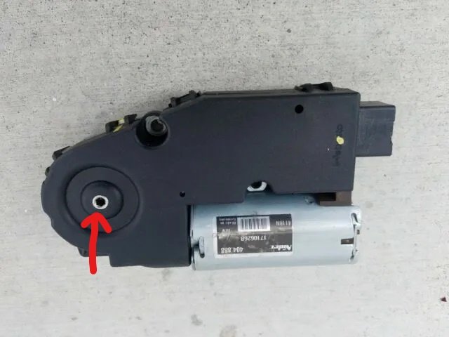

Sunnyorlando Posted November 8, 2022 Report Share Posted November 8, 2022 Is there a manual override for closing the vista sunroof in case of motor failure? From past experience, I know some vehicles include a manual crank override that can be used to close it. Does this sunroof have that? Quote Link to comment Share on other sites More sharing options...
Emayers04 Posted November 29, 2022 Report Share Posted November 29, 2022 On 11/8/2022 at 12:29 PM, Sunnyorlando said: Is there a manual override for closing the vista sunroof in case of motor failure? From past experience, I know some vehicles include a manual crank override that can be used to close it. Does this sunroof have that? Yes there is... but its not in an easy access spot. You'll have to drop the headliner in the rear near the lift gate. The sunroof motor is back there. You will see 2 motors, one for the Vista roof, and one for the fixed glass shade. The vista roof motor is the one closer to the passenger side. The center of the motor is a hex socket, I think I used a 4mm hex key to rotate the motor manually... much like a garbage disposal when stuck. I have attached 2 photos. First is of the location of the motor under the headliner, and second is the hex socket for the manual crank. 2 Quote Link to comment Share on other sites More sharing options...
Sunnyorlando Posted November 29, 2022 Report Share Posted November 29, 2022 (edited) 9 hours ago, Emayers04 said: Yes there is... but its not in an easy access spot. You'll have to drop the headliner in the rear near the lift gate. The sunroof motor is back there. You will see 2 motors, one for the Vista roof, and one for the fixed glass shade. The vista roof motor is the one closer to the passenger side. The center of the motor is a hex socket, I think I used a 4mm hex key to rotate the motor manually... much like a garbage disposal when stuck. I have attached 2 photos. First is of the location of the motor under the headliner, and second is the hex socket for the manual crank. Thank you! This is good information that one hopes to never use. I have in the past with another vehicle and it I found it in the owner's manual, though I have not seen it in this Edge's manual - I may have missed it, or maybe Ford doesn't think it will even be needed - thought they did include the hex hole. Edited November 29, 2022 by 1004ron Quote Link to comment Share on other sites More sharing options...
