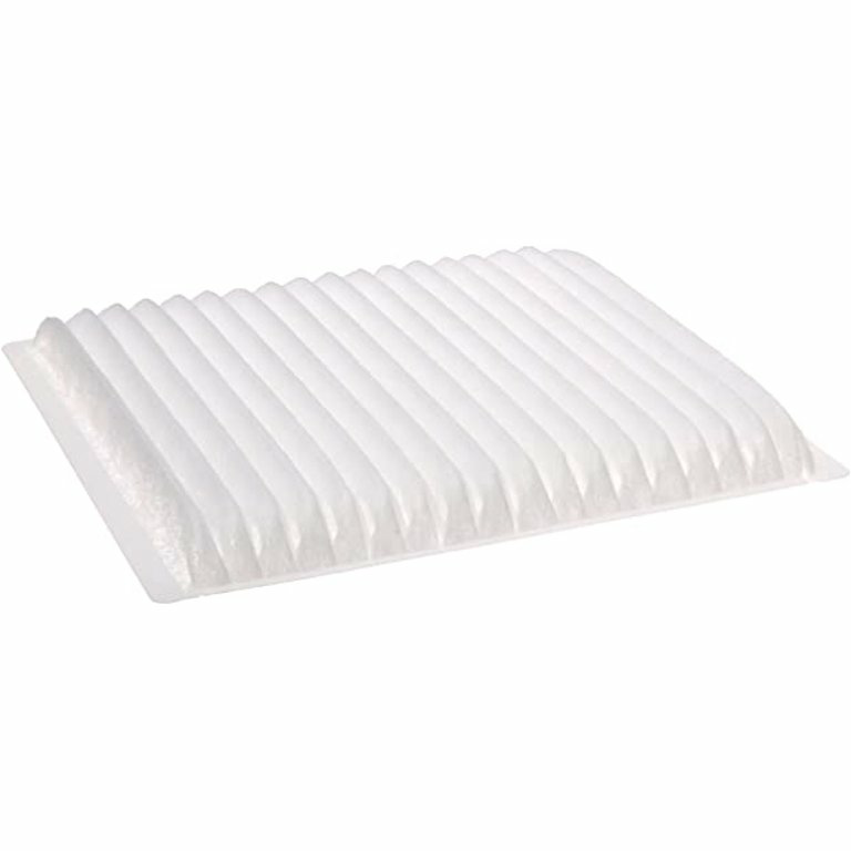

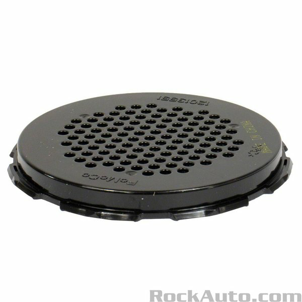

enigma-2 Posted October 30, 2022 Report Share Posted October 30, 2022 (edited) As @DILLARD000 said, plus check SPARK PLUGS, need to be changed at 90k miles. If there's any question, change all fluids, brake, pwr steering, PTU, COOLANT and TRANSMISSION. (Caps are .out important). Less important is the cabin air filter (behind glove box) and under seat filters (if you have heated/cooled seats. The filters in the 08 are actually filters. In late 09 and later these were changed to open grills). Motorcraft cabin air filter Under seat filter Edited October 30, 2022 by enigma-2 1 Quote Link to comment Share on other sites More sharing options...
