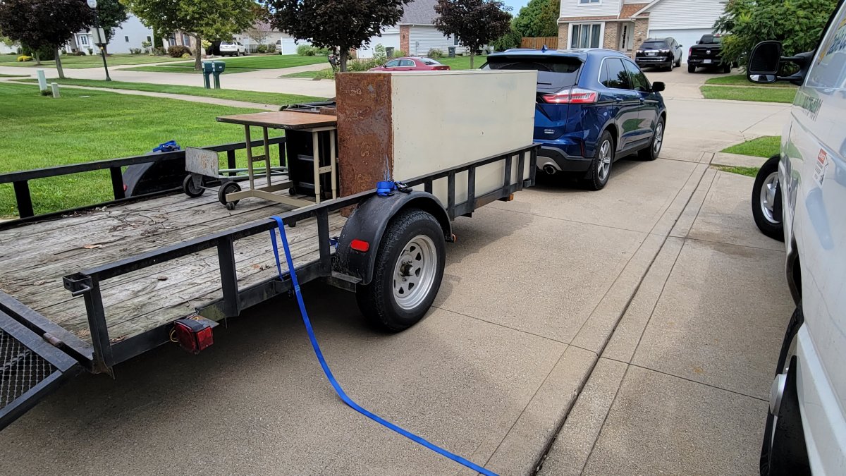

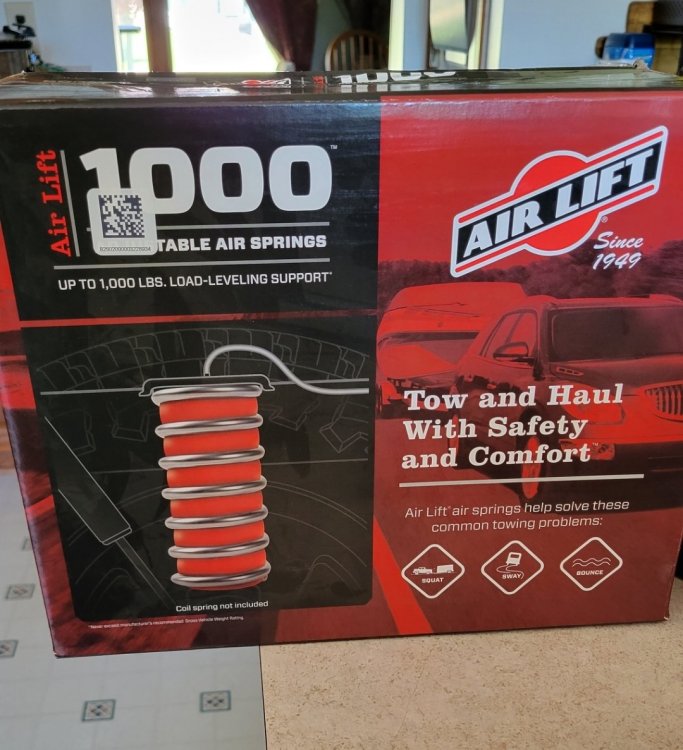

lildisco Posted September 5, 2022 Report Share Posted September 5, 2022 51 minutes ago, FatalScroll said: Yeah pretty sure because he said something along the lines of the 2.7 will grenade itself which doesn't make much sense to me as the MKX has the 2.7 and a 3500 tow capacity. I already have the hitch installed along with wiring, I use it for my small trailer but was worried about pulling a boat in-between 2-3k because the capacity is lower, I could just never figure out why. I just remembered something that it also has to be AWD to get 3500lbs, FWD is limited to 2000lbs. I think that it has something to do with bigger brakes & when you take off the weight transfers to the back, so having AWD helps there. All 2016 - 2018 Sports are AWD (2015 they made some FWD versions) & all ST's are AWD. If I could go back in time, I would have bought my 2020 SEL with the towing package so I wouldn't have to install the hitch & wiring, but I have a better hitch & don't have a hole in the bumper. If you want to continue towing near the max towing, I'd recommend changing fluids much earlier than recommended, upgrading your pads & rotors & look at helper springs to deal with the sagging. I bought Air Lift Springs & they definitely help with sagging when towing heavier things or when I have passengers in the back or lots of cargo. Quote Link to comment Share on other sites More sharing options...
