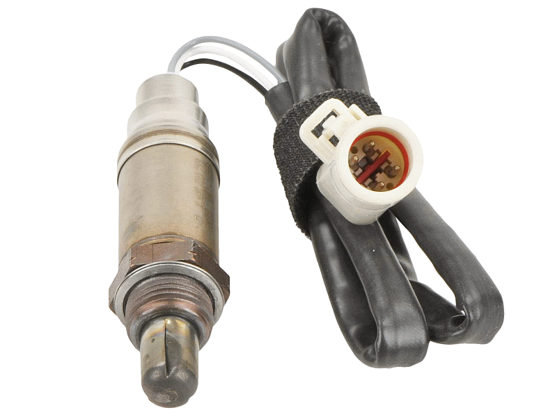

myf16 Posted July 31, 2022 Report Share Posted July 31, 2022 (edited) I have a 2009 Edge with a P0430 code (front bank catalyst efficiency). I want to start by changing the downstream oxygen sensor, which is very easily accessible. I want to use Ford parts or as close to their performance as possible. What are the Ford part numbers for upstream and downstream oxygen sensors? What company makes the Ford-branded O2 sensors? Bosch? I wouldn't buy a Brand X sensor, but I can get an NGK 22500 with connector for $32. Edited to add: I looked at the voltage outputs from all 4 sensors, and they are working great. It's the front catalyst that's not doing anything. Edited August 1, 2022 by myf16 1 Quote Link to comment Share on other sites More sharing options...

DILLARD000 Posted October 21, 2022 Report Share Posted October 21, 2022 (edited) OBD2 DiagTroubleCode p0430 = Exhaust CatCon#2\Left\Front Efficiency Low How many miles on Vehicle\OxSensors\CatCons? OxSensors slowly degrade\fail with Miles\Time as they're chemical-based sensors that deplete with use\age; should be changed every 100kMiles\10Years, along with SparkPlugs+Wires; so if still running 2009 factory OxSensors they're well overdue to be renewed. Old worn out OxSensors tend to bias the Fuel\Air mixture towards rich, so they cost you Mileage+Money & will cause the CatCons to run hot. Your vehicle has 4 OxSensors; 2 UpStream + 2 DownStream = 1 in each ExhaustManifold + 1 in each CatCon. All four OxSensors are 4WireNarrowBand type, are operationally alike & materially similar, excepting longer\shorter 4WireCables. MotorCraft or Bosch (Ford Factory Supplier) is recommended; avoid cheap Asian copies as they're notorious for failing within weeks\months after install. A Bosch 15719 with 24i00 0m610 Long Cable+Plug is good to replace any Ford 4WireNarrowBand Sensor, just ZipTie extra cable away from Hot\Moving parts. The FordMotorCraft parts are 7t4z-9f472-a\7t4z-9f593-a\5f9z-9g444-ab\dy1056, but no need to pay jacked up dealership prices, just buy the Bosch sensors. Edited October 21, 2022 by DILLARD000 1 1 Quote Link to comment Share on other sites More sharing options...
