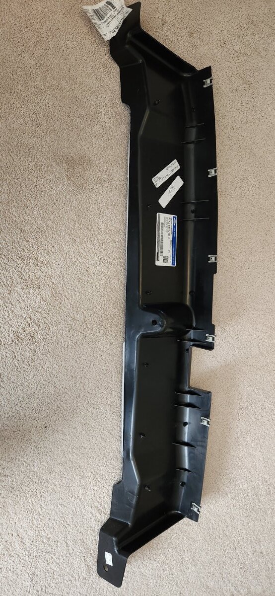

Having exhausted all my resources I decided to take a gamble and buy this part for my 2024 Titanium with tow pkg. So I ordered FT4Z-5811778-C instead of the KT4Z..... which fits the 2018 Edge. It arrived to day and it is a perfect fit, I do not have to modify it but still have to drill in the spare tire well for the middle screw. Attached are pics of the part and will post more when I get it installed, piece of cake but not for today. It is of plastic.
I mistakenly ordered 2 of the same. Anyone can have it for what I paid I think was $60. You can pick it up from Northwest Indiana

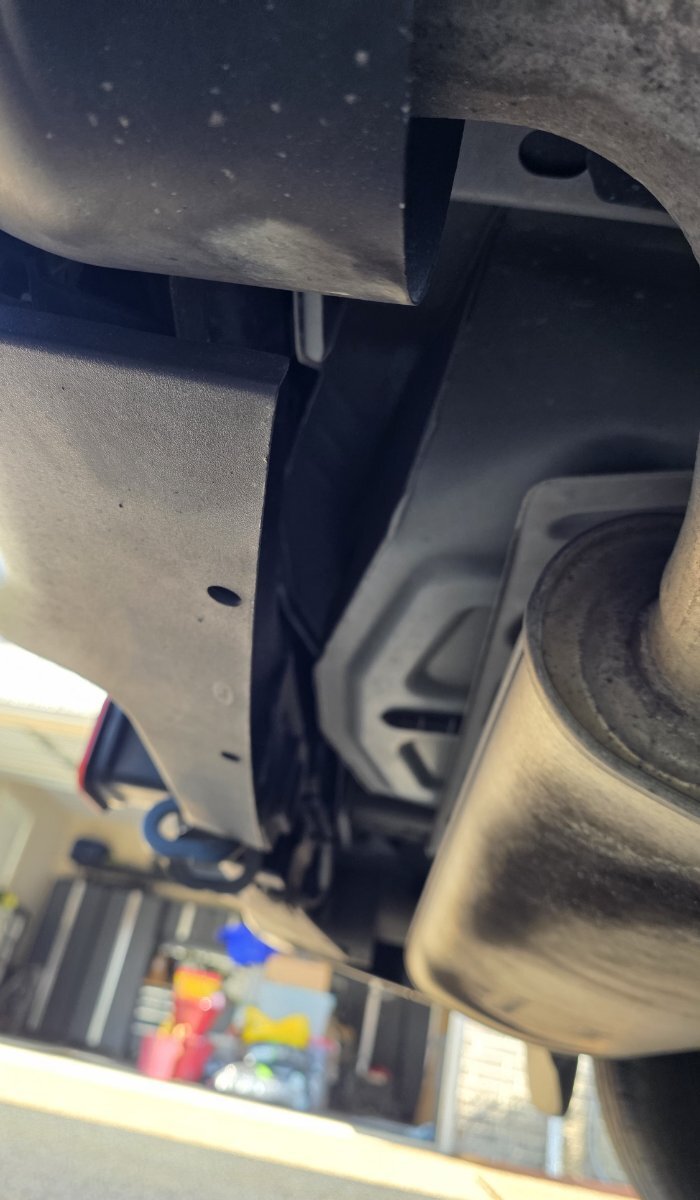

My wife and I just purchased a 2022 Edge Titanium three weeks ago. It’s used obviously, but only one owner and 33,xxx miles. It’s a great car, but I noticed on the way home from the dealership that the back bumber was moving quite a bit. I did some research, and here I am! I’ve tried to find the part(ours has the towing hitch), and it is no longer available. Do you have any idea where else I could find it? The Ford price isn’t too bad at all, so I’d like to find something close in price.

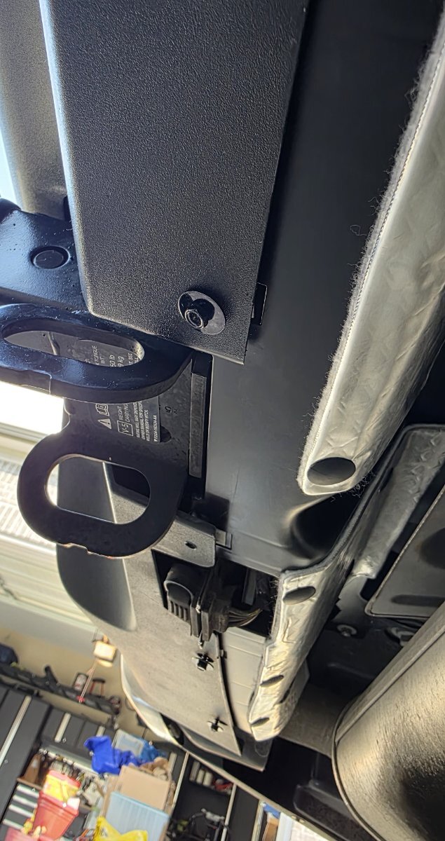

It fit perfectly. I yet have to add the screw that goes through the wheel well.
Attached is a picture from the installation, note how it fit tight against the tow hitch.

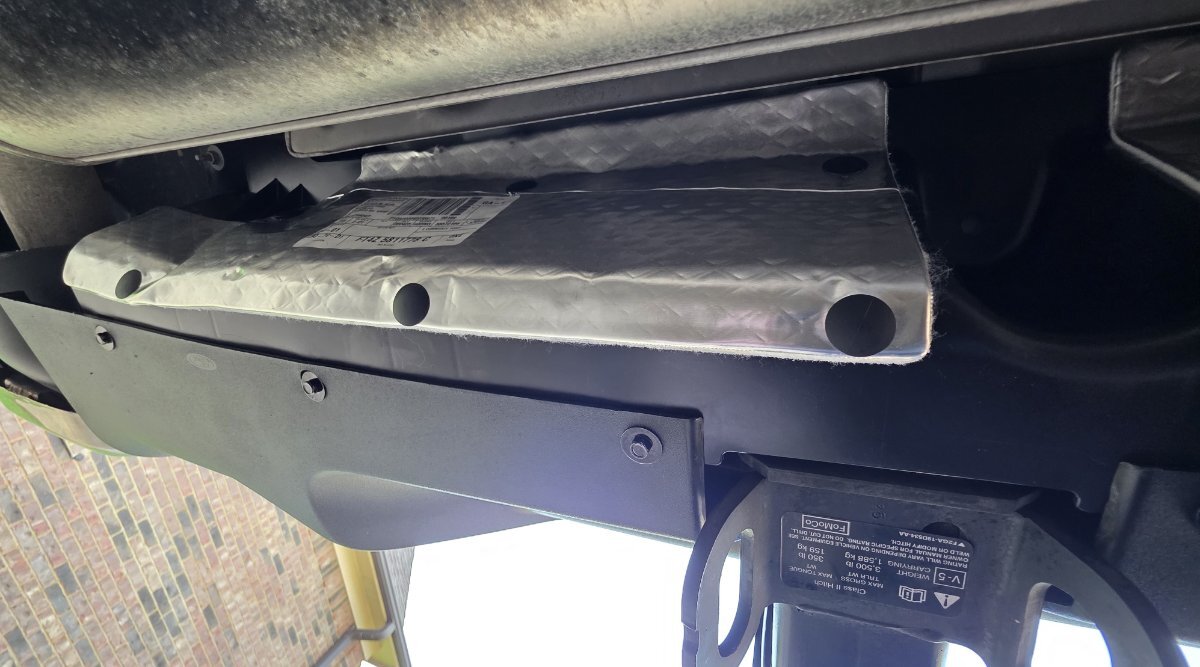

I just bought a new 2022 Edge Titanium and it came with the trailer hitch option. I noticed that the bottom (gray) part of the rear bumper was not attached to anything and flapped at hiway speeds. I called the dealer and was told that this is the way it works when this option is installed.  WHAT?  I can’t believe Ford would design it this way. Has anyone else had any experience with this?  Right now I have it secured with cable ties. Ugh.
I dont know if you resolved your problem but take a look at my post dated Nov 2, 24. I have the part you need as I ordered an extra by mistake . If you are anywhere close to Saint John, Indiana you could pick it up for what I paid for it.

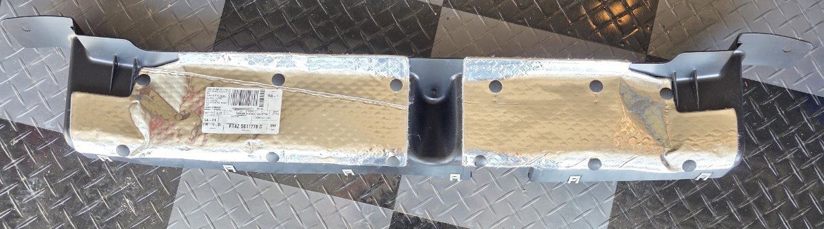

Jetboy 47, I recently acquired a FT4Z-581178-C and have a 2024 ST. A big Thank You to rafeeki for selling me his extra one!
I have not yet installed it, but from my measurements and visual observation, it will work. The screw holes and light plug cut out match up.
I may have to do some slight modification to the center area around the hitch, but it is plastic and can be cut out very easily. I am planning an install soon and will post my results.
If you can get either one (-C or -D) I believe the D would be the exact fit and no modification would be needed.
But since they no longer exist, get whichever one you can at this point.
