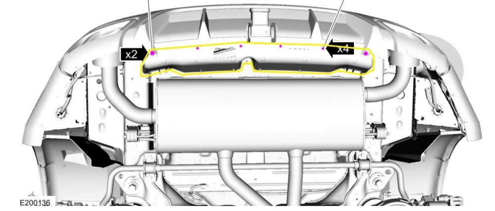

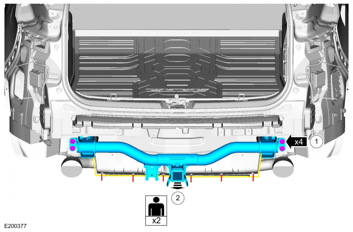

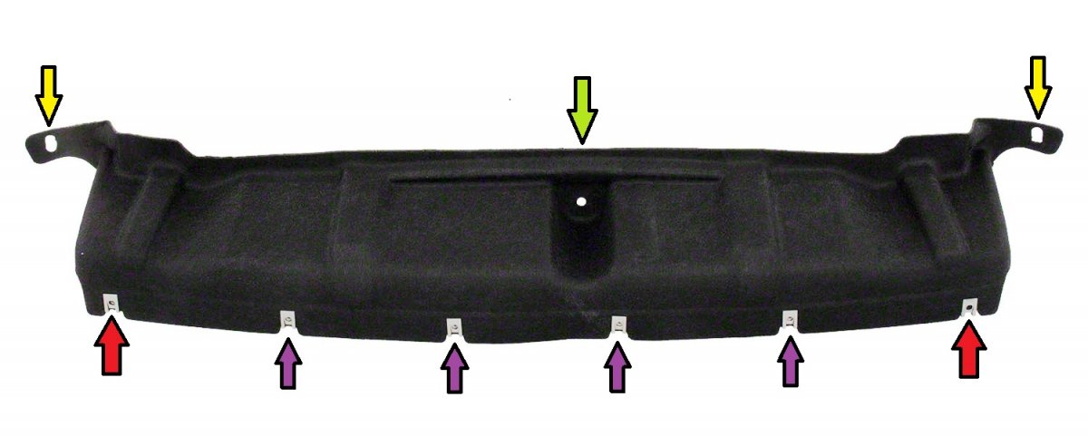

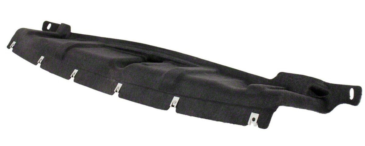

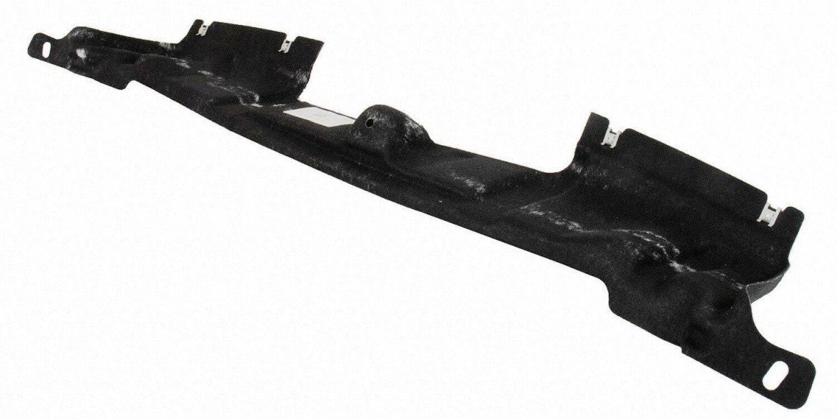

Haz Posted July 11, 2022 Report Share Posted July 11, 2022 (edited) So, absent feedback from other GEN 2 Edge owners, I'll offer the results of my online research. Edge Workshop Manuals from model years 2015-to-2022 show a panel, the Rear Center Bumper Cover Shield, which attaches to the bottom of the bumper cover with six screws, extends forward then upward between the muffler and the bumper bar or factory hitch bar, with the top leg screwed to the underside of the cargo area floor structure. The following Workshop Manual images have the pictured Rear Center Bumper Cover Shield outlined in yellow... I searched online OEM parts-sellers and Ford's own FordParts.com, and no reference to the Rear Center Bumper Cover Shield exists, including among illustrations of rear bumper cover buildups. I then pulled VINs for all GEN 2 model years from Edge's equipped with the Tow Package currently offered for sale online, and for each VIN, I ran Historical Vehicle Bill of Material reports, which list parts numbers of components specifically installed on each vehicle. Again, no reference to the Rear Center Bumper Cover Shield existed. If your zip-tie tethers to your rear bumper cover prove unsatisfying, you could take the Workshop Manual document from the PDF download link below, to your local dealer's Parts Department to see if their resources show the Rear Center Bumper Cover Shield. Rear Bumper Cover - Removal and Installation - 2022 Edge Workshop Manual.pdf As an alternative to this potential ghost part that escaped removal from GEN 2 Workshop Manual illustrations, you could fashion a V-shaped brace out of sheet plastic or other suitable material, like the brace molded with a live-hinge into the bottom edge or rear bumper covers of GEN 1+ Edges, which attaches with a single screw to the underside of the cargo area floor, between the muffler and the bumper bar or hitch bar, which is a fairly compact area... Aloha! Edited July 11, 2022 by Haz 3 Quote Link to comment Share on other sites More sharing options...

chipdog4 Posted July 12, 2022 Report Share Posted July 12, 2022 16 hours ago, Haz said: So, absent feedback from other GEN 2 Edge owners, I'll offer the results of my online research. Edge Workshop Manuals from model years 2015-to-2022 show a panel, the Rear Center Bumper Cover Shield, which attaches to the bottom of the bumper cover with six screws, extends forward then upward between the muffler and the bumper bar or factory hitch bar, with the top leg screwed to the underside of the cargo area floor structure. The following Workshop Manual images have the pictured Rear Center Bumper Cover Shield outlined in yellow... ... I searched online OEM parts-sellers and Ford's own FordParts.com, and no reference to the Rear Center Bumper Cover Shield exists, including among illustrations of rear bumper cover buildups. I then pulled VINs for all GEN 2 model years from Edge's equipped with the Tow Package currently offered for sale online, and for each VIN, I ran Historical Vehicle Bill of Material reports, which list parts numbers of components specifically installed on each vehicle. Again, no reference to the Rear Center Bumper Cover Shield existed. If your zip-tie tethers to your rear bumper cover prove unsatisfying, you could take the Workshop Manual document from the PDF download link below, to your local dealer's Parts Department to see if their resources show the Rear Center Bumper Cover Shield. Rear Bumper Cover - Removal and Installation - 2022 Edge Workshop Manual.pdf As an alternative to this potential ghost part that escaped removal from GEN 2 Workshop Manual illustrations, you could fashion a V-shaped brace out of sheet plastic or other suitable material, like the brace molded with a live-hinge into the bottom edge or rear bumper covers of GEN 1+ Edges, which attaches with a single screw to the underside of the cargo area floor, between the muffler and the bumper bar or hitch bar, which is a fairly compact area... Aloha! That's interesting, I installed the Ford hitch on my 2019 and reinstalled the all the bumper cover shields underneath. They fit with the hitch in place, but the mounting tab for the trailer wiring harness sticks down and was interfering with the felt cover. I had to trim it to fit there, maybe a 2"x3" square. I'll try to remember to get some pictures tonight. 1 1 Quote Link to comment Share on other sites More sharing options...

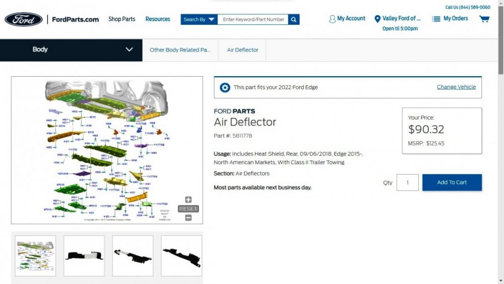

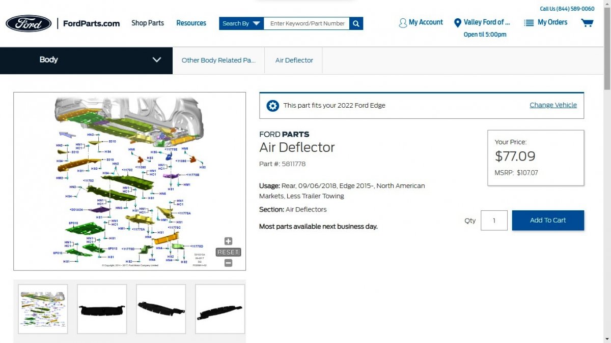

Haz Posted July 12, 2022 Report Share Posted July 12, 2022 (edited) Success! Service part numbers for missing Rear Center Bumper Cover Shields for GEN 2 Edges are... Without Trailer Tow = KT4Z-5811778-C - FordParts.com listing link With Trailer Tow = KT4Z-5811778-D - FordParts,com listing link For cost reference, FordParts listings with Hawaii pricing... For cost reference, FordParts listings with Mainland pricing... Be aware that many other online sellers of Ford OEM parts offer these parts at various prices, so search around if you're looking for the best deal. Regarding the question of when Ford stopped installing Rear Center Bumper Cover Shields on Edges, I did another ten-vehicle (small sample size) survey using VINs from Titanium & ST models listed for sale online, and then pulled HVBoM reports on each to see what vehicles were built with Rear Center Bumper Cover Shields. 2021 Edges built on or before the third week of May, 2021 were fitted with Rear Center Bumper Cover Shields. 2021 Edges built on or after the fourth week of May, 2021 and all 2022 Edges were not fitted with Rear Center Bumper Cover Shields. No clarity on whether supply chain issues contributed to this, though the parts are labeled majority USA content... Much gratitude to chipdog4 for commenting on the part's composite construction , which put me onto the underbody shields grouping containing Rear Center Bumper Cover Shields. Good luck! Edited July 13, 2022 by Haz 2 Quote Link to comment Share on other sites More sharing options...

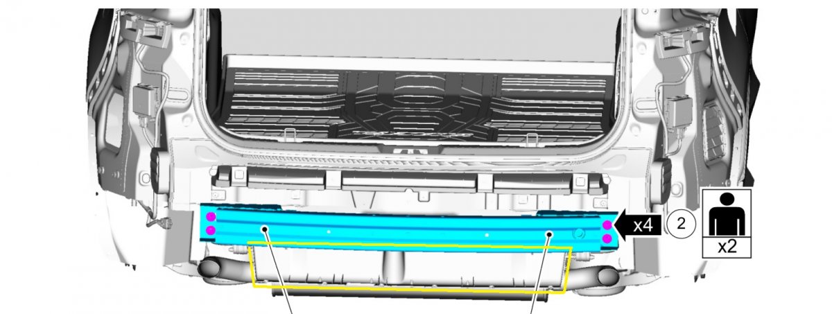

Haz Posted July 13, 2022 Report Share Posted July 13, 2022 (edited) The Edge Workshop Manual shows action involving the Air Deflector/Rear Center Bumper Cover Shield occurring before removal of the Bumper Cover, so taking the Bumper Cover off is not necessary in order to install the missing part on your Edge. PDF download link to Workshop Manual document: Rear Bumper Cover - Removal and Installation - 2022 Edge Workshop Manual.pdf Additionally, the Edge Workshop Manual shows two different sizes of screws -- not push pins or clips -- are used to fasten the Air Deflector/Rear Center Bumper Cover Shield to the bottom of the bumper cover... The number of screws needed depends upon whether you are installing the 'Without Trailer Tow' (6 total screws, 2+4) or 'With Trailer Tow' (4 total screws, 2+2) version of the Air Deflector/Rear Center Bumper Cover Shield. Also notice that the likely screw hole (green arrow) which allows attachment to the underside of the cargo floor, and the oblong holes (yellow arrows) in the tabs at the left & right ends of the panel. You may want to look and see if fasteners already are already in place for those attachment points, or, if you'll need to buy additional hardware, either from where you purchase the panel or if you buy (approximately) equivalent fasteners from your local hardware store... Without Trailer Tow With Trailer Tow Good luck! Edited July 13, 2022 by Haz 3 Quote Link to comment Share on other sites More sharing options...

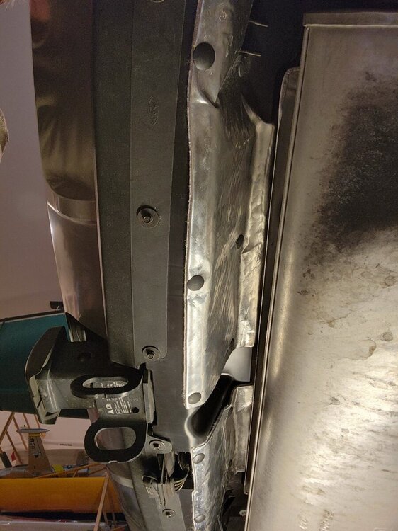

chipdog4 Posted July 14, 2022 Report Share Posted July 14, 2022 Nice find Haz! Crazy to see how much they cut out on the one with the tow package. I had to make a small cut for the wiring harness and that was it. The hitch does contact the cover and presses it down about a 1/4" right below the receiver tube. And someone asked about taking the bumper off to mount this, you should be able to get it in there with the bumper on. From the photos above, there's no mounts above the muffler either, just one on each side. 2 1 Quote Link to comment Share on other sites More sharing options...
