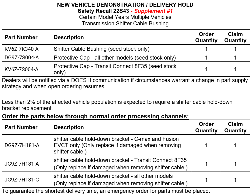

omar302 Posted July 28, 2022 Report Share Posted July 28, 2022 Hi Haz, I was surfing on NHTSA site and found the letter dated July 5th, 2022 to dealer (link). However, the part numbers in Attachment II of the letter are gibberish. Where the Part Numbers released? 1 Quote Link to comment Share on other sites More sharing options...
Haz Posted July 28, 2022 Author Report Share Posted July 28, 2022 (edited) Below is PDF download link to entire Dealer Bulletin document... Safety Recall 22S43 - Dealer Bulletin - Supplement 1 - August 1, 2022.pdf Good luck! Download link updated to Supplement 1 document, which clarifies dealership parts-ordering procedure. Edited August 5, 2022 by Haz 3 Quote Link to comment Share on other sites More sharing options...

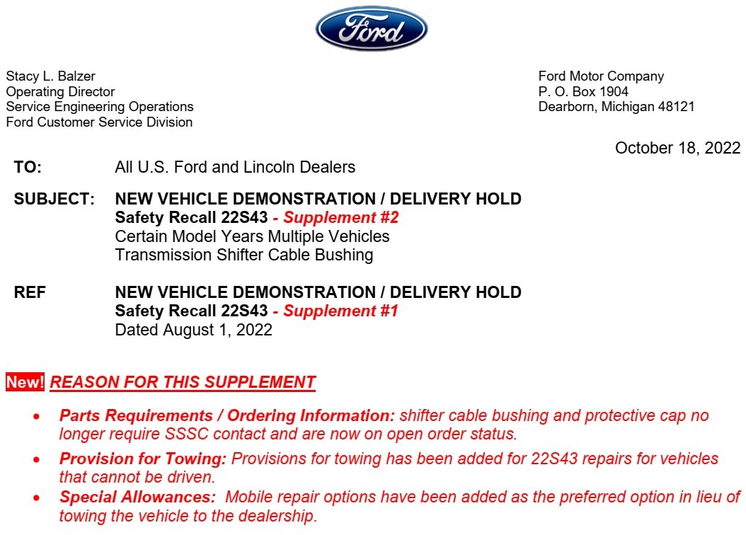

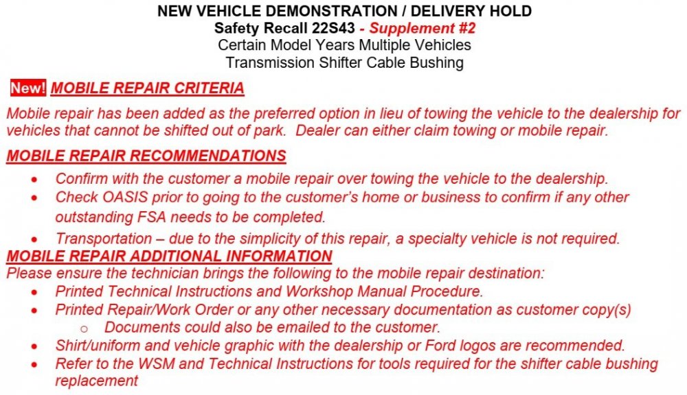

Haz Posted October 18, 2022 Author Report Share Posted October 18, 2022 Mobile repair service conducted at owner's home or business, and towing of undriveable vehicle being added to Safety Recall 22S43... Good luck! 2 Quote Link to comment Share on other sites More sharing options...

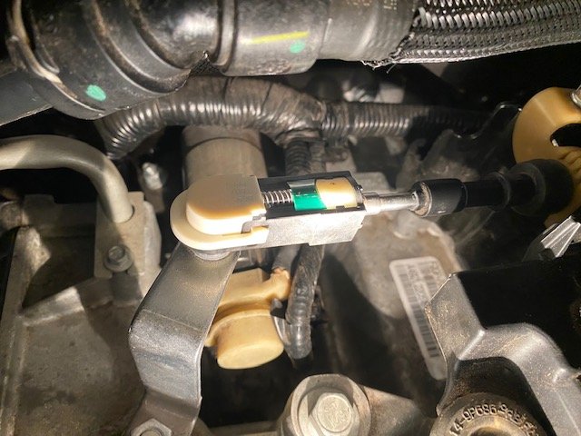

1004ron Posted November 17, 2022 Report Share Posted November 17, 2022 My weekend project. Picked up the parts today. 1 Quote Link to comment Share on other sites More sharing options...

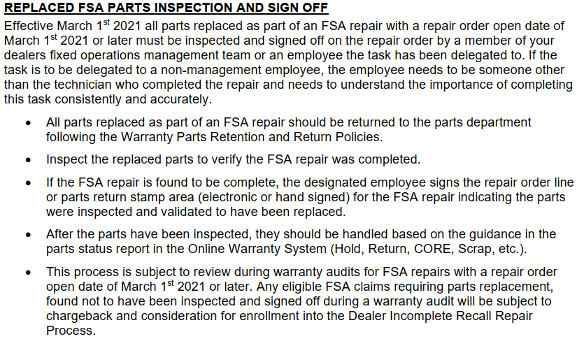

Haz Posted November 18, 2022 Author Report Share Posted November 18, 2022 (edited) Because you're personally doing the Recall repair work, it would be nice if your dealer found a way to grant you the half-hour of claimable Labor in FordPass Reward points... I'd expect them to submit for administering your Edge's Recall fulfillment, but not for the half-hour Labor you are supplying. I believe you mentioned previously, that they need the parts you remove, in order to technically complete their Inspection sign-off process... Good luck! Edited November 18, 2022 by Haz Quote Link to comment Share on other sites More sharing options...
1004ron Posted November 18, 2022 Report Share Posted November 18, 2022 @Haz this time the service manager didn't ask for the old parts, like he did when I changed the front brake hoses. Yeah, it would be nice to get Reward points. They sure do submit it, because CarFax is no longer showing this overdue. Quote Link to comment Share on other sites More sharing options...
bofus Posted November 22, 2022 Report Share Posted November 22, 2022 I just installed these parts last night on my 2018 Ford Edge. Pretty straightforward. The airbox requires a quick tug upwards to release the two plastic bulges that sit in two rubber doughnuts after removing the two bolts from the crash structure. The shifter housing retaining clip took a few minutes to figure out how to get it to release: there are two dimples that stick out and hold it in place. The one on the right can be pressed with your finger and then you can sort of twist (counter-clockwise) the yellow thing to release the dimple on the left. I used a plastic panel removal tool to pop off the connector from the transmission. I went with the 5mm and 15mm socket and large wrench method to press out the old bushing. Worked great! Releasing the adjustable end also took me a while. I found that you can slide the green locking tab with one hand and and then press the white clamp from the backside with flat plastic pry tool to be effective. Took me an hour, but I could do it in 20 minutes now that I know all the "tricks". 2 Quote Link to comment Share on other sites More sharing options...
