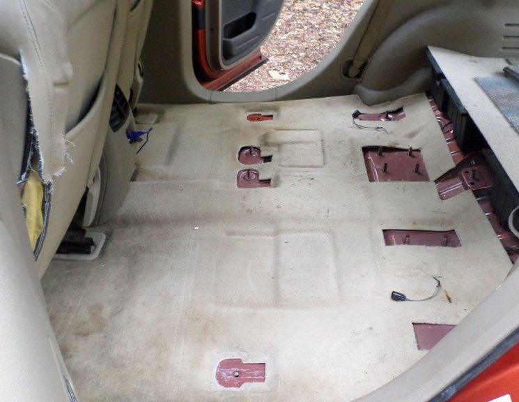

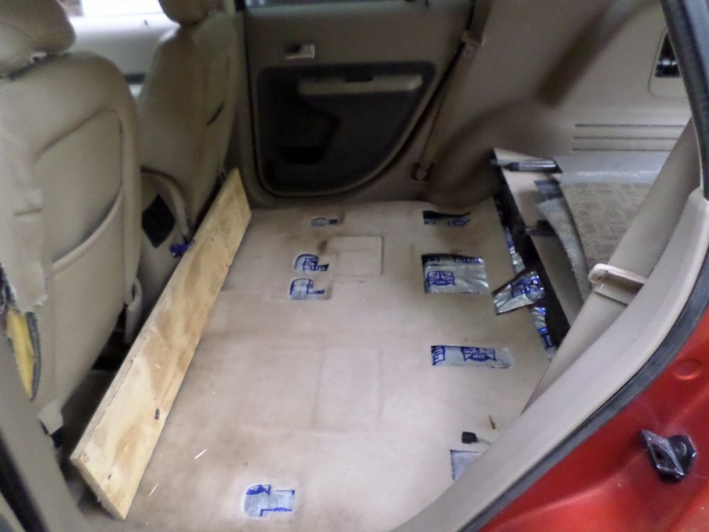

TangerineDream Posted June 14, 2022 Report Share Posted June 14, 2022 - to the point... I'm in the process of converting my 2007 Edge into a camper. I pulled out the rear seat in order to build a sleep platform with storage underneath. Now the car won't start !!!!!!! Motor turns over just fine fine but won't fire up. Going back to the last thing I did - there are 2 clips that I had to detach in order to remove the seat. I'm hoping I can 'jumper' the clips and it will solve my problem - on the other hand if that shorts out the computer I'm sunk ! LOL !!!! Any 'knowledgeable' advice out there ????? Quote Link to comment Share on other sites More sharing options...

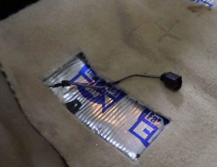

Haz Posted June 28, 2022 Report Share Posted June 28, 2022 (edited) Hopefully by now, you have determined the root cause of your Edge's no-start condition. The connectors in your photos were attached to the left & right Rear Seat Release Actuators that facilitated the remote fold-down of the rear seat backs. Good luck! Edited June 28, 2022 by Haz Quote Link to comment Share on other sites More sharing options...
