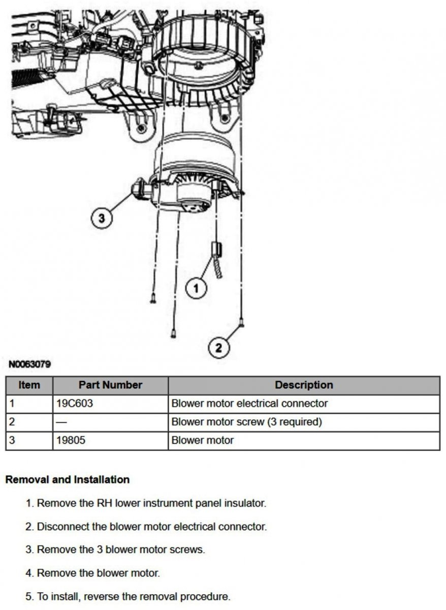

enigma-2 Posted June 2, 2022 Report Share Posted June 2, 2022 Shouldn't be a big deal to pull the blower out and check inside the housing for some foreign material. Something got into the duct, probably through the dash vent. 1 Quote Link to comment Share on other sites More sharing options...
Haz Posted June 2, 2022 Report Share Posted June 2, 2022 The following Blower Motor Removal and Installation procedure is from the 2011 Edge Workshop Manual... Good luck! 3 Quote Link to comment Share on other sites More sharing options...
Gustafa Posted June 2, 2022 Author Report Share Posted June 2, 2022 1 hour ago, Haz said: The following Blower Motor Removal and Installation procedure is from the 2011 Edge Workshop Manual... Good luck! Thank you for posting this, greatly appreciated! Quote Link to comment Share on other sites More sharing options...
