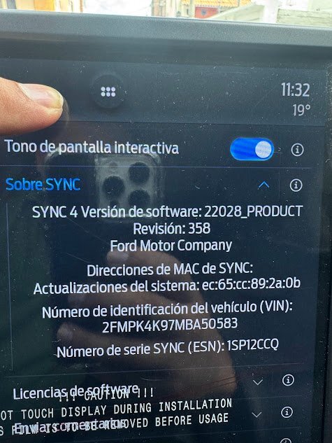

Skiples Posted April 5 Report Share Posted April 5 Hi i got the same proble, here in peru the last version is 22028_PRODUCT, and i got forward camera problem, does any body have the 4.2.4 update?? so i can download it to a usb and update it by myself 1 Quote Link to comment Share on other sites More sharing options...
Wubster100 Posted April 7 Report Share Posted April 7 On 4/4/2025 at 9:54 PM, Skiples said: Hi i got the same proble, here in peru the last version is 22028_PRODUCT, and i got forward camera problem, does any body have the 4.2.4 update?? so i can download it to a usb and update it by myself Welcome to the forum @Skiples You cannot just update SYNC 4 similar SYNC 3. To manually update SYNC 4, you must use FDRS. Quote Link to comment Share on other sites More sharing options...
enigma-2 Posted Tuesday at 10:09 PM Report Share Posted Tuesday at 10:09 PM (edited) On 4/7/2025 at 9:05 AM, Wubster100 said: Welcome to the forum @Skiples You cannot just update SYNC 4 similar SYNC 3. To manually update SYNC 4, you must use FDRS. Ford Diagnostic & Repair System? Cant you just do it through the Sync 4 system? ->Settings-> General-> Automatic Updates-> Scan for Update Now . Edited Tuesday at 10:10 PM by enigma-2 1 Quote Link to comment Share on other sites More sharing options...
Wubster100 Posted Tuesday at 11:47 PM Report Share Posted Tuesday at 11:47 PM Yes, that should work too. FDRS is needed to manually push updates. Quote Link to comment Share on other sites More sharing options...
