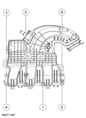

Sjej Posted April 25, 2022 Report Share Posted April 25, 2022 what is the tightening sequence and torque specs for the upper intake manifold? i've searched and found a few answers that said different things. should i even torque it or should i go by hand? Quote Link to comment Share on other sites More sharing options...
enigma-2 Posted April 26, 2022 Report Share Posted April 26, 2022 89 in-lbs 1 1 Quote Link to comment Share on other sites More sharing options...
Sjej Posted May 22, 2022 Author Report Share Posted May 22, 2022 On 4/25/2022 at 8:37 PM, enigma-2 said: 89 in-lbs Sorry I forgot to reply but thank you so much. Quote Link to comment Share on other sites More sharing options...
