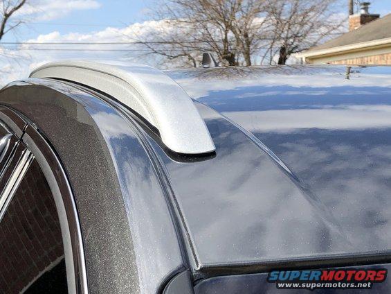

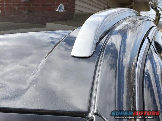

chipdog4 Posted March 15, 2022 Report Share Posted March 15, 2022 (edited) Because I didn’t want a hole in the roof to eventually leak. I noticed the passenger side roof rack was sitting a little high when I bought my Edge. Twice now after a very hard rain, I’ve had water on my passenger floormat, so when I washed it this evening, I took the hose and started spraying around the windshield looking for water inside. It wasn’t until I sprayed the passenger roof bar that I got water inside. So I’m guessing I need to partially drop the headliner to get to the fasteners that hold the bar on? Anyone messed with these before? As usual, there’s not going to be a gasket sold separately... https://www.fairwayfordparts.net/v-2019-ford-edge--titanium--2-0l-l4-gas/body--luggage-carrier Edited March 29, 2022 by chipdog4 Quote Link to comment Share on other sites More sharing options...

chipdog4 Posted March 16, 2022 Author Report Share Posted March 16, 2022 13 hours ago, enigma-2 said: I'd imagine that once its screwed back tight it will be water proof. But you could always use a small amout of clear silicone around the holes for extra protection. https://www.amazon.com/dp/B00ID8EDKY/ref=cm_sw_r_apan_glt_i_BHBT4PC24XVHJNT1M0GR That's first on my list, seeing if the bolts are loose. I can't really push down and compress the seal, so if feels like something may be keeping it from seating correctly. 13 hours ago, SC_ST said: What year and still under warranty? Dealer I say It's a 2019, but I have almost 53,000 miles on it, so no bumper to bumper left. 4 hours ago, Haz said: Below are PDF download links to relevant sections of the 2019 Edge Workshop Manual. Please note that related illustrations appear immediately following the numbered action-steps, but occasionally are on the next page in the PDF, due to formatting. You have certainly owned many nice FOMOCO vehicles. Good luck! Roof Rail Removal and Installation - 2019 Edge Workshop Manual.pdf Headliner Lowering - 2019 Edge Workshop Manual.pdf A-Pillar Trim Panel Removal and Installation - 2019 Edge Workshop Manual.pdf B-Pillar Trim Panel Removal and Installation - 2019 Edge Workshop Manual.pdf C-Pillar Trim Panel Removal and Installation - 2019 Edge Workshop Manual.pdf Loadspace Trim Panel Removal and Installation - 2019 Edge Workshop Manual.pdf Holy moly! Thanks man. This is a huge help. Quote Link to comment Share on other sites More sharing options...

chipdog4 Posted March 17, 2022 Author Report Share Posted March 17, 2022 I had some time after work and with some huge help from Haz, I didn’t tear anything up too bad ? I disassembled the b pillar and some of the a, and took out the grabbars. I was able to get my hand and a small ratchet passed the airbags. The bolts were tight, I gave them a bit more but it didn’t cinch it down any tighter. They take a 10mm socket and each bolt has a large rubber gasket under the bar. I think the roof bar was two pieces and hollow in the middle, water may be getting inside the hollow cavity and traveling down the alignment dowels net to the bolt holes. (there’s a good picture of the bottom in this eBay ad) Ebay ad Looks like I’ll be buying a pair of new bars cause if I have to drop the headliner, I’ll do em both. I’ll talk to the dealer but I doubt they be able to help. There was water spots and some dirt on the inside of the a pillar plastic, it’s traveling right on down the curtain airbags Quote Link to comment Share on other sites More sharing options...

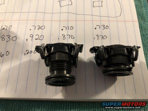

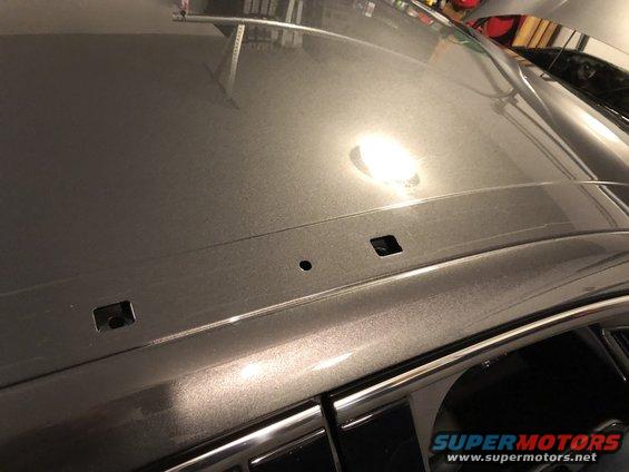

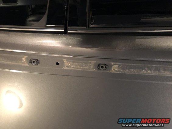

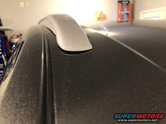

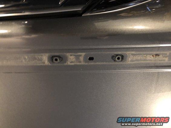

chipdog4 Posted March 29, 2022 Author Report Share Posted March 29, 2022 (edited) I purchased a new bar and it arrived yesterday, so I installed it. And it looked the same when I snugged up the bolts. ? So I started looking at the the "roof rack retainers" (spacer that inserts into the roof) and noticed they were different heights. I started filing on one to make it shorter to pull the bar closer to the roof and noticed it was actually growing. Doh! Discovered the spacers are adjustable. I then adjusted them all to the minimum height they collapse to and reinstalled the new bar. It's touching the roof in some places now, so it better be sealed up good. I wish they were contoured better to match the roof. I'd be interested to know how the set the height on those at the factory. They probably don't and just grab them from a container and slap them in... https://www.fairwayfordparts.net/oem-parts/ford-roof-rack-retainer-em2z58513a06c?c=Zz1ib2R5JnM9bHVnZ2FnZS1jYXJyaWVyJmw9NyZuPUFzc2VtYmxpZXMgUGFnZSZhPWZvcmQmbz1lZGdlJnk9MjAxOSZ0PXRpdGFuaXVtJmU9Mi0wbC1sNC1nYXM%3D Very dirty under the old bar. And what it started out looking like. Edited March 29, 2022 by chipdog4 Quote Link to comment Share on other sites More sharing options...
