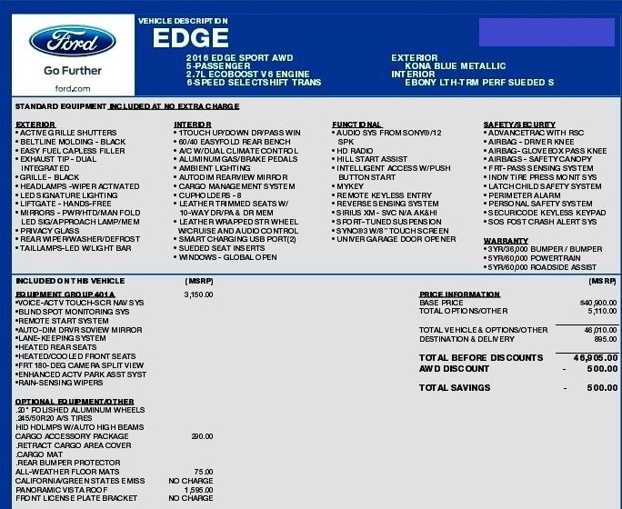

Haz Posted April 12, 2023 Report Share Posted April 12, 2023 The following are APIM As-Built values from a 2016 Edge Sport SYNC 3 vehicle equipped comparably to your 2015 Edge Sport SYNC 2 vehicle... 7D0-01-01 AA2A 0503 00B5 7D0-01-02 028B 0006 8AF7 7D0-02-01 5553 0104 E46B 7D0-02-02 0340 8000 009E 7D0-02-03 0000 DC 7D0-03-01 0000 0002 00DD 7D0-04-01 0100 0300 00E0 7D0-04-02 0007 E4 7D0-05-01 1BA3 1B9B 2B7C 7D0-05-02 C5A3 7D0-06-01 805E 7D0-07-01 0800 3300 001A 7D0-07-02 0000 186A 0062 7D0-07-03 0056 5686 0013 7D0-07-04 7052 7D0-08-01 0000 0000 00E0 7D0-08-02 0000 0000 00E1 Window Sticker for your 2015 Edge Sport SYNC 2 vehicle... Window Sticker for the 2016 Edge Sport SYNC 3 vehicle from which the above APIM values were obtained... I've used the Forum Messaging system to provide you a download link to information that file size limitations prevent me from sharing here. There are many Forum members who have successfully accomplished the conversion your are embarking upon, and I will leave it to them to be your advisors if you encounter difficulties or require fine tuning suggestions. Good luck! 1 Quote Link to comment Share on other sites More sharing options...
