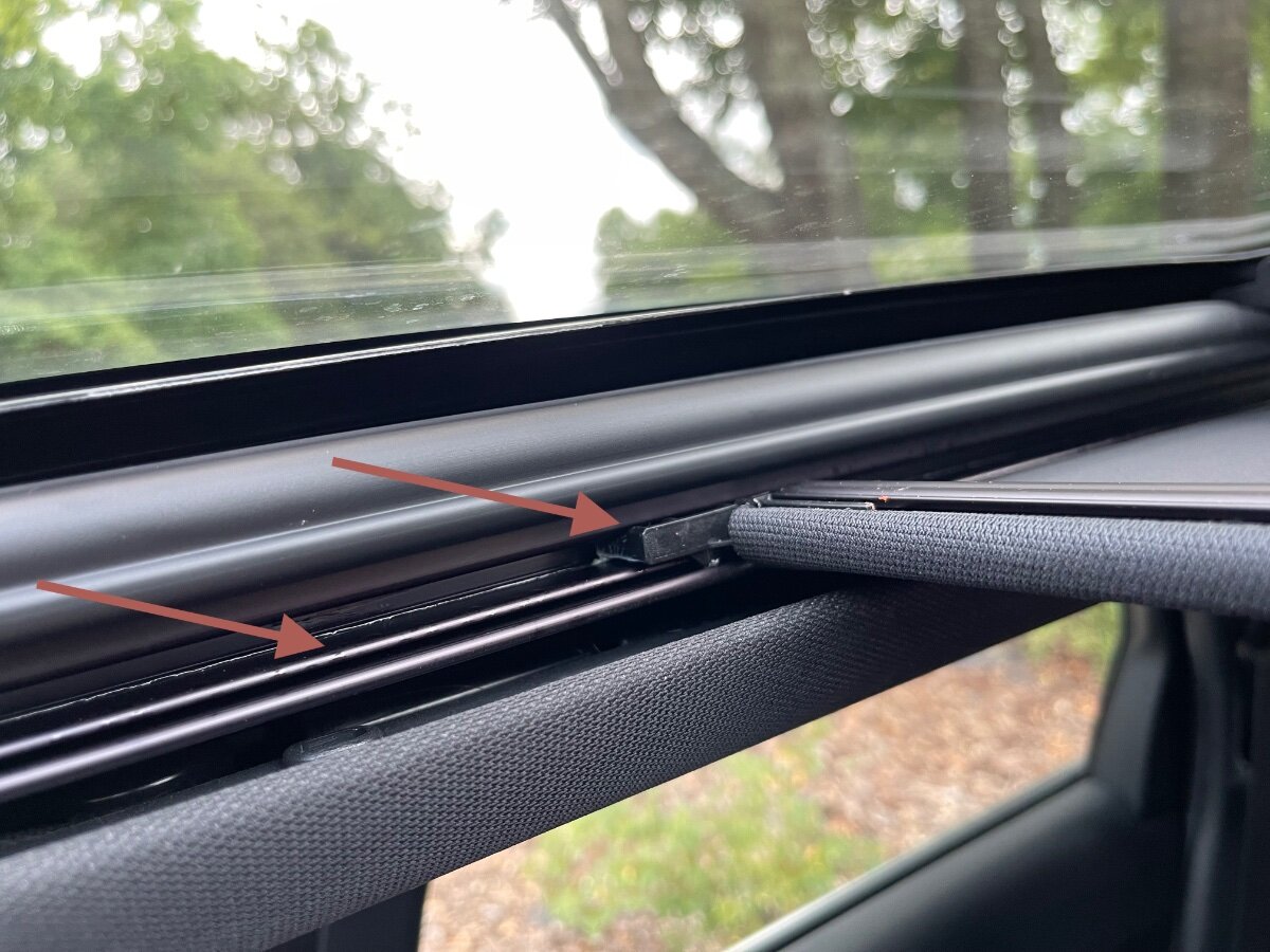

WMich18Sport Posted May 25, 2024 Author Report Share Posted May 25, 2024 The dealer had no idea how to fix it. There’s a post in the thread from a while back, where wrapping a Velcro tie strap around a clip on the bar that keeps the shade in place. The bar runs from side to side between the roof and the where the glass panel ends. The clip is located above the passenger side rear seat on the left side (if you’re looking out the back). It recommended a skinny short one, but I it would come loose over time and the rattle would come back. It’s really hard to get to, so I tried a wider and longer Velcro strap that would be a little stronger. Give it 2 tight wraps around the clip, then wrap it around the bar tightly (like a snake). This helps keep the Velcro in place over the rattling clip. It’s just hard to reach in there and wrap the Velcro, but it’s worth the pain in the a** to do it. Occasionally, I start to hear the rattle again a little bit, but simply pushing the Velcro back towards the clip eliminates the rattle again. It's been the best fix for the issue and lasts a very long time. I honestly forget that it’s an issue until it slightly comes back. A great fix! I’ll try to find the original post with the first solution and bump it. 2 Quote Link to comment Share on other sites More sharing options...
WMich18Sport Posted May 25, 2024 Author Report Share Posted May 25, 2024 Check out this thread. It gives you some good info on where the bar is. I would just recommend wider and longer Velcro to keep the clip tight and in place. Quote Link to comment Share on other sites More sharing options...

STBEAST Posted January 11 Report Share Posted January 11 Well, I traded my 21 in for a 2024 ST and after about 5300 miles I am hearing the clicking/ticking/popping sound so many of you described. Could anyone provide me a better description of where that bar is located? I did see the great pictures (and fix) provided by EdgeST2020 but just wanted to verify the location of that bar. Thanks so much! I know taking it to the dealer would just be a waste of time, so I will fix it myself. 1 Quote Link to comment Share on other sites More sharing options...
Davidoo Posted January 11 Report Share Posted January 11 It is in the very back of the area where the roof opens on the right (passenger) side. There is a silver metal clip, almost hook shaped, that goes over a metal thin rod that goes from the left to right side of the vehicle in the back. It is very hard to see. You have to push the left side of your head against the glass (with the sunscreen cover all the way open of course) and look towards that back passenger side corner. I got one of those very small eyeglass screwdrivers and put a thin piece of cloth about 1/2 inch square over the end of the screwdriver and pushed it between the silver metal springlike hook that goes over the bar and the rattle/ticking is gone! I have had mine work its way out a few times and had to push it back in. 3 1 Quote Link to comment Share on other sites More sharing options...
WMich18Sport Posted January 11 Author Report Share Posted January 11 Yep that’s the spot! I chose to use a Velcro strap like EdgeST2020 originally recommended, but I used a wider and longer one and wrapped the extra down the bar. It’s been working great and occasionally just needs to be pushed back on the clip if it comes slightly loose. Overall a great fix. 1 1 Quote Link to comment Share on other sites More sharing options...
Larry D Posted January 12 Report Share Posted January 12 (edited) I too had this rattle in my 2020 ST .. my fix was to take a piece of a tactical belt which is a little heavier and thicker than the Velcro … lift up on that spring loaded clip and place this piece under the clip that rest on the rail.. perfect fix been like this for about two months works without out fail … no noise or rattling Edited January 12 by Larry D 1 2 Quote Link to comment Share on other sites More sharing options...

GTEyes Posted January 15 Report Share Posted January 15 (edited) 3 hours ago, WMich18Sport said: I experience the same thing when the temperature drops. I find I have to adjust or push on the Velcro to cover the clip more often during the summer months. The fix I saw on another thread (see below) had a lot more velcro...mine was only a small piece between the clip and bar, which might be why it didn't seem to do anything. Edited January 15 by GTEyes Quote Link to comment Share on other sites More sharing options...
WMich18Sport Posted January 15 Author Report Share Posted January 15 It’s definitely the best fix. If you wrap the extra Velcro down the bar (like a snake), it will help keep it in place to keep the clip secure. Quote Link to comment Share on other sites More sharing options...

WMich18Sport Posted January 29 Author Report Share Posted January 29 The dealer never had any idea how to fix it for me on my ‘18 Sport. Thankfully, the post of the photo shown above seems to be the only solution. I found better luck with wider Velcro. Sometimes you have to push the Velcro back over the clip if it slips a little off the clip, but it works for sure. 1 Quote Link to comment Share on other sites More sharing options...
