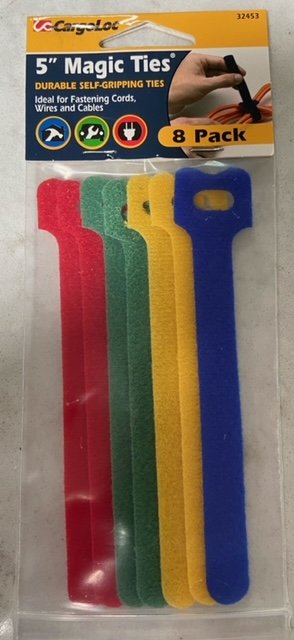

WMich18Sport Posted April 18, 2022 Author Report Share Posted April 18, 2022 Yes! I have the exact same metal bar in mine. I went and picked up some Velcro One-Wrap ties and it’s working really good! Makes a HUGE difference. I can still hear the occasional tick but wow, so much better. Drove all over town on some really bumpy roads and I can barely hear it anymore. I could probably get it a little tighter too, just tough to work in that small spot. Maybe adding some hush tape will completely eliminate it. Thanks for figuring this out and sharing the info!! Just knowing what the culprit is is a huge relief! Thanks! Quote Link to comment Share on other sites More sharing options...
enigma-2 Posted April 19, 2022 Report Share Posted April 19, 2022 (edited) Looking at the fix, is there any possibility that the excess wrap could catch on the moving psrts and bind the sliding mechanism? Seems to be a really poor engineering design, the clip just pressing against the rail. Wonder if putting a slight more bend in the clip itself, to press a little harder against the rail, would eliminate the tiny gap? Did it rattle when open or just when closed? I +hate+ ticking rattles. And plastic-on-plastic squeeks. Good find edgeST2020! Would makeva good YouTube video. Edited April 19, 2022 by enigma-2 Quote Link to comment Share on other sites More sharing options...
EdgeST2020 Posted April 19, 2022 Report Share Posted April 19, 2022 5 hours ago, enigma-2 said: Looking at the fix, is there any possibility that the excess wrap could catch on the moving psrts and bind the sliding mechanism? Seems to be a really poor engineering design, the clip just pressing against the rail. Wonder if putting a slight more bend in the clip itself, to press a little harder against the rail, would eliminate the tiny gap? Did it rattle when open or just when closed? I +hate+ ticking rattles. And plastic-on-plastic squeeks. Good find edgeST2020! Would makeva good YouTube video. Fair question. I don’t think it should catch on anything. That said you could just snip the excess wrap with scissors - i just want to be sure it stays in place before i do. I didnt want to bend anything for fear of creating another problem elsewhere. My rattle was always present - whether sunshade closed or open. i guess there is a risk the velcro comes loose, falls off, and gets wrapped up in the sunshade as it retracts so maybe tape on the top of the bar is a good idea too. I rarely have a need to close my sunshade. But absent the dealer giving me a better solution after spending countless hours shuttling back and forth, i will take this. hopefully, simply knowing that this velcro fix “works” at least gives people some info the dealer can use to fix it more properly. 2 Quote Link to comment Share on other sites More sharing options...
