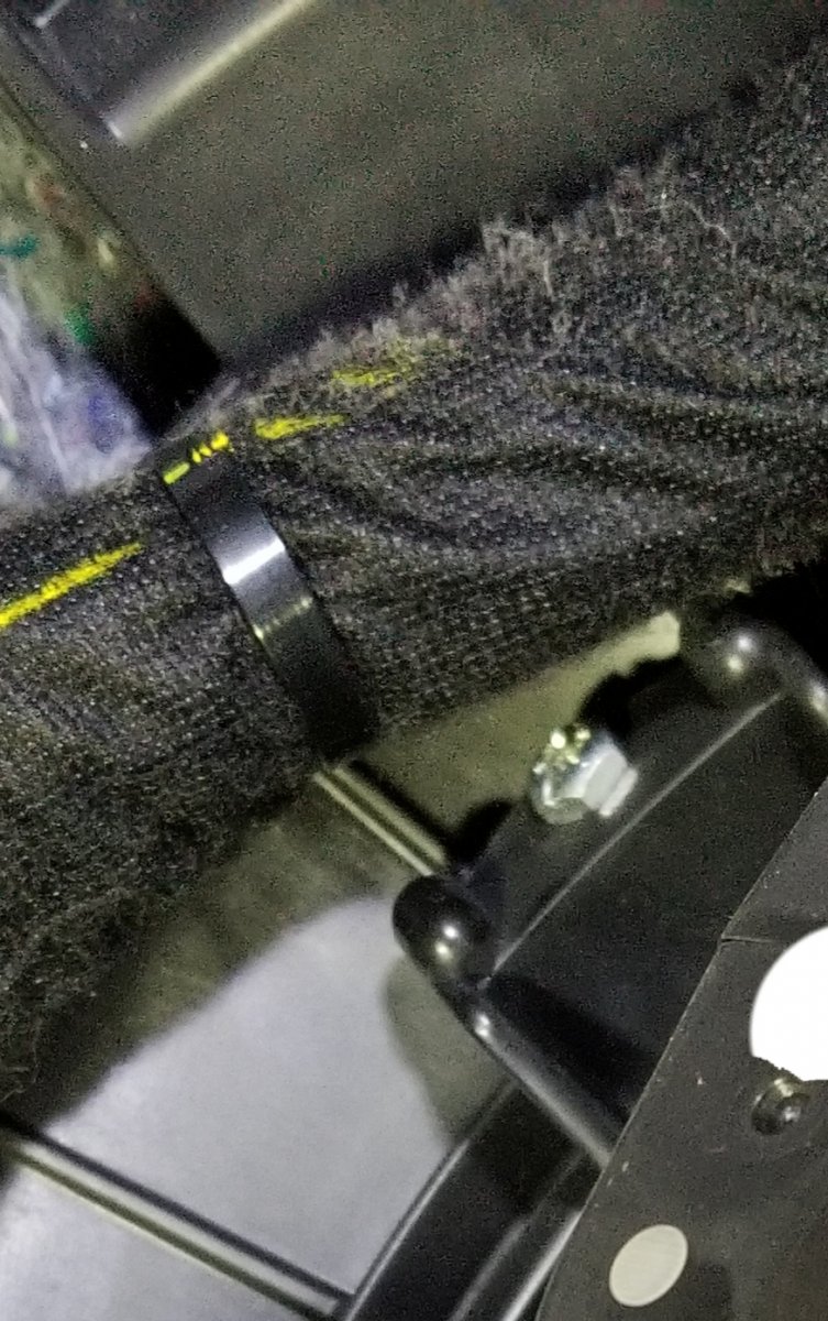

Josh22 Posted February 10, 2022 Author Report Share Posted February 10, 2022 Good news I was able to access the bottom of the blower motor. Bad news is whoever installed it has one of the screws impossible to get to. Maybe an inch of space to work with Quote Link to comment Share on other sites More sharing options...
enigma-2 Posted February 12, 2022 Report Share Posted February 12, 2022 Looks like a 5 or 6 mm box or open end wrench can undo it. (Or use a small, 5" adjustable wrench). How about unhooking the pipe support strap and pushing the pipe out of the way? Quote Link to comment Share on other sites More sharing options...
Josh22 Posted February 14, 2022 Author Report Share Posted February 14, 2022 (edited) I couldn't see where the strap was hooked to. I am looking at this with half my body sticking out of the passenger door and partially upside down so It's hard to get the proper perspective. I was able to unsnap the support strap. It was just a snap in. That gave me just enough room to use an extended socket wrench and go behind the pipe. I believe it was a 5/16. I don't have any mm or at least I couldn't find them. But it worked. After I was able to get all of the screws out it was tricky trying to remove the blower motor because that same pipe was in the way. Took some time and a lot of adjusting (and patience) but finally got it removed. It was much easier installing the new motor. Just had to angle it the right way after a few tries. No more noise coming from the motor and everything runs great. Hopefully the next person having this issue can use some of this information. Thanks again for everyone's insight. Edited February 14, 2022 by Josh22 2 Quote Link to comment Share on other sites More sharing options...
