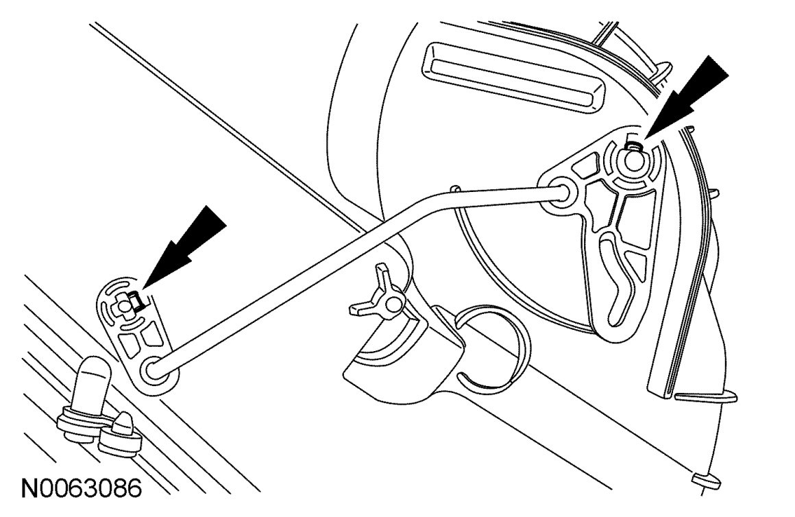

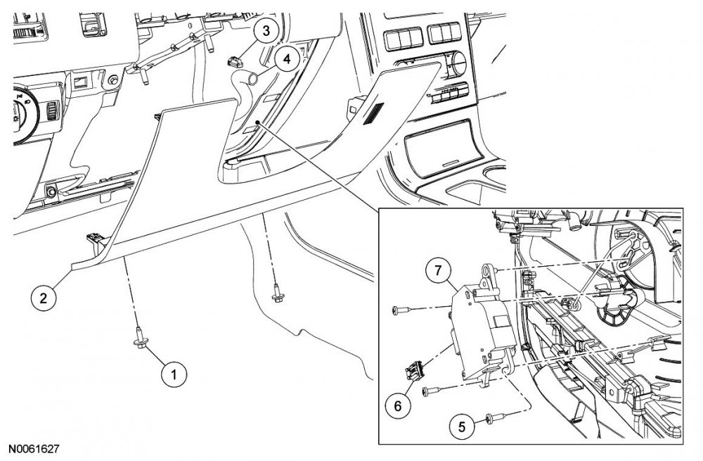

kecusc Posted December 6, 2023 Report Share Posted December 6, 2023 On 2/28/2023 at 8:43 PM, enigma-2 said: If car has EMTC (manual), the blend door module is connected to both doors on one shaft; and assume shaft is broken. Hi, I’m wondering if you (or anyone from this forum) knows how to access the shaft that you referenced on a manual, single-zone Unit? I believe this might be the issue on my 2008 Edge but don’t know how to verify or even access the shaft or doors. I can see the actuator moving but no change in temp. Trying to check this as a possible solution before replacing the heater core. Thank You! Quote Link to comment Share on other sites More sharing options...
Haz Posted December 7, 2023 Report Share Posted December 7, 2023 Welcome to the Forum, kecusc ! Document download links> Control Components - Climate Control Systems - Description and Operation - 2008 Edge Workshop Manual.pdf Climate Control - Temperature Blend Door Actuator — LH - Removal and Installation - 2008 Edge Workshop Manual.pdf Temperature Blend Door Actuator — LH - Enhanced Image #1 - 2008 Edge Workshop Manual.pdf Temperature Blend Door Actuator — LH - Enhanced Image #2 - 2008 Edge Workshop Manual.pdf Good luck! 1 Quote Link to comment Share on other sites More sharing options...
kecusc Posted December 8, 2023 Report Share Posted December 8, 2023 Thanks @Haz! Do you know if there is a way to access the actual blend door and not just the actuator? I’m wondering if in my case the door itself is the problem and not the actuator. Quote Link to comment Share on other sites More sharing options...
Haz Posted December 10, 2023 Report Share Posted December 10, 2023 (edited) No insights on the Blend Door(s) and operating shaft are provided in the Workshop Manual, unfortunately, though YouTube includes video of a Ford truck owner cutting a portion of its climate control housing to access a blend door needing repair, as an alternative to removing the entire housing from behind the dash. @WWWPerfA_ZN0W's recent advice on performing an actuator reset is worth a try. Document download links> Heater Core And Evaporator Core Housing - Removal and Installation - 2008 Edge Workshop Manual.pdf Heater Core - Removal and Installation - 2008 Edge Workshop Manual.pdf Temperature Blend Door Actuator - RH, Dual-Zone EATC - Removal and Installation - 2008 Edge Workshop Manual.pdf Good luck! Edited December 10, 2023 by Haz 1 Quote Link to comment Share on other sites More sharing options...
