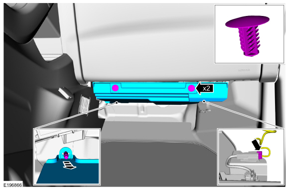

  1. Remove the push pins and the RH insulation panel. Disconnect the electrical connector.

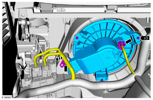

  1. Disconnect the electrical connector, detach the wiring harness retainer and position aside the harness. Remove the retainers and the blower motor.
