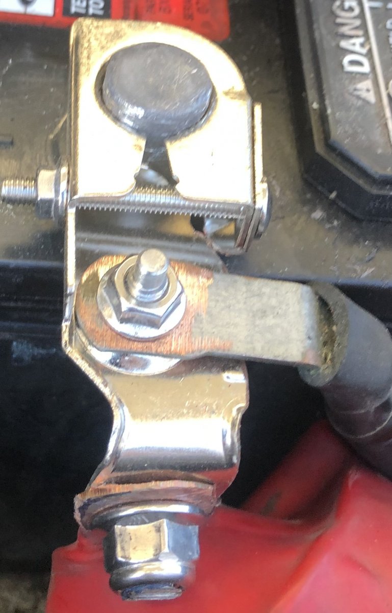

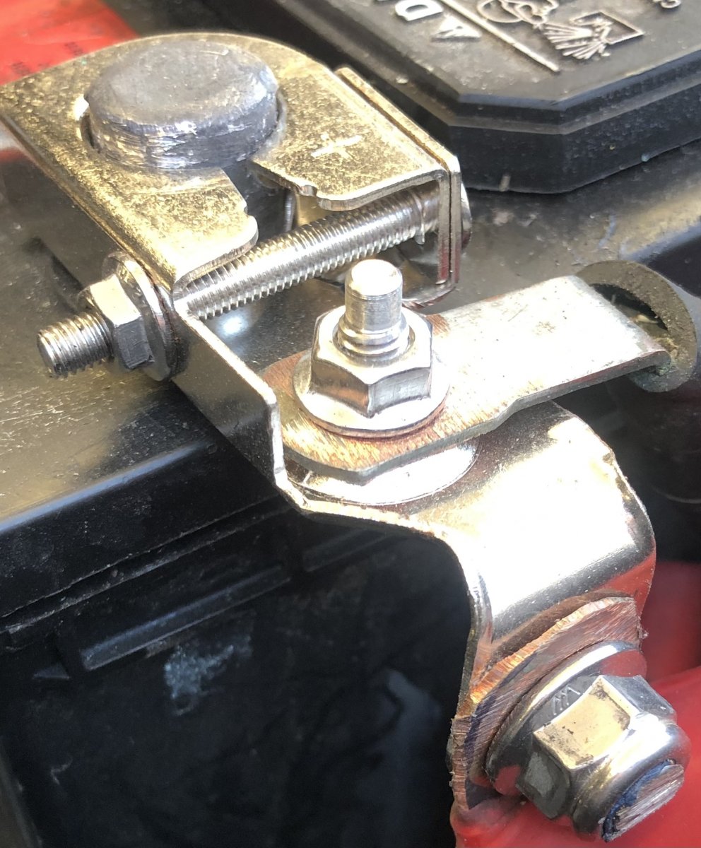

larry5476 Posted February 7, 2022 Report Share Posted February 7, 2022 On 1/31/2022 at 6:16 PM, rand said: sooooo, nobody has done this... dang.. well, I'll do it this weekend and take pics.... Expand I had just finished replacing the alternator, big pain in the butt by the way, and discovered a bad battery terminal. I was in no mood to start removing the obstacles required to replace whole cables so I used a Dorman 926-882 battery terminal and modified it a bit by removing one terminal. I then flattened and trimmed the OEM cable ends. This was around 15K miles ago and I haven’t had any problems. I hope this helps. I attempted to load images however the one failed and I’m not allowed to load another. I’ll try again after this posts. 2 Quote Link to comment Share on other sites More sharing options...
