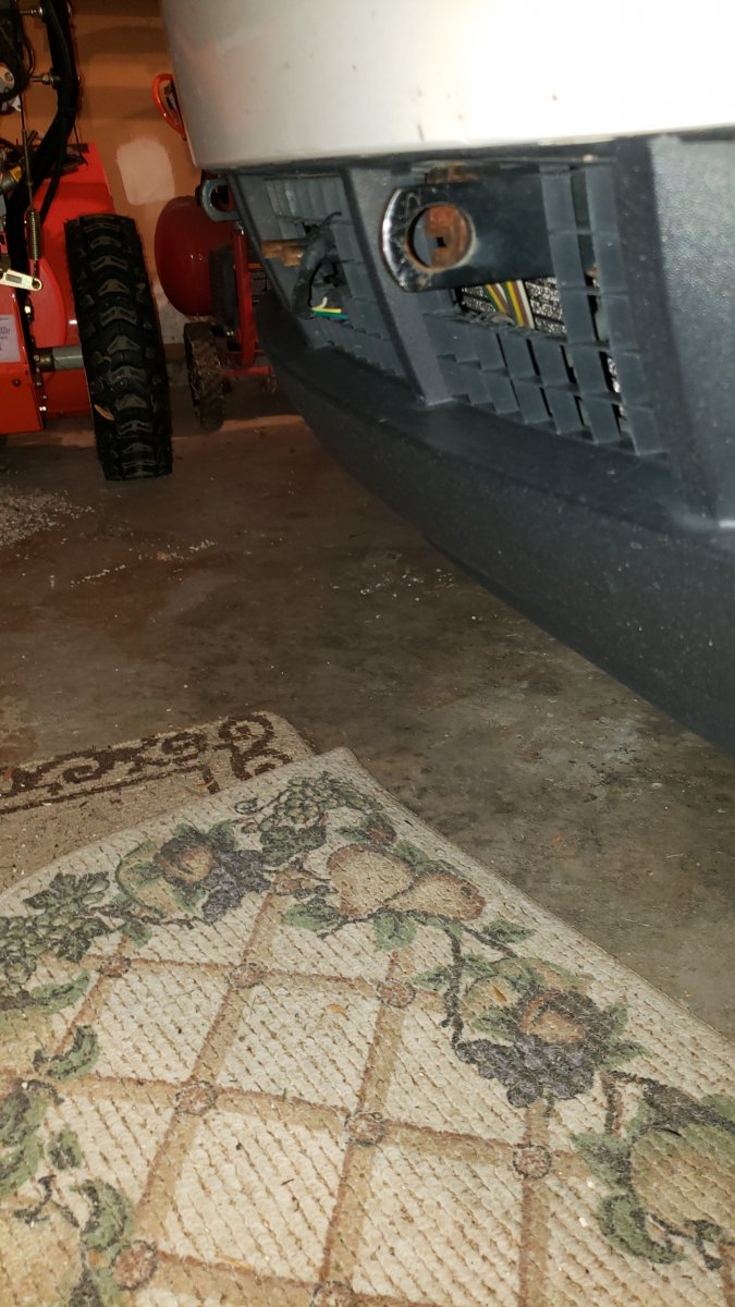

enigma-2 Posted January 21, 2022 Report Share Posted January 21, 2022 This is a pix of my 2009 MKX tow hooks. They had to cut out through the grill to install. It was a kit designed for towing car behind motor home. Perhaps something simular available for your car? Quote Link to comment Share on other sites More sharing options...

enigma-2 Posted January 27, 2022 Report Share Posted January 27, 2022 13 hours ago, BaZZaD said: How many cars I had, the first time I see that there would be no hook. I wonder what the manufacturer was thinking when he decided to abandon the hooks? If your car gets stuck somewhere, you can leave it forever. ))) The hooks installed by the OWM weren't for pulling a car from the snow or mud. They were for tying the car to the deck of a ship for overseas shipment. (In other words, necessity). The usualy reason for installing toe hooks aftermarket is to tow the car behind a motor home (not for pulling out of snow or mud when stuck). 1 Quote Link to comment Share on other sites More sharing options...
