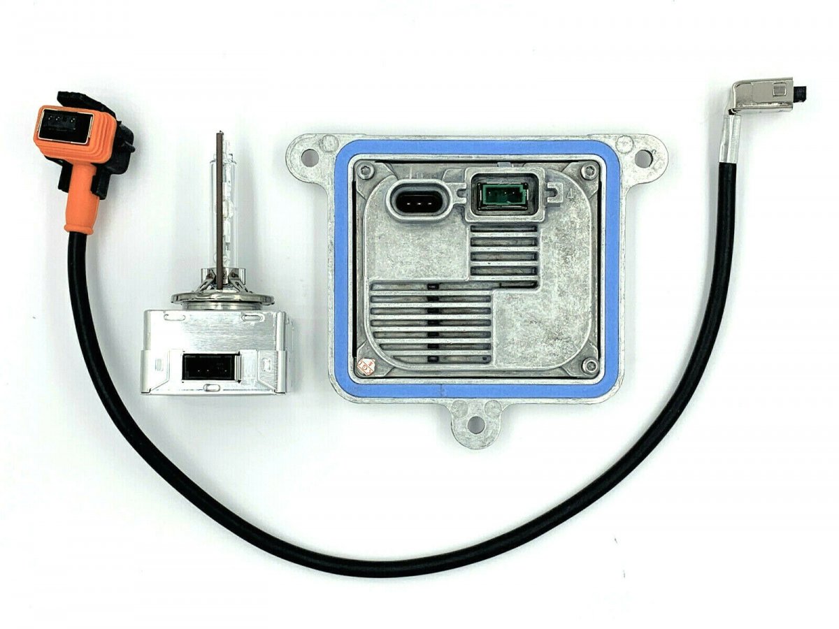

Our Edge has 125k on the ticker so I'm inclined to think that the original bulbs, at minimum were previously replaced at least once. I have not physically checked myself, but based on the performance, I'm assuming the ballasts are the stock 35 watt units. So I intended to resolve the issue with new D3S bulbs and upgrading the ballasts to 55 watt or better.  Seems simple enough, until I actually started looking for 55 watt ballasts, I cannot for the life of me find a single, DIRECT replacement, higher than stock (35 watt) ballasts any where.  I spoke with a tech at TheRetroFitSource.com and he told me that I would need to buy an entire conversion kit made for the halogen conversions in order to boost the ballast wattage, but I find this hard to believe.  Additionally, the factory HIDs mount the ballast on the underside of the housing and the ballast is used to seal the access point for the ballast connections, which are both INSIDE the housing.  (See attached images)  The aftermarket conversions all seem to have there connections made OUTSIDE the housing and they seem to be mounted away from the housings and not mounted on them which begs the question, how exactly are the ballast connections made without removing the original ballast and thus exposing inside the housing to the elements? Thus my posting here... Any input on this issue is requested!

First, this only relates to the 2015-2018 Edge, because 2019+ have better LED headlights and as far as know, both are considered Gen2. Although the OWM HID are far from great, what you are describing is not consistent with my experience of the OEM HID. I have a 2016 Sport also with the 401A package. I suspect something is wrong with your lighting. Bad bulbs, ballast, lens or projectors. Are you sure they are the OEM HID? Maybe the previous owner replaced for some reason.
For the 2015-2018 factory HID, I don't recall anyone upgrading them. The easiest way I assume would be to upgrade the HID bulbs. Like the "OSRAM XENARC Night Breaker Laser D3S" or "PHILIPS Xenon X-TremeVision Gen2 +150% D3S". If you still want to go with external connections, maybe just keep the original ballast to seal the housing and then make all connection external like a retrofit solution.

 I'm guessing that the weak performance of these HIDs is likely due to their age.  They clearly fire up very bright, but then quickly tune down once they have started.  Not sure if that is indicative of tired bulbs or ballasts or both, I'm learning HIDs as I go.  Like I mentioned, I have not dug into the lights yet, it's been ridiculously cold in MN the past couple weeks, but I will soon in order to determine what hardware is indeed installed currently.  I appreciate the recommendations, I've read quite a bit about both the Night Breakers and XtremeVisions, but coming from halogen equipped cars, I find $200+ for bulbs less than palatable and likely only a serious last resort option and despite the numerous videos out there showing increases in brightness with the Night Breaker in particular, I find it hard to believe the bulbs by themselves can increase brightness without boosting the power feeding them.  But again, I'm learning HIDs as I go.  TBH I am puzzled that there seem to be zero direct replacement ballasts over 35 watts for the Ford applications.  I would think the market for 55w+ direct replacement ballasts would be a sound one.
