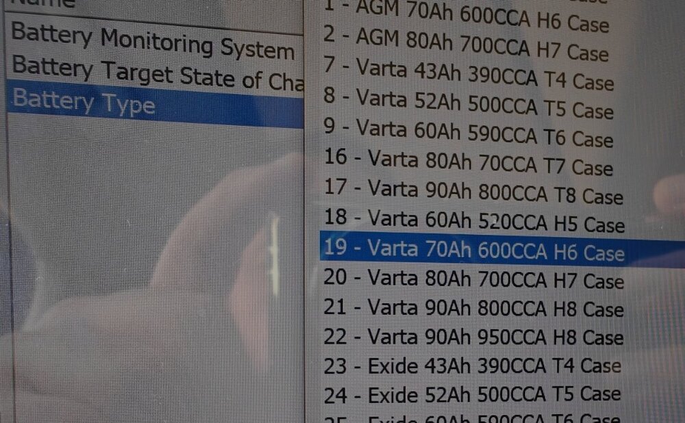

1004ron Posted December 13, 2024 Report Share Posted December 13, 2024 (edited) Thanks @omar302 This morning when I connected my laptop to change the battery config as you suggested above, and it was taking me longer to get Forscan to communicate with the OBDLink MX+ and with that I got the battery low warning, and that's after it was on the tender overnight. Decided its time for a new one, so the quickest was to buy one from Walmart - I got the H6 AGM Platinum for $178.00 - it gets good reviews online. The Interstate H6 bought from Costco lasted 3 years and 1 month, just out of warranty. With the new battery installed I first changed the type as above and then did a BMS reset. Note that the new AGM is 3kg (6.6 lb) heavier than the previous one. I paid the $12 for a years subscription to Forscan - feel it well worth it and the developers most certainly deserve the support. . Edited December 13, 2024 by 1004ron 4 Quote Link to comment Share on other sites More sharing options...

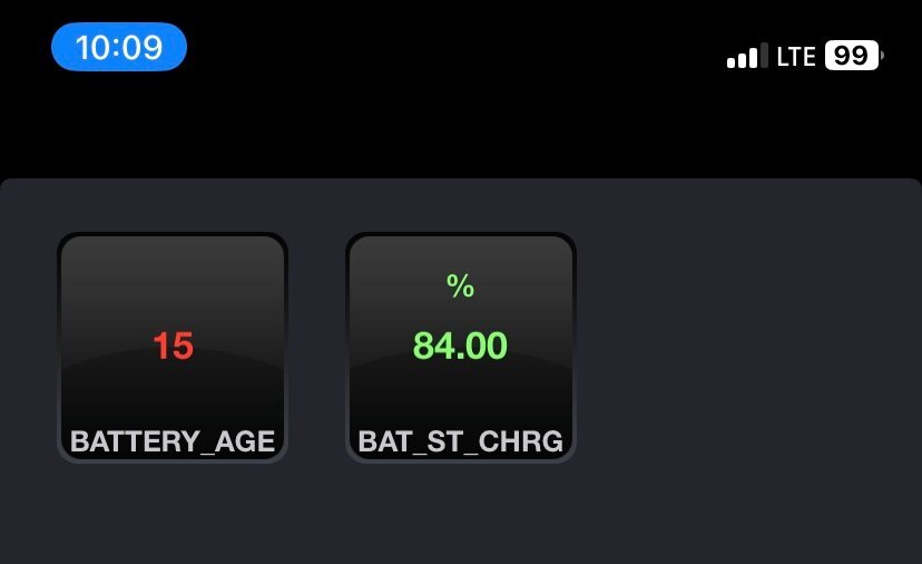

1004ron Posted December 15, 2024 Report Share Posted December 15, 2024 omar302 Could you tell me exactly which PID value you were looking at for the battery state of charge, and if this is only available in Forscan full version or also on Forscan Lite. I used my iPhone and Forscan Lite to access what I think was the battery charge state. Also keen to know if there's any specific BMS selection better suited to the AGM. I won't be able to check it for two weeks - its parked at the airport while I'm in Korea. Got a fantastic rental, a G80 Genesis - fantastic luxury car. 1 Quote Link to comment Share on other sites More sharing options...
omar302 Posted December 16, 2024 Author Report Share Posted December 16, 2024 On 12/15/2024 at 3:25 AM, dabangsta said: Are we talking about an iPhone or an Edge? It charges at a much higher rate than 12.8v, and will be 14.xxv until any little load is put on it. 80% of an AGM battery is 12.25v The Edge, the model sold by the car company "Ford Motor Company". At least since 2011 Ford has used this strategy, the main benefit is to reduce fuel consumption by reducing load from the alternator when charging is not required. This can even be seen by monitoring the voltage output of the alternator. 15 hours ago, 1004ron said: omar302 Could you tell me exactly which PID value you were looking at for the battery state of charge, and if this is only available in Forscan full version or also on Forscan Lite. I used my iPhone and Forscan Lite to access what I think was the battery charge state. Also keen to know if there's any specific BMS selection better suited to the AGM. I won't be able to check it for two weeks - its parked at the airport while I'm in Korea. Got a fantastic rental, a G80 Genesis - fantastic luxury car. I am using ForScan lite (Android). The PID is "BdyCM.BAT_ST_CHRG", see screenshot attached. As for AGM selection, seeing how I probably was wrong before, I wouldn't follow the F150 sheet. However, since an Edge with auto-start stop does have an AGM from the factory, maybe use the ABD from that? Checking VINs of Edges online, a 2016 Edge SE FWD that has Auto-Start stop has "01" in the battery type. So does a 2023 Edge ST that has Auto-Start stop. (As per the the F150 sheet this correspondences to BAGM-48H6-760 70Ah 760CCA, which is the stock Edge battery with Auto-Start stop). 4 Quote Link to comment Share on other sites More sharing options...
1004ron Posted December 16, 2024 Report Share Posted December 16, 2024 Thanks omar302 Checking the screenshot on my phone, it looks like I had the correct PID, now to check this again in two weeks when I return from my trip abroad. 2 Quote Link to comment Share on other sites More sharing options...
1004ron Posted December 29, 2024 Report Share Posted December 29, 2024 On 12/14/2024 at 2:20 AM, omar302 said: Probably because it is still new (fully charged). It should eventually go to 80% and then stay around that since that's the set charge limit. You are correct, as usual. The battery age reported is correct at 15 days, and the state of charge is 84% 14 of the 15 days was spent in the airport surface parking lot. I haven't looked at changing the code to suit the AGM, and might just leave it where its at. 2 Quote Link to comment Share on other sites More sharing options...

kruzr1 Posted February 24 Report Share Posted February 24 Been having the symptoms of a dying battery lately. Changed the original 2 years ago. Thought I would check the battery configuration in forscan. It has the correct battery type selected as an AGM H6, but in the CCA it shows 600CCA, there is no selection for an AGM H6 760CCA. My battery has 760CCA, same as original battery. Is this going to make a difference in the charging or longevity of the battery? 1 Quote Link to comment Share on other sites More sharing options...
Wubster100 Posted February 25 Report Share Posted February 25 1 hour ago, kruzr1 said: It has the correct battery type selected as an AGM H6, but in the CCA it shows 600CCA, there is no selection for an AGM H6 760CCA. My battery has 760CCA FORScan values are not always 100% accurate. Do not change your battery type in FORScan. Quote Link to comment Share on other sites More sharing options...
