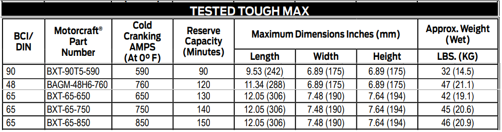

omar302 Posted October 25, 2021 Report Share Posted October 25, 2021 As per the title, anyone tried installing a Group 65 Battery in a 2nd Gen Edge? Specifically the Motorcraft BXT-65-650? Price wise it is close to the stock (BXT-90T5-590 in my Edge) but has much more Reserve Capacity. The other battery specified for the 2nd Edge (BAGM-48H6-760) is 2-3X more expensive here. I know it is bigger than the stock battery (BXT-90T5-590 or BAGM-48H6-760), comparison is attached. For the earlier 1.5 Gen, both would fit. 2 Quote Link to comment Share on other sites More sharing options...
WWWPerfA_ZN0W Posted October 25, 2021 Report Share Posted October 25, 2021 i believe it is possible but will be tough to get in and out, snuck under the cowling as far as it is. h7 would be a more apt comparison. pretty sure you would want to remove the cowling and the airbox for this one to bolt it into place. 2 Quote Link to comment Share on other sites More sharing options...

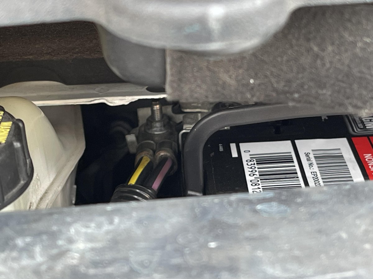

my2k2zx2 Posted October 26, 2021 Report Share Posted October 26, 2021 (edited) H7 does fit, put one in our 2016 earlier this year. I removed the air filter box lid and moved the ground wire out of the way to install. I did not have to remove the cowling to fit. The battery tray has threaded holes for 3 different sized batteries, but is not mentioned in any documentation. If you look up the battery on parts.ford.com it shows 90T5, H6 and H7 as compatible options. I found that after the parts store in town only showed the stock battery size and it was special order only. https://imgur.com/EFRbtXS Edited October 26, 2021 by my2k2zx2 6 Quote Link to comment Share on other sites More sharing options...

omar302 Posted October 27, 2021 Author Report Share Posted October 27, 2021 Thanks to all. My problem is that we don't have many choices for batteries here. The BXT-65-650 being more common is actually cheaper than the BXT-90T5-590. Hence my desire to use that, being cheaper, bigger & easier to find. 3 Quote Link to comment Share on other sites More sharing options...

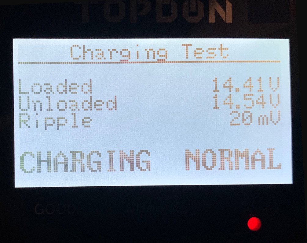

1004ron Posted November 14, 2021 Report Share Posted November 14, 2021 (edited) The only sign I've experienced that would suggest the battery on my Sport that I bought in March 2017 is nearing end of life is the warning I get with the ignition on ACC after just a couple of minutes. The resting voltage after a drive home from work is only 12.03 v. I'd say this original 590 CCA has served me well, so I question whether there's any benefit in going up one size, or paying $65 more for an AGM - I don't want to remove my air filter box to get the battery installed. I'm considering the Interstate from Costco at $100. Edited November 14, 2021 by 1004ron 3 Quote Link to comment Share on other sites More sharing options...

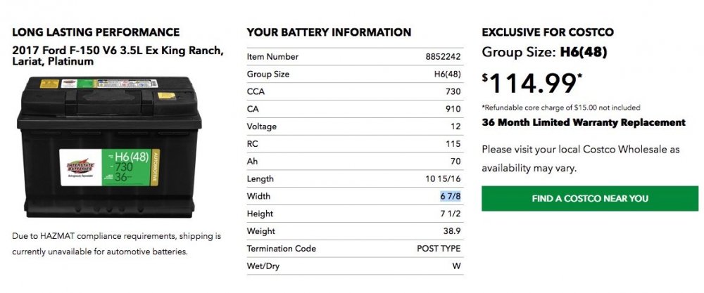

omar302 Posted November 15, 2021 Author Report Share Posted November 15, 2021 On 11/14/2021 at 11:34 PM, 1004ron said: I'd say this original 590 CCA has served me well, so I question whether there's any benefit in going up one size, or paying $65 more for an AGM - I don't want to remove my air filter box to get the battery installed. Expand For me, we we have short driving cycles hence the benefit of a larger battery, As for the 65, its because it is actually cheaper here, so it seemed like a win-win. However, I found out that the battery terminals are on opposite sides meaning the fit will also require re-arranging the wiring. Will see if it is possible once my battery actually dies. 3 Quote Link to comment Share on other sites More sharing options...

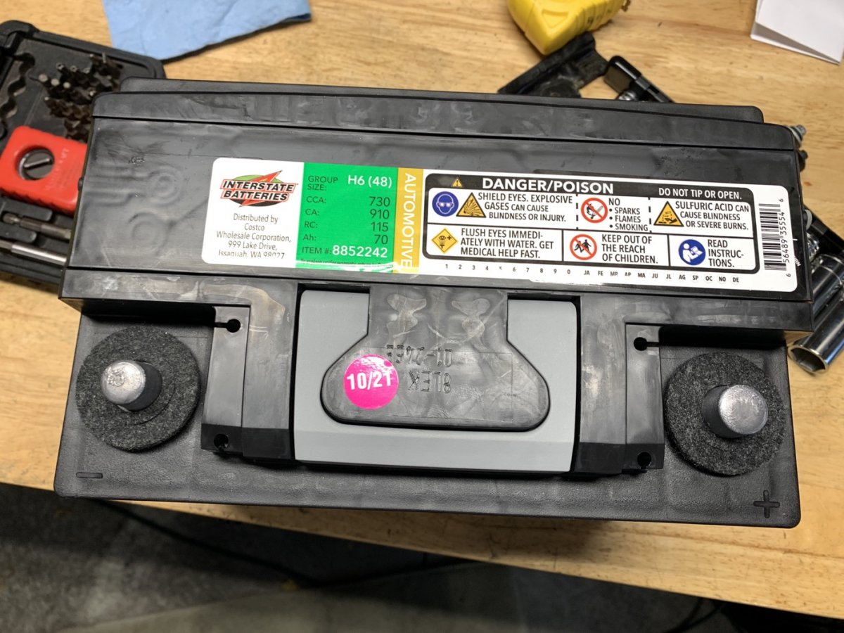

1004ron Posted November 15, 2021 Report Share Posted November 15, 2021 (edited) I went one size up, the Costco Interstate H6 (48) and it fits with ease and only $15 more than the T5. Charging it now, and will then reset the BMS using Forscan. Edited November 15, 2021 by 1004ron 4 Quote Link to comment Share on other sites More sharing options...

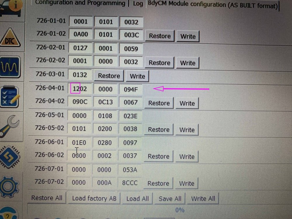

1004ron Posted November 16, 2021 Report Share Posted November 16, 2021 On 11/16/2021 at 5:48 AM, omar302 said: Maybe also consider changing the battery type/size in ForScan for the bigger battery. Expand Thanks for the reminder. What do you suggest - should I use code "0E" ? 1 Quote Link to comment Share on other sites More sharing options...
1004ron Posted November 16, 2021 Report Share Posted November 16, 2021 (edited) Done. Battery Type/Size changed, BMS reset, new negative battery connector and felt protectors on terminals. https://www.amazon.com/gp/product/B07PVX1K2N/ref=ppx_yo_dt_b_search_asin_title?ie=UTF8&psc=1 https://www.amazon.com/gp/product/B001DKUTR0/ref=ppx_yo_dt_b_search_asin_title?ie=UTF8&psc=1 Original Battery New battery type/size - 730 CCA BMS reset Edited November 16, 2021 by 1004ron 4 Quote Link to comment Share on other sites More sharing options...
omar302 Posted November 16, 2021 Author Report Share Posted November 16, 2021 On 11/16/2021 at 12:59 PM, 1004ron said: Thanks for the reminder. What do you suggest - should I use code "0E" ? Expand CCA matches the Motorcraft H7 (ABD "OE" as you stated), but RC is closer to the Motorcraft BXT-48H6-610. Given that this battery is a direct replacement to the stock F-150 (standard 3.5L) which uses the Motorcraft BXT-48H6-610, I'd go "0C" or "0D". The first F-150 with the standard V6 I found on eBay I just checked has "0D". 3 Quote Link to comment Share on other sites More sharing options...

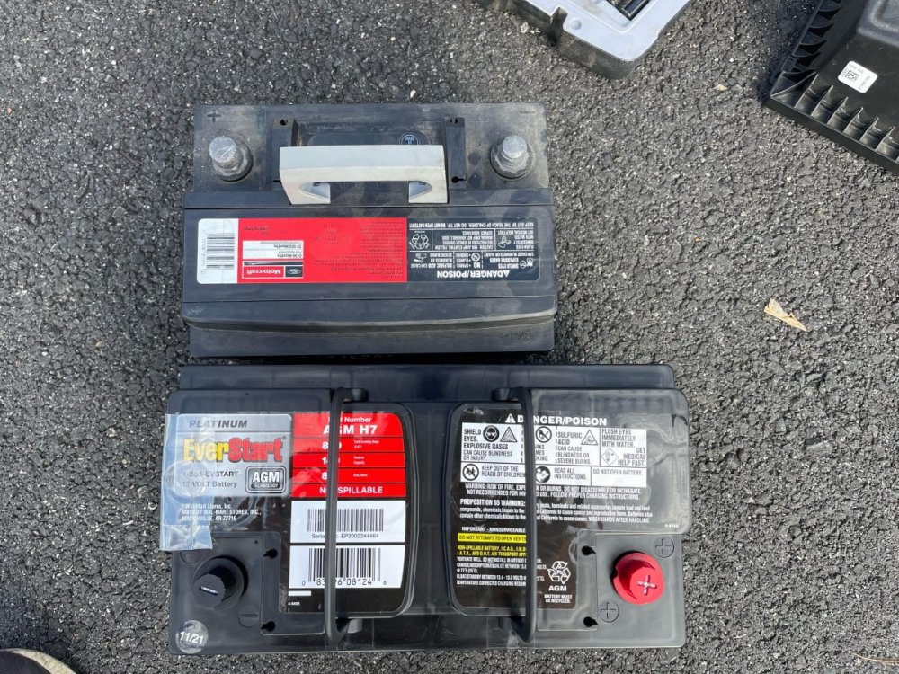

Cerberus Posted December 20, 2021 Report Share Posted December 20, 2021 On 10/26/2021 at 2:08 PM, my2k2zx2 said: H7 does fit, put one in our 2016 earlier this year. I removed the air filter box lid and moved the ground wire out of the way to install. I did not have to remove the cowling to fit. The battery tray has threaded holes for 3 different sized batteries, but is not mentioned in any documentation. If you look up the battery on parts.ford.com it shows 90T5, H6 and H7 as compatible options. I found that after the parts store in town only showed the stock battery size and it was special order only. https://imgur.com/EFRbtXS Expand This was very helpful, Thank You I went to Wallyworld and grabbed an AGM H7, shoe horned it in there with a pry bar or two and away we go ? Quote Link to comment Share on other sites More sharing options...
Cerberus Posted December 20, 2021 Report Share Posted December 20, 2021 On 11/16/2021 at 5:48 AM, omar302 said: Now that's an auto enthusiast. Have to improve on stock ?. Maybe also consider changing the battery type/size in ForScan for the bigger battery. Expand soo.. i have to ask, since i just installed an AGM H7 with 850CCA, what will change by telling the computer there is a higher CCA and different type battery present? I mean do the charging algorithms change to voltages for bulk charging versus float? Interestingly, my old battery (FoMoCo 590CCA) was either original or the battery life counter was never reset if it was changed.. it showed an age of over 2000 days.. I have not done any playing with editing of data bits with forscan, just data acquisition, so I am leery of changing anything, probably because i'm a virgin.. its always more nerve wracking the first time. Quote Link to comment Share on other sites More sharing options...
omar302 Posted December 20, 2021 Author Report Share Posted December 20, 2021 On 12/20/2021 at 4:04 AM, Cerberus said: soo.. i have to ask, since i just installed an AGM H7 with 850CCA, what will change by telling the computer there is a higher CCA and different type battery present? I mean do the charging algorithms change to voltages for bulk charging versus float? Expand The general consensus is that the charging "algorithms" are different between AGM & FLA batteries and the ForScan change would set up the vehicle to charge correctly based on the type of battery. Also, the battery capacity info would mean the vehicle charges to the correct percentage (80%) as the charging system is designed to charge to 80% only for extended battery life and then would stop charging when not needed to reduce wasted energy from over charging hence reducing fuel consumption. 1 Quote Link to comment Share on other sites More sharing options...
Cerberus Posted December 20, 2021 Report Share Posted December 20, 2021 On 12/20/2021 at 7:35 AM, omar302 said: The general consensus is that the charging "algorithms" are different between AGM & FLA batteries and the ForScan change would set up the vehicle to charge correctly based on the type of battery. Also, the battery capacity info would mean the vehicle charges to the correct percentage (80%) as the charging system is designed to charge to 80% only for extended battery life and then would stop charging when not needed to reduce wasted energy from over charging hence reducing fuel consumption. Expand Ok, that is the opposite of everything I know and have read about lead acid batteries. Lithium ion batteries cycle life is significantly increased by only charging to 80% of full, but lead acid requires top up with equalizing voltage of 14.6 or better at least once a month to avoid early sulfation and loss of capacity. They don't like to be deeply discharged for sure, that ruins them too but they prefer 95% plus charging most of the time, and require top up occasionally. Quote Link to comment Share on other sites More sharing options...
