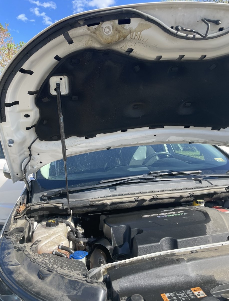

jvuckovic17 Posted June 20, 2022 Report Share Posted June 20, 2022 Just looking for some help with the p1450 error code on my 2018 Edge sport. I purchased the wrong part and was just wondering if anyone knew the right part i need. Car struggles to start after I've refueled it. Eventually it starts but i want to get rid of the check engine light. Everything points to the fuel (vapour) evaporator. Just wondering if anyone has a picture of what part i need for my car. Thanks in advance. Quote Link to comment Share on other sites More sharing options...
bscott94 Posted June 20, 2022 Report Share Posted June 20, 2022 12 hours ago, jvuckovic17 said: Just looking for some help with the p1450 error code on my 2018 Edge sport. I purchased the wrong part and was just wondering if anyone knew the right part i need. Car struggles to start after I've refueled it. Eventually it starts but i want to get rid of the check engine light. Everything points to the fuel (vapour) evaporator. Just wondering if anyone has a picture of what part i need for my car. Thanks in advance. The PDF from the comment below has a good diagram showing the part. I ordered my part off of Rock Auto. I picked my car and it showed me the correct parts. I think it was around $50 On 7/13/2019 at 12:43 AM, omar302 said: @Scott98 See the attached if it helps. Evaporative Emission Canister Purge Valve 27l.pdf 1 Quote Link to comment Share on other sites More sharing options...
jvuckovic17 Posted June 25, 2022 Report Share Posted June 25, 2022 So i got the part and installed it but I still have a check engine light on. Does anyone know of anything else that needs to be replaced? Thanks in advance. Or does the code need to be cleared first? Quote Link to comment Share on other sites More sharing options...
1004ron Posted June 25, 2022 Report Share Posted June 25, 2022 53 minutes ago, jvuckovic17 said: So i got the part and installed it but I still have a check engine light on. Does anyone know of anything else that needs to be replaced? Thanks in advance. Or does the code need to be cleared first? If the light is staying on, then no point in clearing codes - check the codes and if its still the same evap code then you have other issues with the evap system, like the canister in the rear. Quote Link to comment Share on other sites More sharing options...
jvuckovic17 Posted June 25, 2022 Report Share Posted June 25, 2022 The canister in the rear. Can you get to it easily or does the tank need to come off? Any chance you might know the part number? Thanks in advance. Quote Link to comment Share on other sites More sharing options...
1004ron Posted June 26, 2022 Report Share Posted June 26, 2022 3 hours ago, jvuckovic17 said: The canister in the rear. Can you get to it easily or does the tank need to come off? Any chance you might know the part number? Thanks in advance. Do you still have the symptoms "Car struggles to start after I've refueled it. " ? Hopefully @Haz can assist with that. My dealerships service manager told me the most often the evap valve is the cure, but they have also found the same code to be a problem with the canister in the rear. Once you have it resolved, to avoid this happening again never top-off your tank - stop the first time the pump shuts off. Quote Link to comment Share on other sites More sharing options...
jvuckovic17 Posted June 26, 2022 Report Share Posted June 26, 2022 13 hours ago, 1004ron said: Do you still have the symptoms "Car struggles to start after I've refueled it. " ? Hopefully @Haz can assist with that. My dealerships service manager told me the most often the evap valve is the cure, but they have also found the same code to be a problem with the canister in the rear. Once you have it resolved, to avoid this happening again never top-off your tank - stop the first time the pump shuts off. Yes i still have the symptoms. I think my issue is with the canister in the rear. Just locating it and finding the correct part number might be the challenge. Quote Link to comment Share on other sites More sharing options...
Haz Posted June 26, 2022 Report Share Posted June 26, 2022 (edited) jvuckovic17: Below are relevant sections from 2018 Edge Workshop Manual, and from 2018 Gasoline Powertrain Control- Emission Diagnosis Manual, relating to potential causes of P1450 Diagnostic Trouble Code, Diagnostic Pinpoint Test HX, and other procedures, diagrams, and details, provided as PDF download links and images... Good luck! PINPOINT TEST HX - EVAPORATIVE EMISSION (EVAP) SYSTEM AND MONITOR - 2.7L Ecoboost - 2018 PC-ED Manual.pdf Evaporative Emissions - Overview - 2.7L EcoBoost - 2018 Edge Workshop Manual.pdf Evaporative Emissions - System Operation and Component Description - 2018 Edge Workshop Manual.pdf Evaporative Emission Canister - Removal and Installation - 2.7L EcoBoost - 2018 Edge Workshop Manual.pdf Evaporative Emission Canister Ventilation Filter - Removal and Installation - 2.7L EcoBoost - 2018 Edge Workshop Manual.pdf Evaporative Emission Canister Vent Solenoid - Removal and Installation - 2.7L EcoBoost - 2018 Edge Workshop Manual.pdf Fuel Tank Pressure Sensor and Tube - Removal and Installation - 2.7L EcoBoost - 2018 Edge Workshop Manual.pdf Fuel Tank - Removal and Installation - 2.7L EcoBoost - 2018 Edge.pdf EVAP Components Wiring Diagram - 2.7L EcoBoost - 2018 Edge Workshop Manual.pdf EVAPORATIVE EMISSION (EVAP) CANISTER VENT VALVE - Connector C450 Details - 2018 Edge Workshop Manual.pdf EVAPORATIVE EMISSION (EVAP) PURGE VALVE - Connector C1029 Details - 2018 Edge Workshop Manual.pdf Evaporative Emission Canister Purge Valve - Removal and Installation - 2.7L EcoBoost - 2018 Edge Workshop Manual.pdf Powertrain Control Module (PCM) - Removal and Installation - 2018 Edge Workshop Manual.pdf POWERTRAIN CONTROL MODULE (PCM) Connector C1551B Details - 2018 Edge Workshop Manual.pdf You may input your Edge's VIN into the factory FordParts.com site to determine which Vapor Canister is appropriate for your vehicle, and/or contact them via telephone, or inquire at your local dealership Parts counter, or via your preferred online parts seller ... Edited June 26, 2022 by Haz 2 Quote Link to comment Share on other sites More sharing options...
