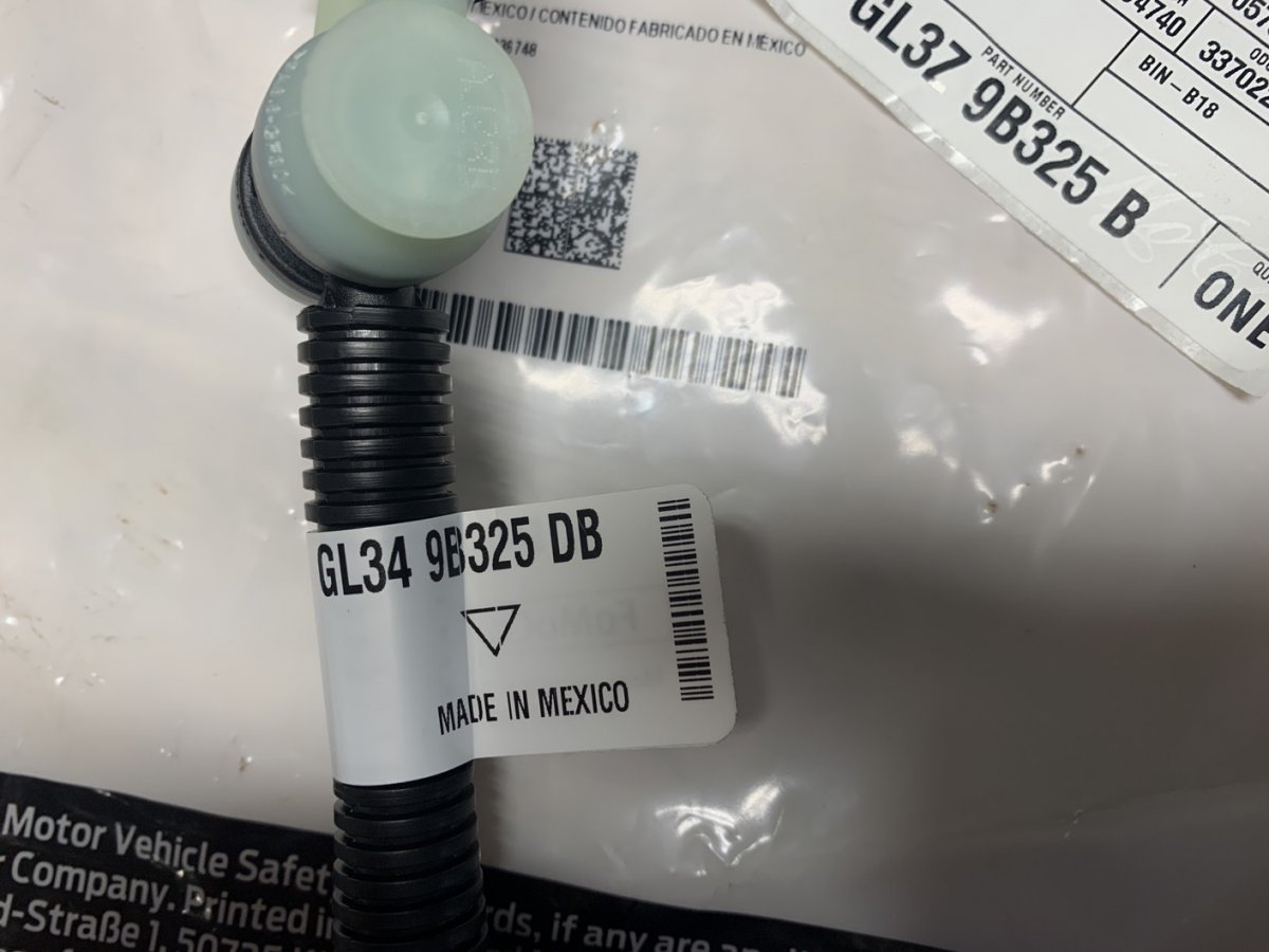

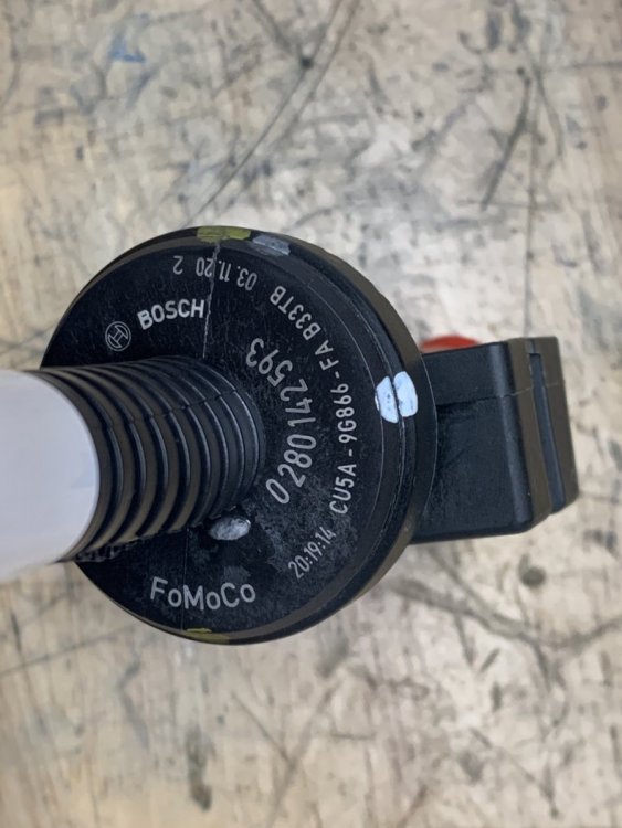

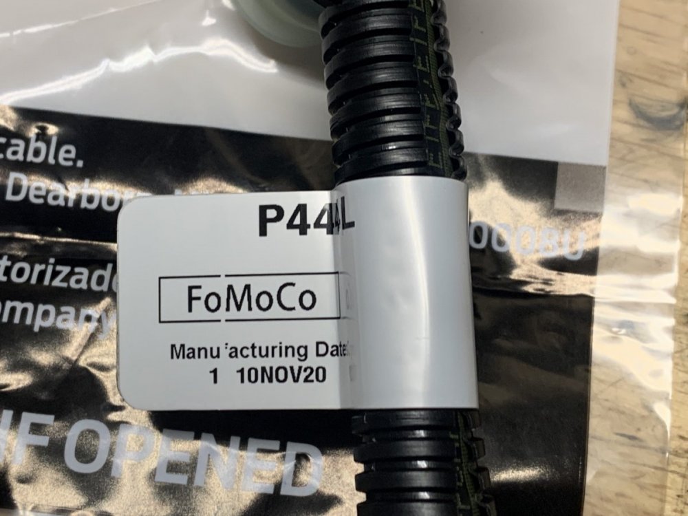

shumax Posted October 17, 2021 Author Report Share Posted October 17, 2021 What's confusing to me is that the packaging that 1004Ron shows indicates a part number of gl37 9b325 b. But, the actual part shows gl34 9b325 db. So, yea - which is it? HAHA... Quote Link to comment Share on other sites More sharing options...
1004ron Posted October 18, 2021 Report Share Posted October 18, 2021 (edited) I can't explain the part numbers, but can confirm the new part is working - I've only filled up once and no spluttering at idle, and just scanned it and confirm no codes. It had got progressively worse and would skip a beat when idling whenever the tank was above 3/4. If I ever need this part again, I'll buy only the Bosch valve. Edited October 18, 2021 by 1004ron 3 Quote Link to comment Share on other sites More sharing options...
WWWPerfA_ZN0W Posted October 19, 2021 Report Share Posted October 19, 2021 sometimes the p/n on the box and on the part are not in sync. have seen it happen a few times over the years. ford doesnt want to pay to update the packaging i guess. the p/n on the part should always be the updated one tho. Quote Link to comment Share on other sites More sharing options...
