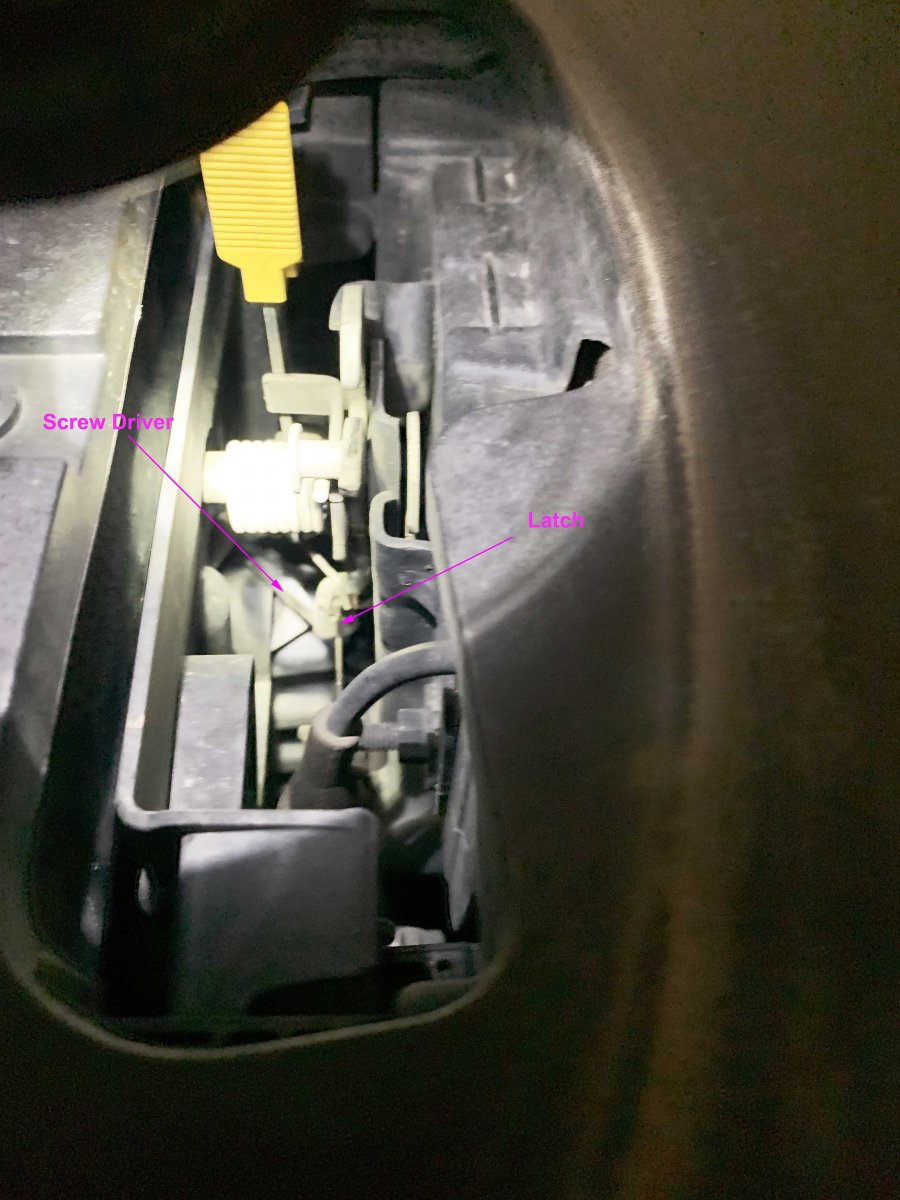

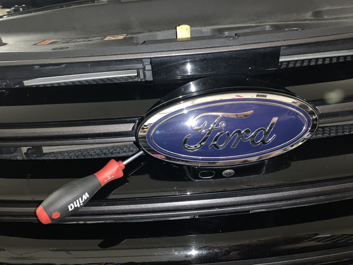

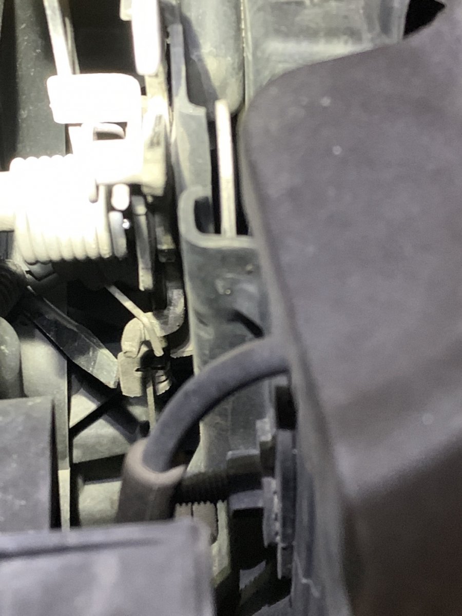

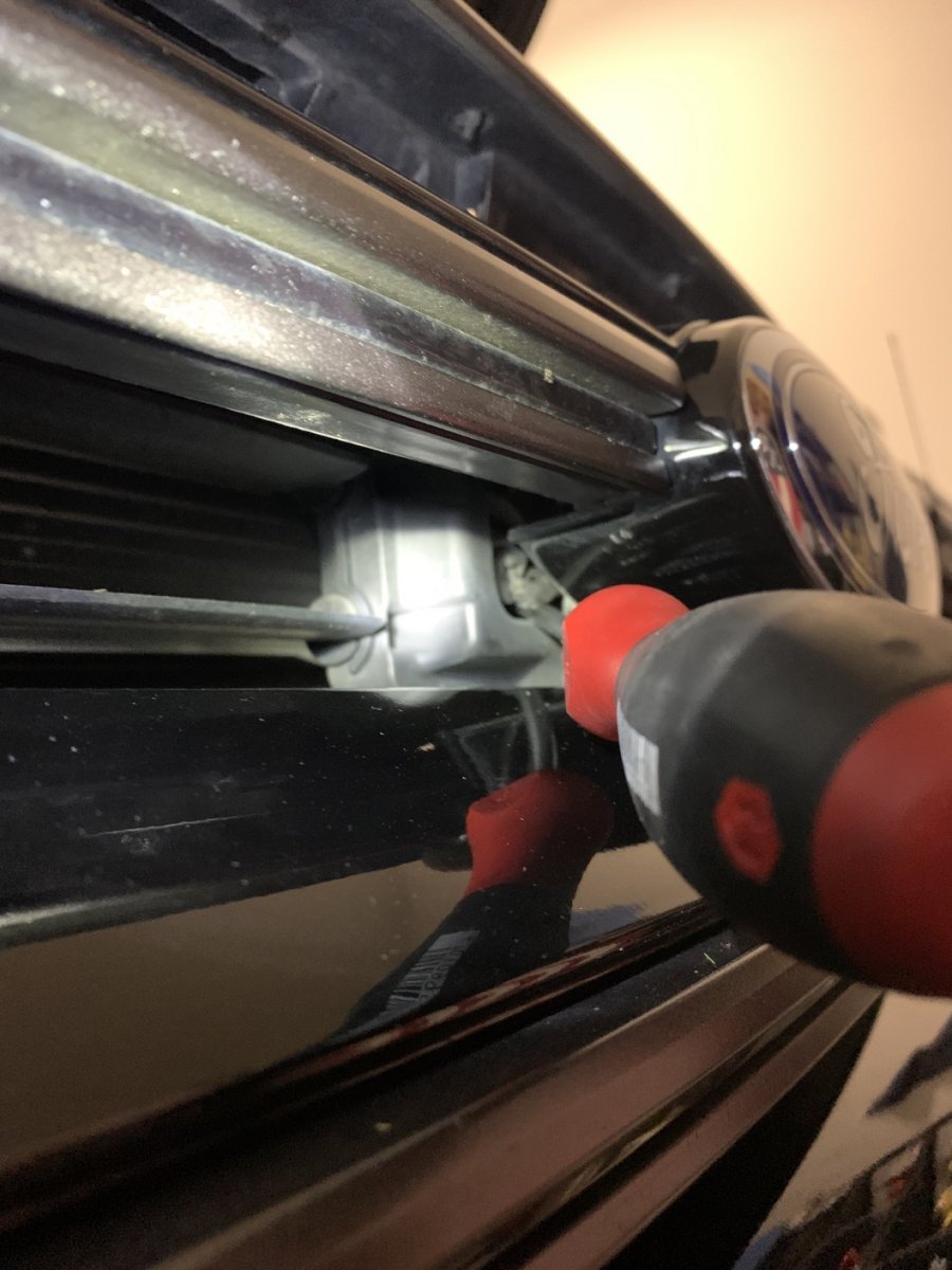

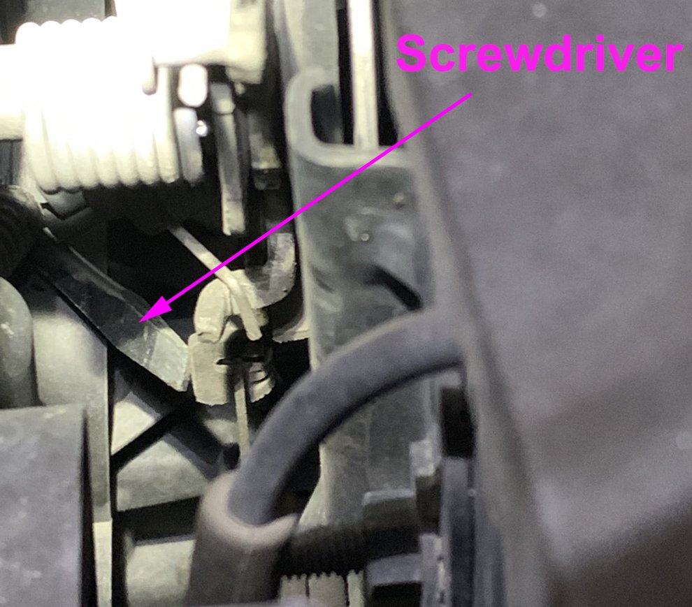

1004ron Posted October 10, 2021 Report Share Posted October 10, 2021 (edited) @enigma-2 ours isn't similar to that. The grill badge and camera are directly in front of the latch and it cannot be seen even using a flashlight. The attached photos will give you an idea where to prod with a long screwdriver - I was able to get it open, but had the benefit of seeing the exact location of the latch. One of those inspection cameras would help a lot. Edited October 10, 2021 by 1004ron 3 Quote Link to comment Share on other sites More sharing options...
