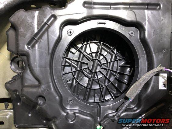

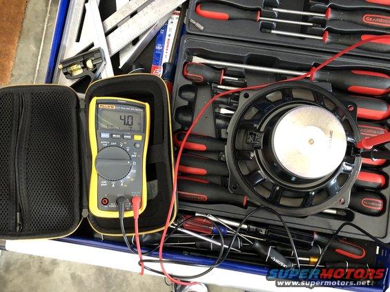

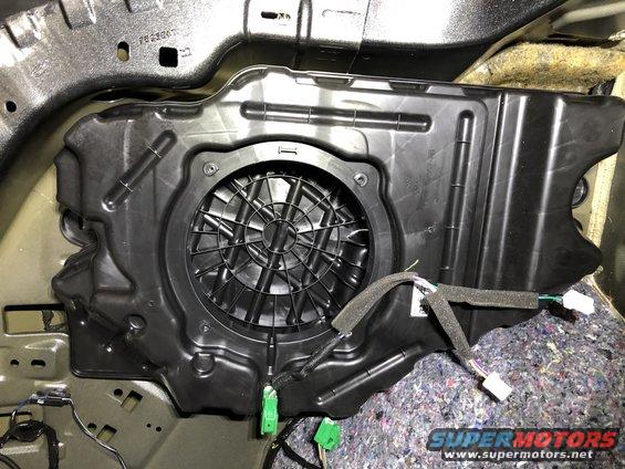

chipdog4 Posted July 24, 2022 Report Share Posted July 24, 2022 (edited) I'll be upgrading my 2019 Bang & Olufsen sub in the near future. Wanted to check out what was in there currently. It's a dual voice coil. Measure 4 ohms. The mounting depth is very shallow 3 1/2" This box looks to be easier to modify for a slightly deeper sub than the 15-18 Sony enclosure with the molded nub behind the sub. Here's a photo of the 15-18 Sony enclosure Here's the 19-22 B&O enclosure. (picture rotated on me) The reinforcement webbing could be sanded down for a deeper sub (probably get a 1/4" and a then quite a few more subwoofer choices.) Dual voice coil, 4 ohms each The subs above will work, in the 4 ohm version. Kicker 48CWRT84 https://www.crutchfield.com/p_20648CT84/Kicker-48CWRT84.html?tp=111 Rockford Fosgate P3SD4-8 https://www.crutchfield.com/p_575P3SD48/Rockford-Fosgate-P3SD4-8.html?tp=111 MB Quart DS1-204 https://www.amazon.com/MB-Quart-DS1-204-400-Watt-Subwoofer/dp/B010X424Q0/ref=sr_1_1?crid=2BGSS0ETWYEHI&keywords=DS1-204&qid=1658697712&sprefix=ds1-204%2Caps%2C167&sr=8-1&th=1 Edited July 24, 2022 by chipdog4 Quote Link to comment Share on other sites More sharing options...

chipdog4 Posted July 28, 2022 Report Share Posted July 28, 2022 (edited) 3 hours ago, enigma-2 said: Aren't the OE subs 2 ohms? The 2015-2018 Sony subwoofers probably were, but everything I could find for the newer B&O subs in other Fords said they were 4 ohms. So I measured mine to make sure. And I went ahead and bought one of the MB Quart subs. Not sure when I'll get around to installing it. Edited July 28, 2022 by chipdog4 Quote Link to comment Share on other sites More sharing options...

enigma-2 Posted January 22, 2023 Report Share Posted January 22, 2023 On 1/19/2023 at 1:11 PM, chipdog4 said: I removed the factory sub and installed the MB Quart 8". Not a huge difference in sound. I can feel the bass a little more and there's no distortion at any volume. Was it worth the $60 and the time to install it? Possibly The 2-ohm coil will deliver high sound output (2 ohm draws more current than 4-ohms), but may distort at high volume (depending on quality). The one in my 09 MKX with THX doesn't distort). A 4-ohm speaker isn't as loud (after all it draws 1/2 the current as a 2-ohm) but it also won't distort at high volumes. A lot has to do with the design of the amp. Usually if the amp and speaker are designed as a matching pair there shouldn't be any problems. As the speakers are rated in impedance and not resistance, you can't measure it by ohming it with a VOM. Quote Link to comment Share on other sites More sharing options...

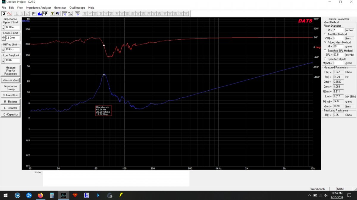

Edge_u_Cational Posted March 20, 2023 Report Share Posted March 20, 2023 (edited) so, added about 10lbs of mass with some killmat to the exterior covered the outer rear with closed cell foam so it compressed to the body when bolted in added some stuffing. bass now set to 0 for my taste [was at +3] it's pretty good now. the enclosure doesn't resonate and that's a good thing. all that energy is now bass output here is the impedance sweep and T/S measurements of the driver in enclosure, sorry i didn't have the stuff to measure the enclosure volume https://imgur.com/a/K2ZOkvE Edited March 20, 2023 by Edge_u_Cational Quote Link to comment Share on other sites More sharing options...
