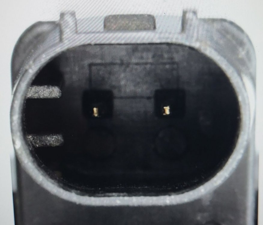

Jstrem75 Posted October 7, 2021 Author Report Share Posted October 7, 2021 On 10/4/2021 at 12:42 AM, enigma-2 said: I can see changing the control valve, but the other stuff? (bad humor) Expand I changed out the heater control valve but it's it's wrong part. The pigtail is a 2012, not a 2013. I disconnected it and I have heat now. Not sure the long term effects of having it unplugged until the right part comes in Quote Link to comment Share on other sites More sharing options...

erikgrad Posted October 19, 2021 Report Share Posted October 19, 2021 On 10/7/2021 at 3:41 AM, Jstrem75 said: I changed out the heater control valve but it's it's wrong part. The pigtail is a 2012, not a 2013. I disconnected it and I have heat now. Not sure the long term effects of having it unplugged until the right part comes in Expand I had a question, having the same problem. Did you unplug the bad control valve, and have heat working? Or did you install the new one with the wrong pigtail, and leave that one unplugged? In trying to troubleshoot, I unplugged my bad one, and maybe got a slight bump in warmth... but not much. Trying to determine whether I can actually troubleshoot whether it is the HCV simply by unplugging it? Quote Link to comment Share on other sites More sharing options...
Jstrem75 Posted October 20, 2021 Author Report Share Posted October 20, 2021 (edited) On 10/19/2021 at 2:01 PM, erikgrad said: I had a question, having the same problem. Did you unplug the bad control valve, and have heat working? Or did you install the new one with the wrong pigtail, and leave that one unplugged? In trying to troubleshoot, I unplugged my bad one, and maybe got a slight bump in warmth... but not much. Trying to determine whether I can actually troubleshoot whether it is the HCV simply by unplugging it? Expand I installed the new HCV with the wrong pigtail, and left it unplugged. The old HCV was closed and would not allow coolant to travel to the heater core. By default, the new HCV is open, so it allowed circulation. I decided to ignore the new part and engineer a waterproof connector. After doing so, I hard-wired the new pigtail, rubber-sealed it, and soldered/shrinkwrapped the wires. Works 100%! The long-term effects of having the HCV unplugged is constant coolant circulation into the heater core. It makes the cab a little warmer and can only causes issues if the heater core has a leak. It will also put a wrench on the display, but it doesn't hurt or have any negative effects on the engine. The 2012 HCV and the 2013 HCV have different plugs. If you buy an HCV, make sure you get the correct one. A hose clamp tool makes installation simple. It takes about 5-10 minutes after draining the radiator coolant. The attached photo is the 2012 HCV plug. THIS WILL NOT WORK ON A 2013. The 2013 has a smaller square connector. Edited October 20, 2021 by Jstrem75 1 Quote Link to comment Share on other sites More sharing options...
