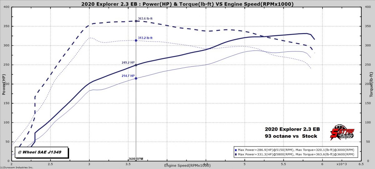

5-Star tune is on it's way for the 2.3. Gets close to the stock Edge ST crank numbers on 93 at the wheels.
