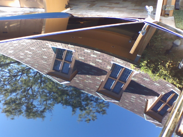

DJ Nap Posted November 22, 2008 Report Share Posted November 22, 2008 IF you want to do it right, get some wax stripper/degreaser and clean the entire vehicle including the windows. Follow that with a clay bar to remove anything embedded in the paint. Follow that with a hand polish (using clearcoat safe polishing compound) and seal that with a protectant (wax, polymer, etc.). For the polish I'd test it on a less noticeable area until you get the hang of it, and do it by hand. If your paint has lots of orange peel you can get rid of it by wet sanding, then polishing but I wouldn't recommend that unless you've done it before. But the results, especially on a black car, can be amazing. Like this Rolls that I maintain weekly. My advice above is for vehicles that are regularly maintained. You're right about the polish, you can f some paint up if you don't know what you're doing, but you'll still have spiderwebbing, unless you get a reaaaaal good detailer to buff it, like this guy here in town. He does amaaaaaaazing work. Check him out here..Never used a wool mit. The bottom of my bucket has a dirt/grit trap, so shaking my rag off in the bucket after every panel seems to work fine. Quote Link to comment Share on other sites More sharing options...
jeneedominique Posted November 22, 2008 Author Report Share Posted November 22, 2008 Like this Rolls that I maintain weekly. My advice above is for vehicles that are regularly maintained. You're right about the polish, you can f some paint up if you don't know what you're doing, but you'll still have spiderwebbing, unless you get a reaaaaal good detailer to buff it, like this guy here in town. He does amaaaaaaazing work. Check him out here..Never used a wool mit. The bottom of my bucket has a dirt/grit trap, so shaking my rag off in the bucket after every panel seems to work fine. see! why can't the get mie to look like that? eeerr! anyone know a good detailer in the socal desert area? between palm springs and indio? Quote Link to comment Share on other sites More sharing options...
